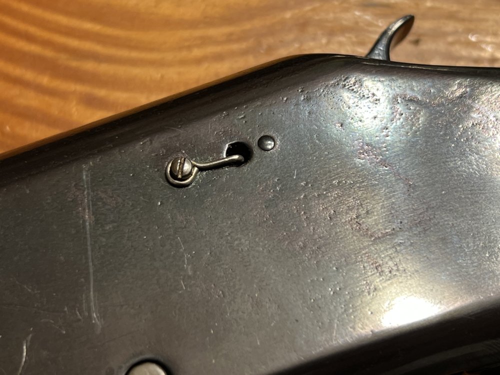

Here’s the kicker though. The 97 has a few problems. First off there is a screw with a wire/spring running into the hole in the receiver. My other 97 don’t have that and it looks to Jerry rigged. (see pics)
The bolt is loose in the receiver and it don’t cycle correctly. I’m hopeful I can figure it out and fix it. My biggest question is what could the screw and wire/spring be for ?
the photos wouldn’t add in the order I want but hopefully you can see what I’m talking about.
Looks like a homemade ejector.. VTI, and others will have the correct ejector.

Homemade ejector spring?
I’ve seen that type of ejector spring for the 97 elsewhere for sale. Wonder if anyone has any experience with the new design.
It don’t appear to catch anything but it could be that the bolt or something is out of time or out of line because it’s not functioning as of now. I haven’t got to take it apart yet.
I'm glad PWB chimed in about the wire ejector spring because I knew they were legal.   And rumor is that those wire ejector springs are
performing better and longer than the original flat metal ejector.
..........Widder
17 minutes ago, PaleWolf Brunelle, #2495L said:
The wire ejector spring is a recently APPROVED MODIFICATION for 1897 shotguns.
Thanks. That is exactly what it appears to be.

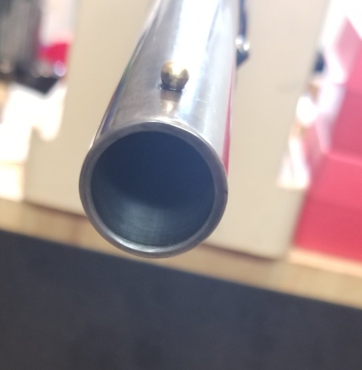

If you want a short barrel for CAS and don't want to cut your long one there are lots of short barrels available that you can fit to your receiver. Contact me and I will offer an explaination of the process, options, and an estimate. outlawgamber@gmail.com

I've chopped the barrel on my share of shotguns, and I've come across a pretty decent method that works for me. I'm like most gun guys, I fix my own if I can and have at least average mechanical skills. Although not fool proof, it seems to work without too much muss and fuss.
I used to use a hacksaw, but the challenge of that is getting a square cut, or making the cut square afterwards. The real way is to use a cutoff tool in a lathe. Those are tools of the above average DIY'r. What I do now is use a tubing cutter, just a medium duty hardware store cutter. It's made for copper pipe, but if you go slow, it will do several barrels. The advantage is a square cut. the downside is that there is a real nasty burr to deal with. I use a round ball stone in my drill to get the inside done, and a file to get the outside nice. Finish off with 320 > 400 emery, polish up with 800 > 1000.
An alternative would be to cut half way with the tubing cutter and finish with a hacksaw, les clean-up of the inside of the barrel.
I wrap about 2 layers of green masking for the wheels of the cutter to ride on. By going slow, the masking tape survives.
But before you start, there are a few very important things to do. First: determine where the cut should be. In Canada 18" is the minimum length for a "sawed off" if not a semi-auto. A semi needs to be 18.5".
A 1897 riot came with a 20" barrel. A bit longer will tighten the pattern slightly. I chose 20" on my last one. I then marked the cut line. With that decided, it's time for step two; to mark and center punch the location of the bead. Doing this with the original bead in place is a timesaver later. It beats trying to locate "center and inline" on a barrel with no reference. I have a small drill press and a drill vice where I drill and tap the hole, beats doing by hand.. I also use a large bead with 6-48 threads, for two reasons, the 6-48 thread is less tiddly and I like a large bead.
Handy kit, c/w 6-48 tap, a #31 drill and a couple of beads. If you think you'll be doing more than a couple buy a refill package of beads. They used to come in 10 packs, I'm on my second pack. An original Winchester bead is not a ball, it is a round brass peg, app 0.1" in dia. and sits about 0.08" proud of the barrel. The large bead is 0.175" in dia. and it sits about 0.150 proud of the barrel.
I use some fishing line, doubled up that I run from the front bead to the center of the notch on top of the receiver. I use Fireline as it pulls straight, is easy to see and doesn't stretch. I use a pin punch to mark the hole. I usually stay 1/2" back of the muzzle.
That's what left after the "chop".
That's what needs to be cleaned up.
And that is the finished job.
I didn't take pictures along the way, as I didn't know that a tutorial was in my future. For you sharp eyed cowboys, YES, the intact barrel is a 16 ga, and "NO", it did not get "chopped".
