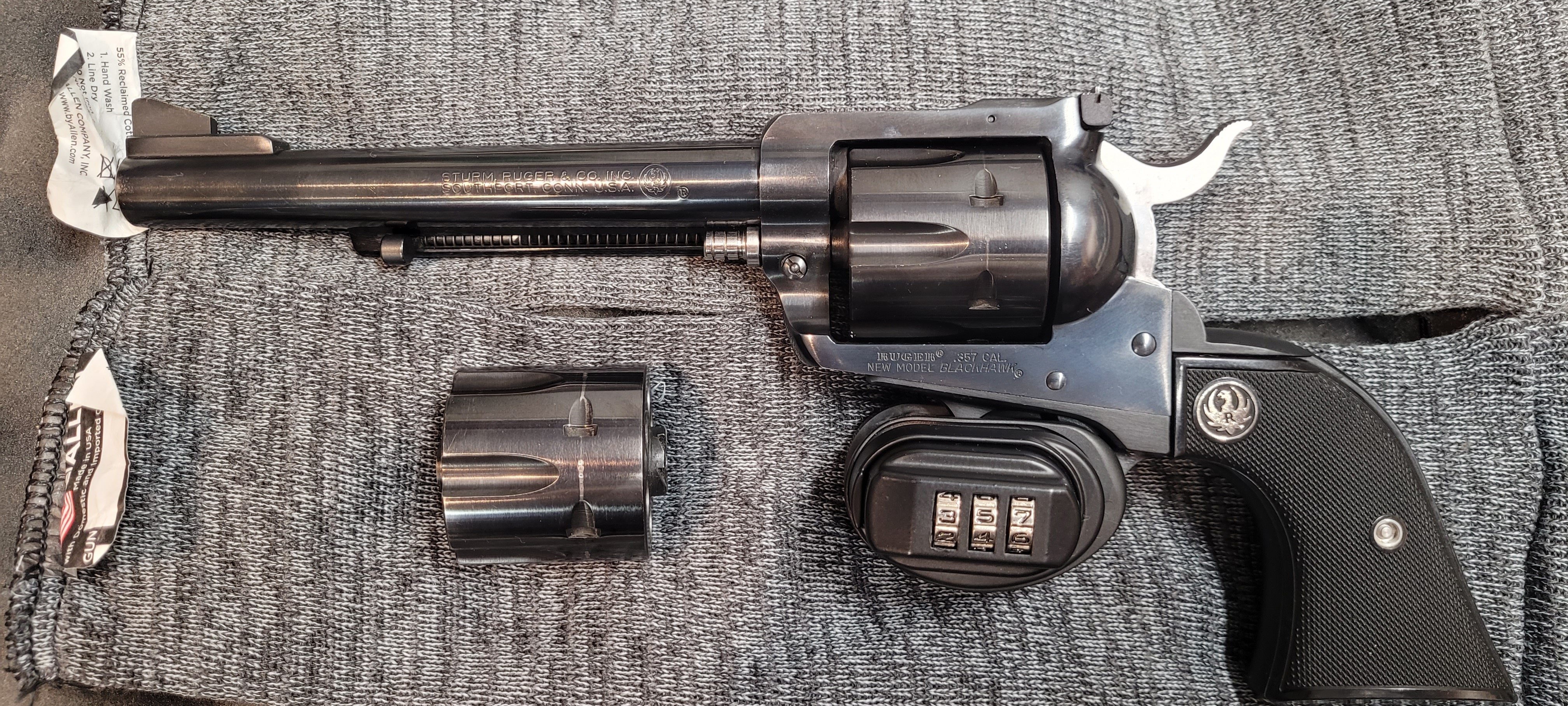

Frontier Lone Rider Posted December 23, 2021 Posted December 23, 2021 On 12/22/2021 at 9:24 AM, Ninety Caliber Al, 50218 said: Looking for feedback from any owners. I’ve decided to try and find a set. I just sold a Ruger Vaquero Special Edition to John Barleycorn at Barleycorn Outfitters. It was a Stainless-Steel OM Vaquero in 45LC and 45ACP which I had never fired.
