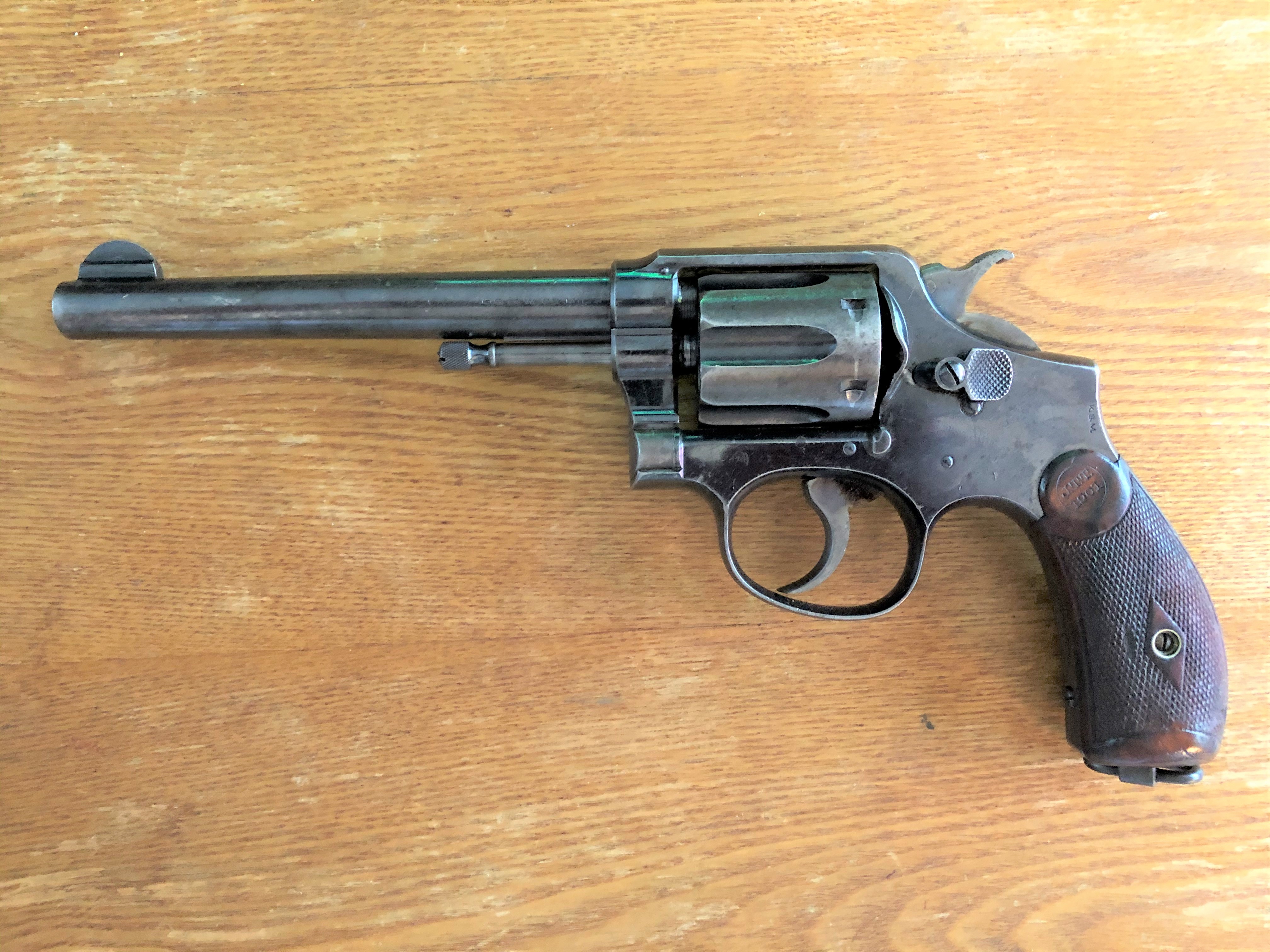

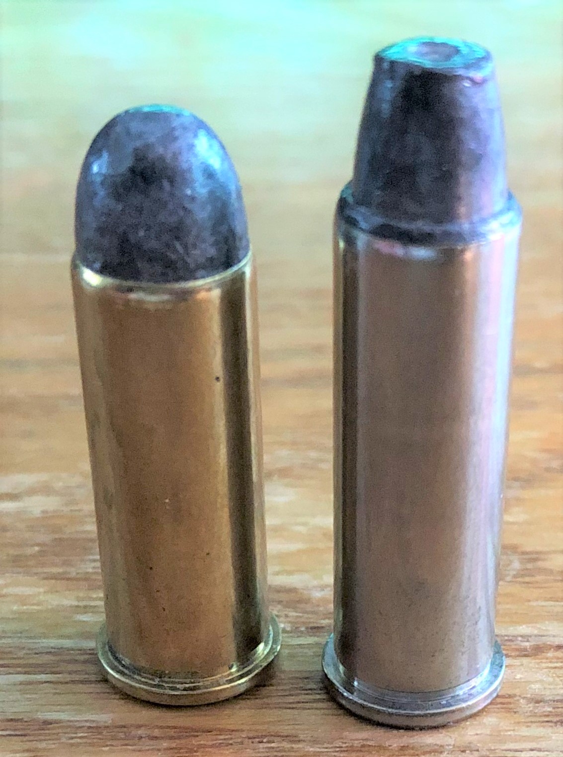

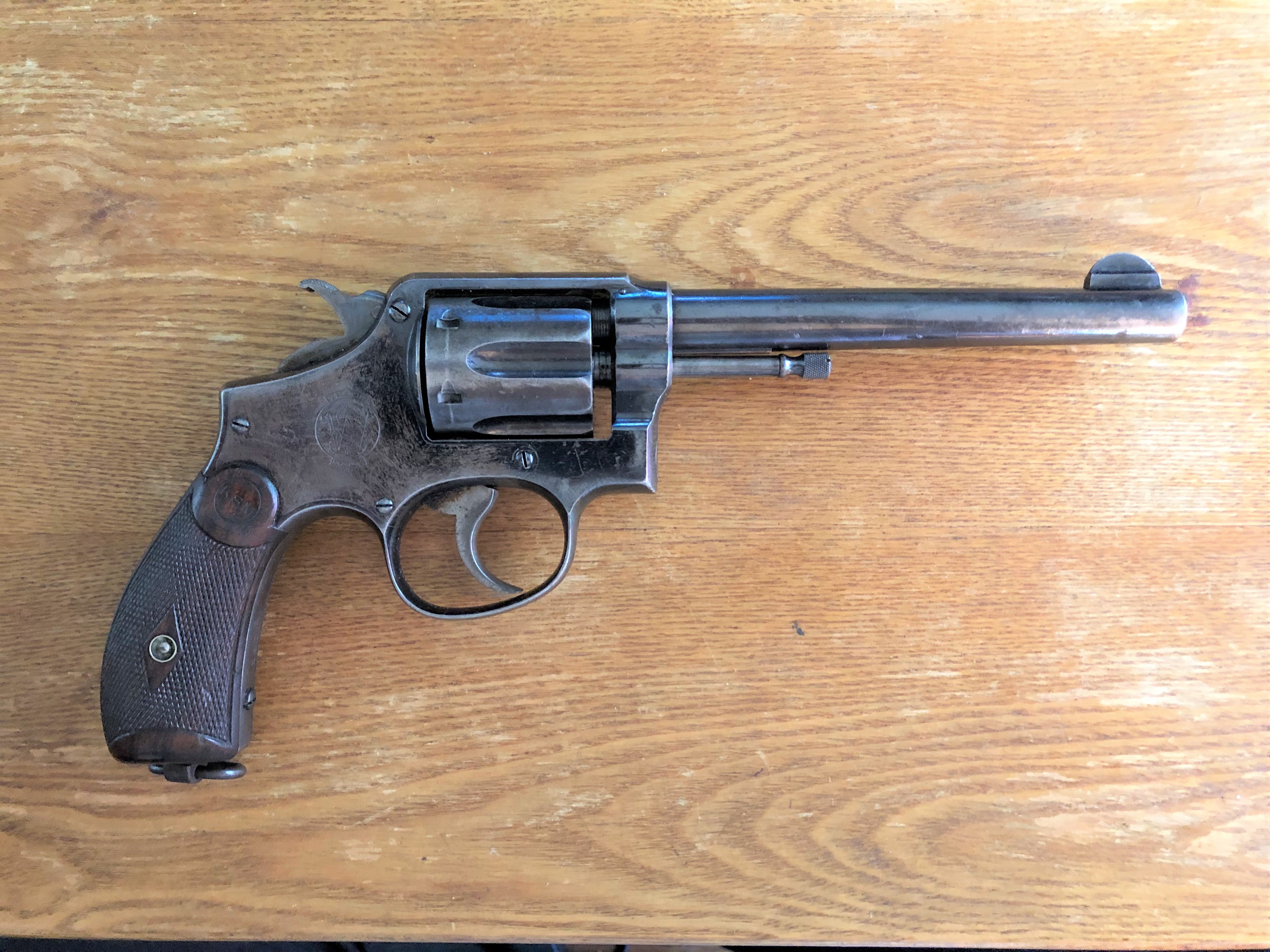

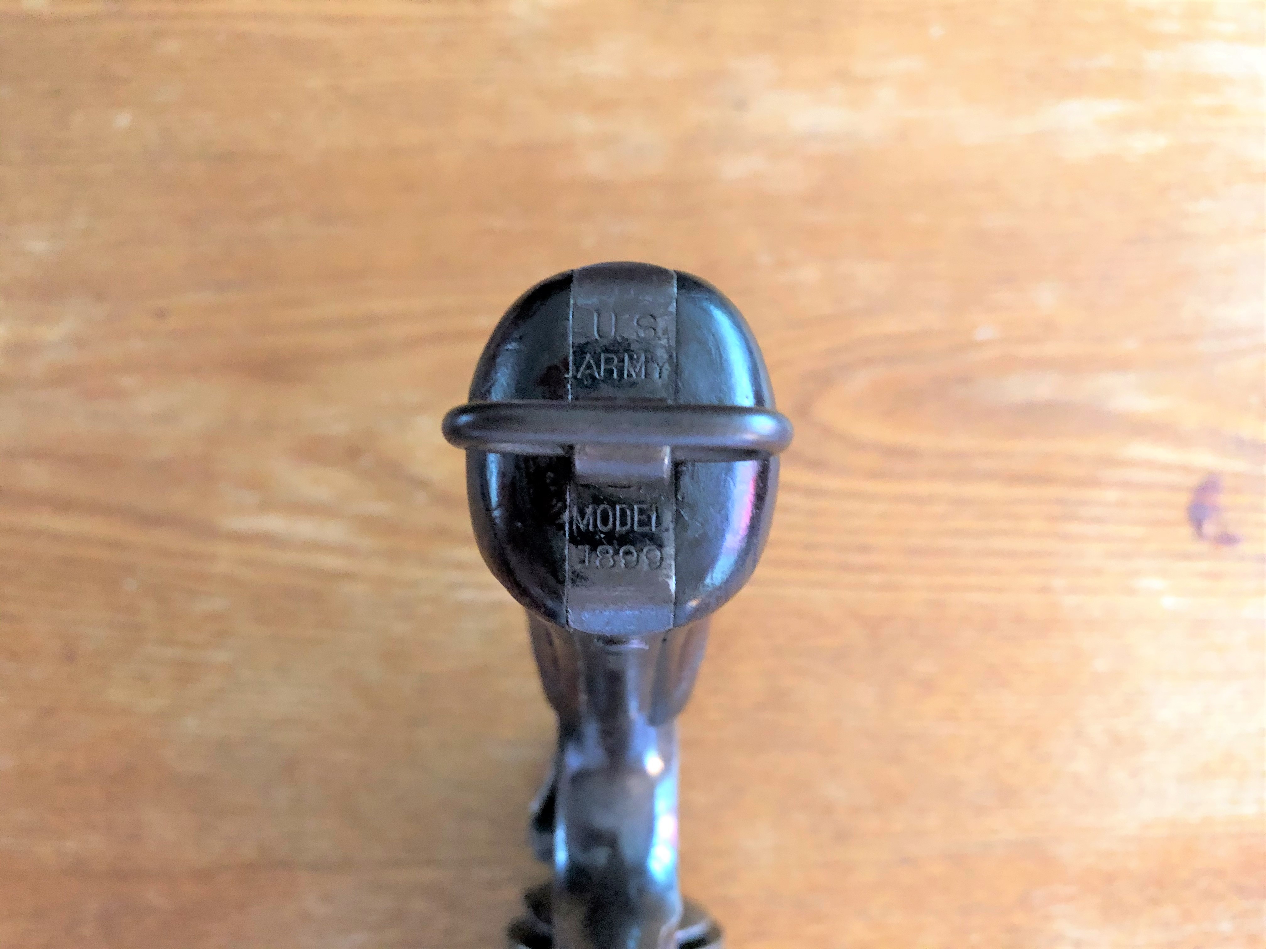

H. K. Uriah, SASS #74619 Posted September 12, 2021 Author Posted September 12, 2021 (edited) As always, Driftwood makes some excellent points, gives great pictures, and as often as not, prompts me to post some pics as well. Here is my S&W Model 1899. Left view Right View Let there be no doubt as to what model it is. Here's the caliber marking. S&W .38 MIL Now, here is where it gets interesting. Here's a pic of a .38 Long Colt on the left, and the .38 Special on the right. Obviously, the Special is quite a bit longer than the Colt round. Now, according to one book I have, the Army did buy 1000 of these pistols chambered for .38 Long Colt before the switch was made to .38 Special. According to the marking on the grips, this pistol was obtained in 1901. According to the person I bought it from, it's one of the 1000 in .38 Long Colt. So look at this... As you can see, the .38 Long Colt cartridge loads just fine, but the Special will not go all the way in. You can also see the JTT 1901 mark on the grip. So it seems that yes, there were some of these 1899's that were chambered for the Long Colt before they invented the .38 Special round. By the way, I also have one in .32-20, and a pair in .38 S&W. One is a pre-Victory model from Canada, and a Victory Model from Australia. Ones in .38 Special, which I don't yet have, were purchased in WWII, and remained in service until they, along with the 1911, were retired in the mid 1980's. This makes the S&W Model 1899/M&P/10 America's longest serving service pistol. Edited September 12, 2021 by H. K. Uriah, SASS #74619 2 Quote

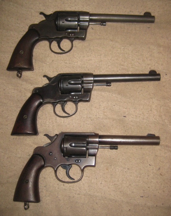

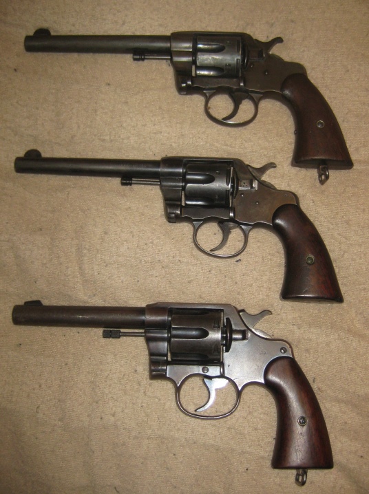

Cowtown Scout, SASS #53540 L Posted September 13, 2021 Posted September 13, 2021 Colt Revolvers - top two are .38 long colt and the bottom is 38-40. Quote
