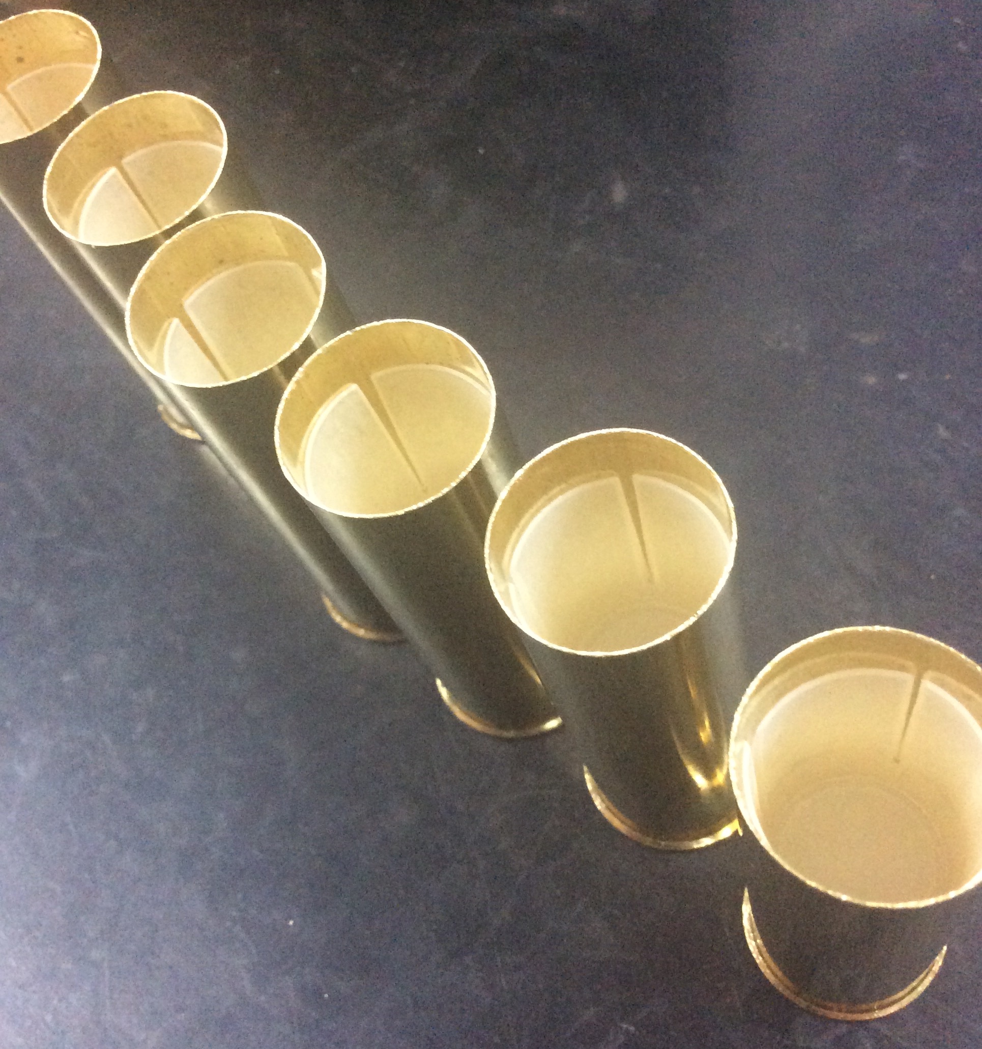

Marshall Matt Dillon Posted February 21, 2021 Author Posted February 21, 2021 If i use a 12ga plastic wad (all i have right now),,do i need to put a thick spacer under it, or will the thin over shot card be enough on top of the powder?
Warden Callaway Posted February 21, 2021 Posted February 21, 2021 1 hour ago, Marshall Dillon said: If i use a 12ga plastic wad (all i have right now),,do i need to put a thick spacer under it, or will the thin over shot card be enough on top of the powder? I just use the plastic wad on powder. You'll get 10 different answers. All will work. Just get on the bicycle and ride. Try some with some and some without.
Cholla Bob Posted February 21, 2021 Posted February 21, 2021 2 hours ago, Marshall Dillon said: If i use a 12ga plastic wad (all i have right now),,do i need to put a thick spacer under it, or will the thin over shot card be enough on top of the powder? No, unless you need it to get the correct column height for your load. Also you can get a good pattern with fiber wads you just have to adjust you powder to shot ratio. If you are getting blown out center of the pattern then either increase your shot or decrease your powder, I have had good luck with a little less powder by volume to shot ratio (square load(by volume)is the starting point for black powder shotshells) Like any hand load you have to find the one your gun likes best. I shoot a 7/8 oz load and the only time a knock doesn't go down it was the loose nut on the end of the stock that caused the problem.
Marshall Matt Dillon Posted February 21, 2021 Author Posted February 21, 2021 I thought since the 12ga plastic wad is smaller then the ID of the brass case, the powder might blow around it without that thick wad sealing the case under the plastic. My height would be better without the 1/8 inch thick wad. Right now i have to cut the petals 1/8 shorter on the plastic wad.
Warden Callaway Posted February 21, 2021 Posted February 21, 2021 25 minutes ago, Marshall Dillon said: I thought since the 12ga plastic wad is smaller then the ID of the brass case, the powder might blow around it without that thick wad sealing the case under the plastic. My height would be better without the 1/8 inch thick wad. Right now i have to cut the petals 1/8 shorter on the plastic wad. In brass hulls, I use 10 gauge plastic wads right on powder.

Marshall Matt Dillon Posted February 25, 2021 Author Posted February 25, 2021 I got 10ga wads thanks to Prairie Dawg! I got primed, put in powder, put in wad and compressed it a little. Now i have too much space to fill up with my 1 oz of shot, and need filler. Will it effect the pattern and make a nicer shell to put a spacer in the bottom of the cup, under the shot,,or better to put filler on top of the shot? I have white peanuts and 12ga fiber wads coming.
Abilene, SASS # 27489 Posted February 25, 2021 Posted February 25, 2021 There is really no need to fill up the brass hull to the top. My collection of brass hulls are various lengths, the longer ones have nearly a half inch of space at the end. A glued in overshot card does not care. If you are crimping the brass shell and using that crimp to hold in the overshot card, then that is different.
Marshall Matt Dillon Posted February 25, 2021 Author Posted February 25, 2021 9 minutes ago, Abilene, SASS # 27489 said: There is really no need to fill up the brass hull to the top. My collection of brass hulls are various lengths, the longer ones have nearly a half inch of space at the end. A glued in overshot card does not care. If you are crimping the brass shell and using that crimp to hold in the overshot card, then that is different. The 10ga wads i am using have a 1-5/8 shot cup. The one oz of shot would not reach the top of the plastic cup petals. The overshot card will set right on top of the plastic wad, so the shot needs to fill up the wad cup. That will still leave distance to end of the shell
Griff Posted February 25, 2021 Posted February 25, 2021 Just a suggestion... I've only used fiber wads with my brass hulls and plastic wads with my plastic hulls... but... I would cut the petals of the wads down to closely match my shot charge. Another step... but may result in better performance.
Abilene, SASS # 27489 Posted February 25, 2021 Posted February 25, 2021 27 minutes ago, Marshall Matt Dillon said: The 10ga wads i am using have a 1-5/8 shot cup. The one oz of shot would not reach the top of the plastic cup petals. The overshot card will set right on top of the plastic wad, so the shot needs to fill up the wad cup. That will still leave distance to end of the shell Gotcha. Trimming the petals would work but don't know how much time that would take. If you can find a good spacer putting it in the bottom of the cup below the shot should be fine also. I'm thinking if you put a spacer over the shot it might upset your pattern. That's why I just use the 12ga plastic wad with the nitro card underneath to seal. EZ PZ, works great.
Griff Posted February 25, 2021 Posted February 25, 2021 8 minutes ago, Griff said: Just a suggestion... I've only used fiber wads with my brass hulls and plastic wads with my plastic hulls... but... I would cut the petals of the wads down to closely match my shot charge. Another step... but may result in better performance. Forgot to mention... you could also use a smaller dimensioned fiber was and put it inside the plastic wad... to take up said space.
Warden Callaway Posted February 25, 2021 Posted February 25, 2021 If you watched my video, I stuff a packing peanut from U-haul on top. They are biodegradable and more like foam paper made from corn and bean oil. $5/bag last a long time. https://www.uhaul.com/MovingSupplies/Packing-Supplies/Biodegradable-Packing-Peanuts/?id=730
Marshall Matt Dillon Posted February 25, 2021 Author Posted February 25, 2021 12 minutes ago, Abilene, SASS # 27489 said: That's why I just use the 12ga plastic wad with the nitro card underneath to seal. EZ PZ, works great. Do you need to lube the nitro card? How thick is a nitro card?
Marshall Matt Dillon Posted February 25, 2021 Author Posted February 25, 2021 Just now, Warden Callaway said: If you watched my video, I stuff a parking peanut from U-haul on top. They are biodegradable and more like foam paper made from corn and bean oil. $5/bag last a long time. Yes, that is why i have the white peanuts coming, to try that. Do they try to expand and push the overcard out before the glue dries?
Warden Callaway Posted February 25, 2021 Posted February 25, 2021 8 minutes ago, Marshall Matt Dillon said: Yes, that is why i have the white peanuts coming, to try that. Do they try to expand and push the overcard out before the glue dries? No. There are U-Haul places almost as common as McDonald's. Just drop in and buy some. I got mine at a Mennonite county store that is also a U-Haul station.

Tequila Shooter Posted February 25, 2021 Posted February 25, 2021 1 hour ago, Marshall Matt Dillon said: Do you need to lube the nitro card? How thick is a nitro card? Do not lube the Nitro Card. No lube is needed for SG rounds, BP, BP Sub, or that other smokeless stuff.
Tequila Shooter Posted February 25, 2021 Posted February 25, 2021 Marshall, with brass shells don’t worry about how much of the shell is above the overshot card. With a star crimp on a plastic hull the column height is very important to get a good crimp, since there’s no star crimp on brass it’s not important. As others have said I’ve got shells that are different lengths, some with a straight end some with a rolled end and none of it matters. The only difference with each of them is how they feel when you load them in the barrels, they all shoot the same.
Abilene, SASS # 27489 Posted February 25, 2021 Posted February 25, 2021 The Nitro cards I use are 1/8" 11ga and are hard. No lube. I got mine from Circle Fly long ago, not even sure if they are still around. I think the wife kept it going for a while after her husband died. I've never needed any lube in any BP shotshells. Plastic and fouling clean easily with any of the methods folks use. Now, older or cheap shotguns with less smooth bores, maybe lube will help, I dunno.
