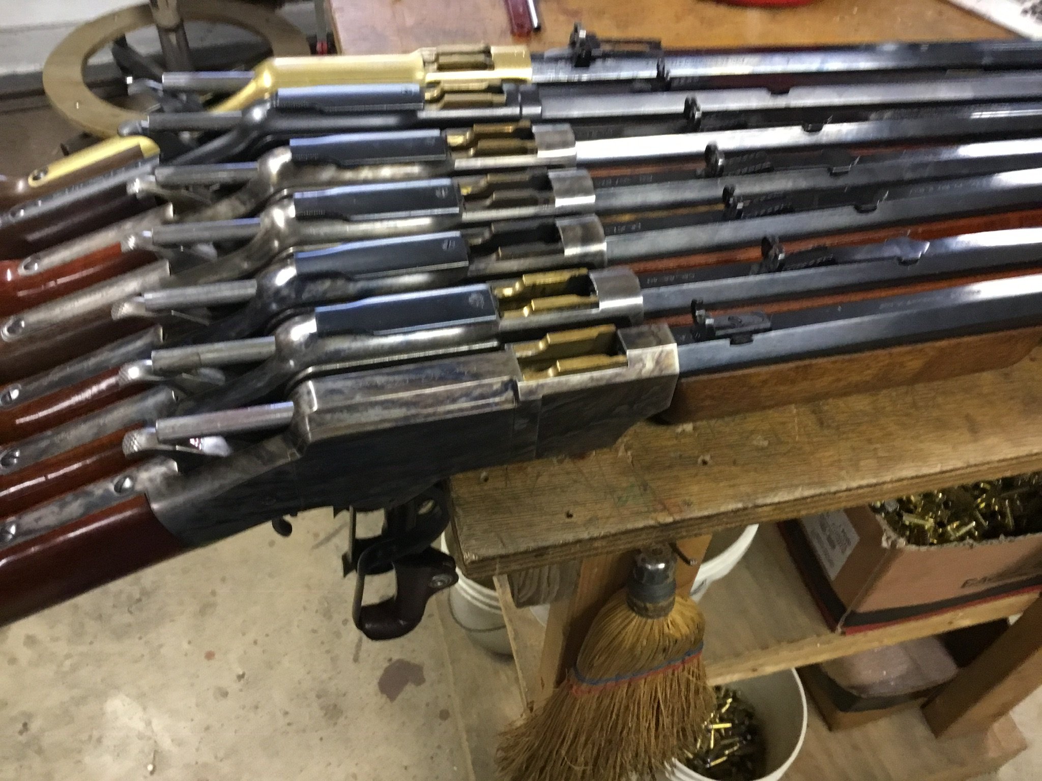

Cypress Sam, SASS #10915 Posted June 12, 2019 Posted June 12, 2019 The one on the bottom is my “Super Henry”. It has been short-stroked and some other internal mods along with the home-made forend (which only slides over the magazine and is not attached with screws). I call it my “full-race” Henry.5

Bullett Sass 19707 Posted June 13, 2019 Posted June 13, 2019 6 hours ago, Cypress Sam, SASS #10915 said: The one on the bottom is my “Super Henry”. It has been short-stroked and some other internal mods along with the home-made forend (which only slides over the magazine and is not attached with screws). I call it my “full-race” Henry.5 How does the follower go through the forearm when shooting? Thanks Bullett 19707

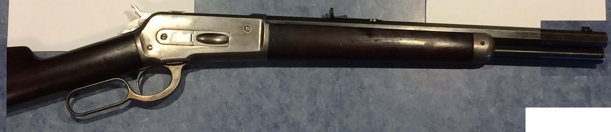

H. K. Uriah, SASS #74619 Posted June 13, 2019 Author Posted June 13, 2019 2 hours ago, Nimble Fingers SASS# 25439 said: Would a short barreled 86 be an actual Mares Leg? Could you imagine actually having a gun that could load the bullets from his belt? Now that would be a special order fro Uberti! You mean... Obviously not real, but with some cutting and pasting, this is what an 86 Mare's Leg would look like. There is an 18" 86 on the market, I think Chiappa. All you'd have to do is cut the shoulder stock and get the lever modified.
Cypress Sam, SASS #10915 Posted June 13, 2019 Posted June 13, 2019 22 hours ago, Bullett Sass 19707 said: How does the follower go through the forearm when shooting? Thanks Bullett 19707 I use a wood dowel as a spacer to go on top of the 10 rounds in the mag tube. I milled a slot in the forend to allow the Henry follower to go into the forend enough to let the dowel to pusher the cartridges onto the lifter. We are at the beach right now, but when I get back home next week I’ll take some more detailed pictures and post them for those who might be interested.
Abilene Slim SASS 81783 Posted June 13, 2019 Posted June 13, 2019 9 minutes ago, Cypress Sam, SASS #10915 said: I use a wood dowel as a spacer to go on top of the 10 rounds in the mag tube. I milled a slot in the forend to allow the Henry follower to go into the forend enough to let the dowel to pusher the cartridges onto the lifter. We are at the beach right now, but when I get back home next week I’ll take some more detailed pictures and post them for those who might be interested. I’m interested and looking forward to your post. I use a dowel as well that allows me to avoid the “Henry hop”. I’ve often wondered about a slip on fore end.
Hoss Posted June 14, 2019 Posted June 14, 2019 16 hours ago, Cypress Sam, SASS #10915 said: I use a wood dowel as a spacer to go on top of the 10 rounds in the mag tube. I milled a slot in the forend to allow the Henry follower to go into the forend enough to let the dowel to pusher the cartridges onto the lifter. We are at the beach right now, but when I get back home next week I’ll take some more detailed pictures and post them for those who might be interested. I wonder if that would be an allowed modification? I like shooting my Henry every once in a while, but hate the Henry Hop. I use a dowel, but have to hold the rifle just in front of the receiver, which reduces accuracy. Looking forward to pictures!
Abilene Slim SASS 81783 Posted June 14, 2019 Posted June 14, 2019 58 minutes ago, Hoss said: I wonder if that would be an allowed modification? I like shooting my Henry every once in a while, but hate the Henry Hop. I use a dowel, but have to hold the rifle just in front of the receiver, which reduces accuracy. Looking forward to pictures! I'm guessing it's not because the gun wasn't offered with one back in the day. I've been wrong before, though.
Nimble Fingers SASS# 25439 Posted June 14, 2019 Posted June 14, 2019 On 6/12/2019 at 11:30 PM, H. K. Uriah, SASS #74619 said: You mean... Obviously not real, but with some cutting and pasting, this is what an 86 Mare's Leg would look like. There is an 18" 86 on the market, I think Chiappa. All you'd have to do is cut the shoulder stock and get the lever modified. Much shorter barrel like on Steve’s version of a Mares Leg. On the 92 he customized.
Charlie MacNeil, SASS #48580 Posted June 17, 2019 Posted June 17, 2019 On 6/14/2019 at 8:31 AM, Hoss said: I wonder if that would be an allowed modification? I like shooting my Henry every once in a while, but hate the Henry Hop. I use a dowel, but have to hold the rifle just in front of the receiver, which reduces accuracy. Looking forward to pictures! Would that actually be considered a modification? I'm not being sarcastic, I honestly would like to know!
Cypress Sam, SASS #10915 Posted June 17, 2019 Posted June 17, 2019 From The Shooters Handbook: Stocks and Grips - The length or style of stock may be altered or replaced I don’t think there would any problem, particularly since transitional Henry’s had forends and it appears to me that it falls under altering the length and style of stock as permitted in the SHB.
