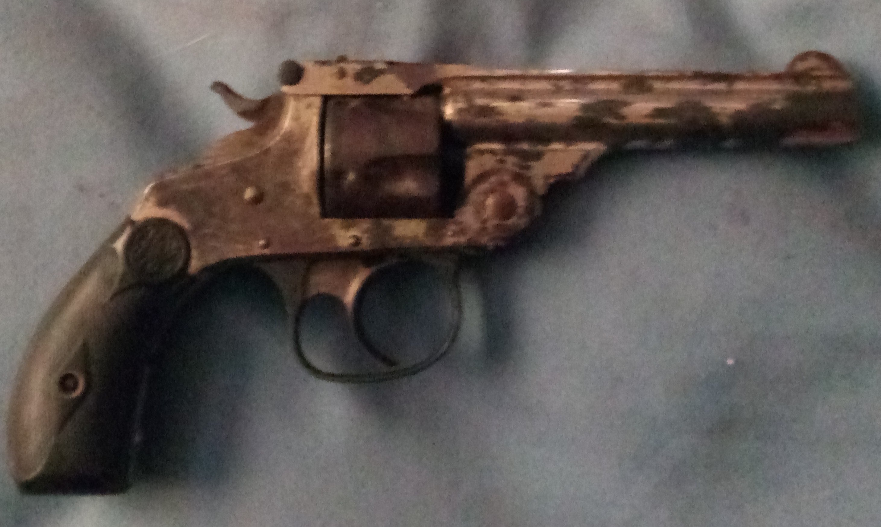

Birdgun Quail, SASS #63663 Posted January 16, 2019 Posted January 16, 2019 J. Mark, thanks for the report. I have a local fellow who is my FFL contact and he can do minor gunsmithing jobs. But I don't have the name a major gunsmith. I'll keep Frank Glenn in mind. You didn't post any pictures of your New Service revolver. We want to see pictures! It's not real to us until you post pictures! WE WANT PICTURES OF YOUR REVOLVER---NOW!!! Can I get an AMEN from the rest of the Saloon? J. Mark, here's a S&W revolver I got from Papa Dave a few years ago. See I can post pictures! S&W 4th Model "Pocket Gun" in .32 S&W
Alpo Posted January 16, 2019 Posted January 16, 2019 Hey Birdgun. That's lots purtier than my DA32. Wanna trade?

Birdgun Quail, SASS #63663 Posted January 16, 2019 Posted January 16, 2019 Oh, Good Grief, Alpo. No. I don't think I'll trade. But, Papa Dave told me my DA32 had been refinished. Can you tell??? .

Utah Bob #35998 Posted January 16, 2019 Posted January 16, 2019 1 hour ago, Birdgun Quail, SASS #63663 said: Oh, Good Grief, Alpo. No. I don't think I'll trade. But, Papa Dave told me my DA32 had been refinished. Can you tell??? . Yeah it looks better than it did right out of the factory. Beautiful.
Shotgun Clay Posted January 16, 2019 Posted January 16, 2019 2 hours ago, Birdgun Quail, SASS #63663 said: Oh, Good Grief, Alpo. No. I don't think I'll trade. But, Papa Dave told me my DA32 had been refinished. Can you tell??? . There looks to be a little bit of "dishing" around the screw heads. So it might be. If Smith & Wesson did the work there should be a star stamped on the grip frame near the serial number. Anyway here is a New Service of mine, .45 Colt with factor ivories. It's a huge gun.
Alpo Posted January 16, 2019 Posted January 16, 2019 3 hours ago, Birdgun Quail, SASS #63663 said: Can you tell??? I suspected. Trigger, guard and hammer should be color casehardened, not blued.

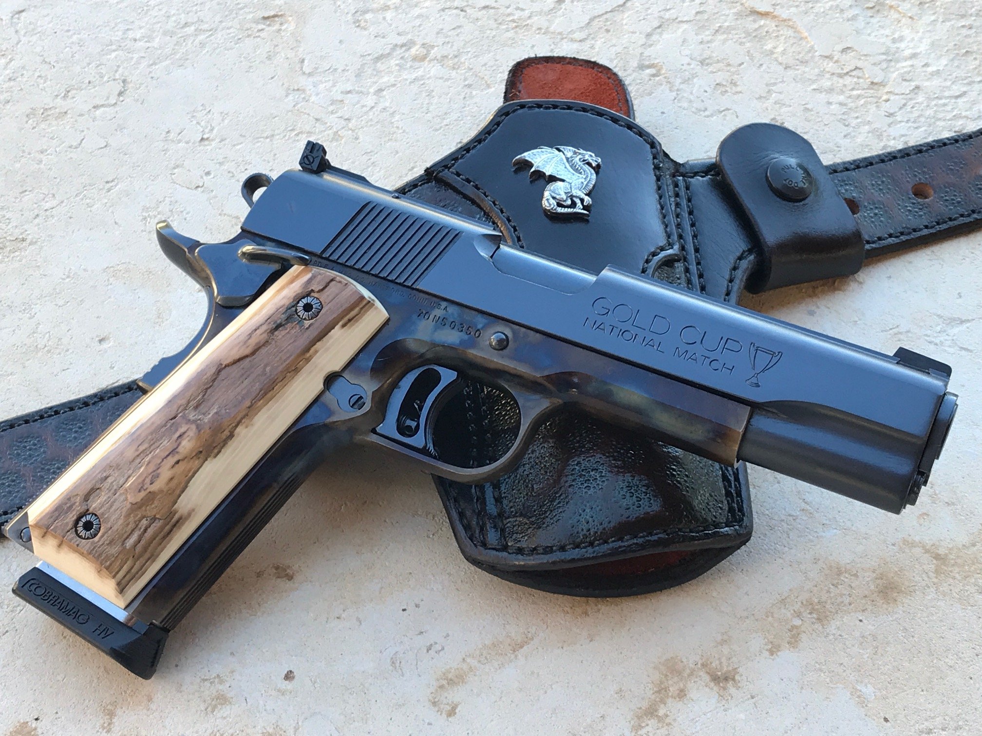

Adolph Vancinghand, SASS #28923 Posted January 19, 2019 Posted January 19, 2019 I'd happily recommend Frank Glenn as well; he rebuilt my tired, rattly old 70's vintage Gold Cup a few years back. With some CCH magic by Turnbull restoration and mammoth ivory panels, this has become my official barbeque gun. But don't let the looks confuse you: Frank built this gal to shoot...and she does! "Ad"
J. Mark Flint #31954 LIFE Posted January 19, 2019 Author Posted January 19, 2019 Pretty gun! Glad to get another voice speaking up for Mr. Glenn. He made my day with his free advice, even knowing I was ready to ship the gun to him for a full action job
