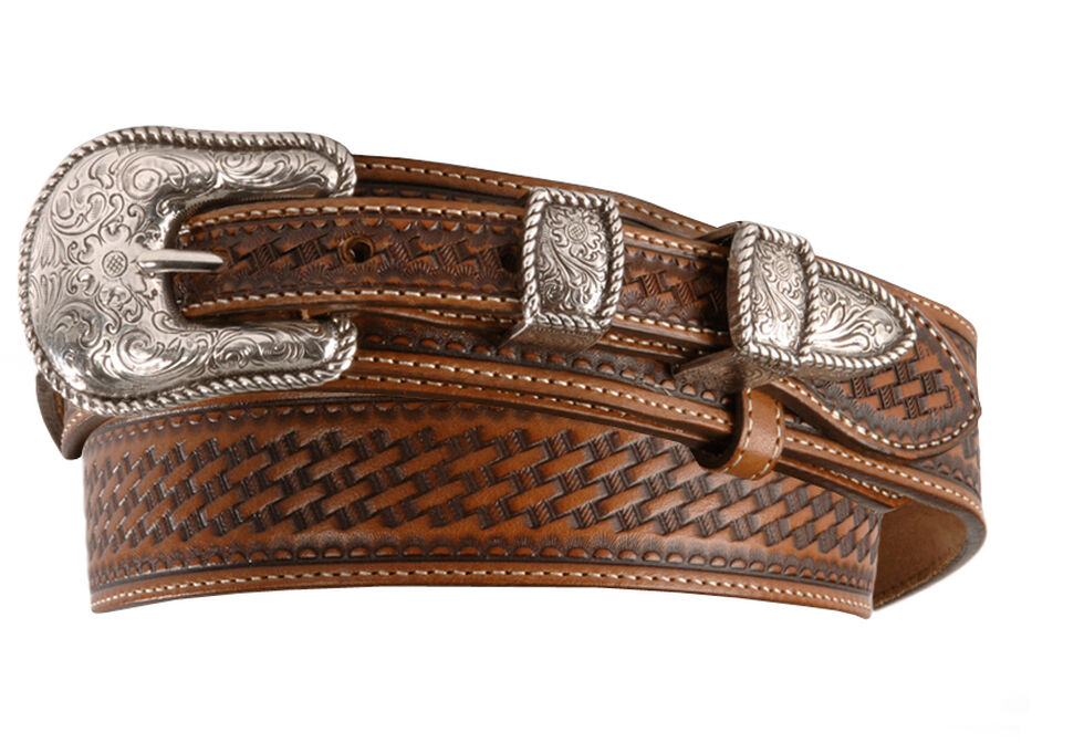

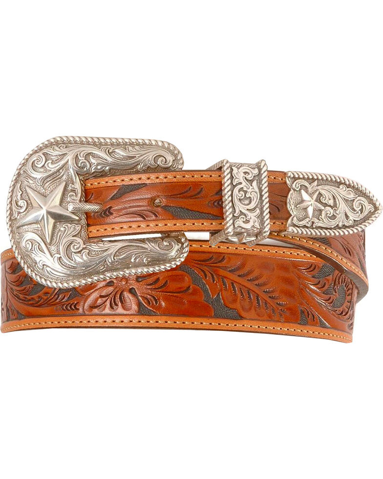

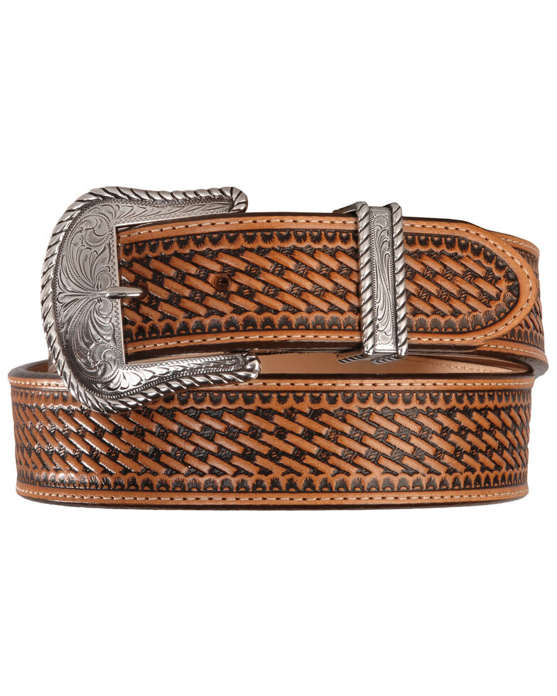

Red Cent Posted August 17, 2018 Posted August 17, 2018 The first two are not mine. I did the third one.
