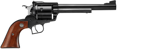

Fillmore Coffins, SASS #7884 Posted February 10, 2015 Posted February 10, 2015 Here are some pics from the Ruger catalog. The top photo is a Blackhawk, the bottom photo is a Super Blackhawk. Fillmore
Most Wanted Posted February 10, 2015 Posted February 10, 2015 Fillmore Isn't that a Blackhawk and a bisely?
Aunt Jen Posted February 10, 2015 Author Posted February 10, 2015 Congrats! I thought you'd like them. You did well, it took me much longer and a replacement spring from Ruger to do mine. Griz! Your humor is always so subtle and self-deprecating. That's charming. Thank you for kind words.
Aunt Jen Posted February 10, 2015 Author Posted February 10, 2015 In looking at the Ruger site that 2nd one http://www.ruger.com/products/newModelSuperBlackhawkBisleyHunter/models.html appears to be a Bisley Hunter Super Blackhawk. The standard Super Blackhawk is http://www.ruger.com/products/newModelSuperBlackhawkStandard/models.html which does look like the hammer I put in.
Elk Creek LeMieux Posted February 10, 2015 Posted February 10, 2015 Yeah, that's a super blackhawk. Although, now that I'm looking at the bisley super blackhawk... I want one.
Fillmore Coffins, SASS #7884 Posted February 10, 2015 Posted February 10, 2015 Isn't that a Blackhawk and a bisely? Ha Ha , you're right. I was so excited I could post an actual pic instead of a link, I screwed up. Fillmore
Fillmore Coffins, SASS #7884 Posted February 10, 2015 Posted February 10, 2015 Yeah, that's a super blackhawk. Although, now that I'm looking at the bisley super blackhawk... I want one. That's EXACTLY what I was thinking. FC
