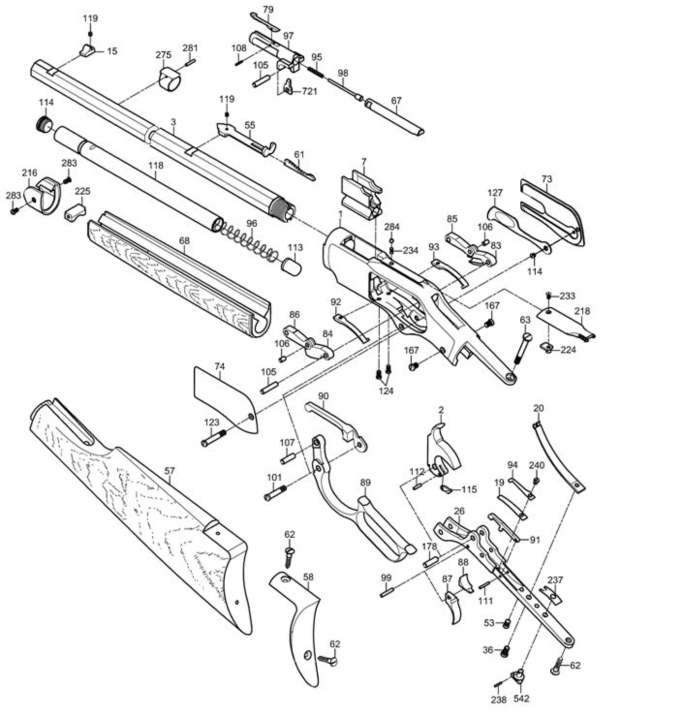

Tex Jones, SASS 2263 Posted May 8, 2024 Posted May 8, 2024 Many '73s have had the lever safety removed when they were being tuned in the belief that the rifle can be made to fire more quickly. Others have had the spring on the safety lightened enough so that the rife can function easily enough with the part still in place. There are parts available on the VTI Gun Parts website (under Uberti 1873 rifles , Items 91 and 94 on the schematic). As Blackwater mentioned any competent gunsmith should be able to fit the parts or, perhaps one of your fellow shooters can help. The only way to know for sure is to take the stock off and look to see if there has been any alteration to the lower tang. Usually the parts drop in and the spring can be modified a bit so that the safety functions easily without having to eliminate it.

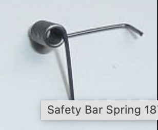

Gateway Kid SASS# 70038 Life Posted May 8, 2024 Posted May 8, 2024 Depends on what was actually done, but the 73’ lever safety is pretty easy to replace. The factory flat spring might need a little “tweaking” to get it nice and light or you can get an aftermarket coiled spring (about $8) from Long Hunters supply. I have switched all of my own springs to the coil version BTW. A bit more disassembly than a cleaning but I never actually was shown how to do it and I still got it done. Regards Gateway Kid

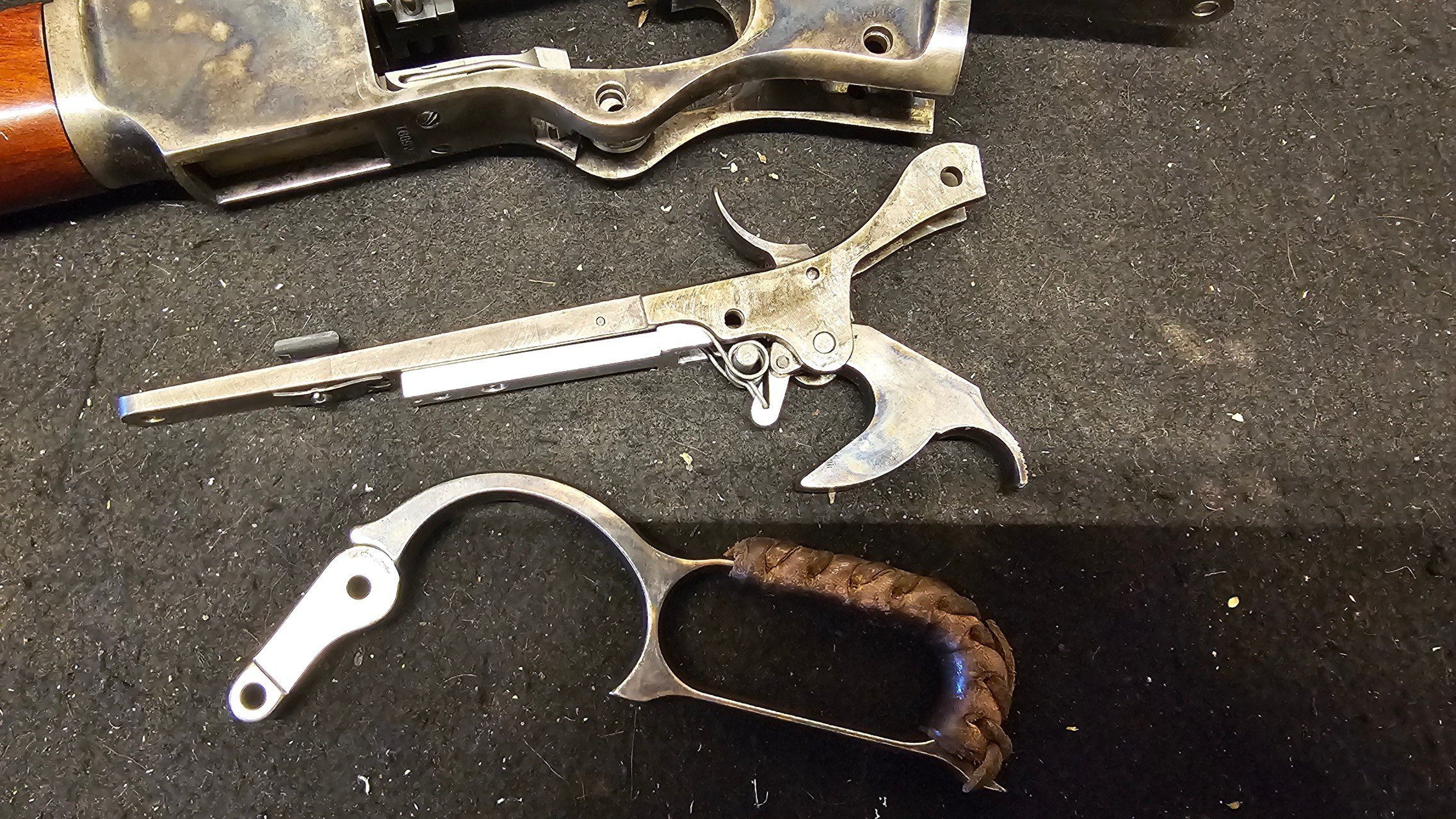

Dred Bob Posted May 8, 2024 Author Posted May 8, 2024 pictures of the lever and lower tang. If I can figure out if original parts will work I'd like to try that before sending it out somewhere. If so, what parts are needed.

McCandless Posted May 8, 2024 Posted May 8, 2024 21 minutes ago, Dred Bob said: I haven't seen this particular coil spring mod before. I'm familiar with Pioneer's and Boogie's, this isn't them. Just curious, does anyone know who does this one? Looks sort of like a mousetrap arrangement.

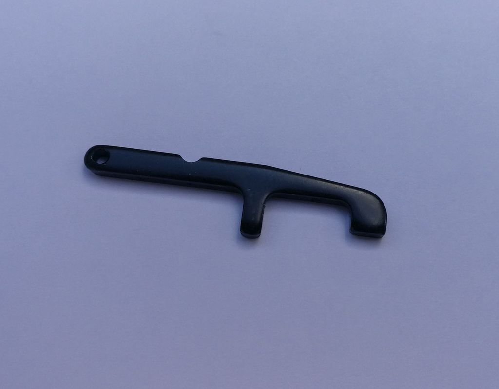

Larsen E. Pettifogger, SASS #32933 Posted May 8, 2024 Posted May 8, 2024 Model 66s have a one piece trigger so the lever safety will not work with them. (Some of the OLD Navy arms 66s had a two piece trigger and lever safety.) 73s have a two piece trigger to accomdate the lever safety. (Some of the first original Winchester 73s did not have the safety.) Some 73 tuners weld up the trigger to make it a one piece. First thing to do is simply cock the hammer and see if there is some fore and aft wiggle in the trigger. If there is putting the safety back in is easy. If the trigger has been welded you will need to buy new two piece parts. From your photo it looks like the safety lever pin is still in the gun. Green arrow. All that is needed is the safety lever and the safety lever spring. The safety seldom if ever needs fitting. A chimp working for peanuts can do the job. Your mainspring (and answer to McCanless question) is a SLIX. You will have to remove it as the safety goes underneath it. I would not buy a flat leaf style safety spring. The newer Uberti's use a coil and there are several aftermarket coil safety spring.
Larsen E. Pettifogger, SASS #32933 Posted May 8, 2024 Posted May 8, 2024 Here is a schematic from VTI. You need part #91. Part #94 is the old style leaf spring. You DO NOT want that. VTI does not show the newer coil style on this diagram. Part #111 is the pin the green arrow is pointing to. Sometimes the lever might have to be modified slightly for the coil spring. Shotgun Boogie, for example, sells the lever already modified for his coil spring. Safety-Bar-Spring-1873-Uberti 2.jpg.webloc
Tex Jones, SASS 2263 Posted May 8, 2024 Posted May 8, 2024 VTI now lists part # 94 as the new style coil spring with instructions.

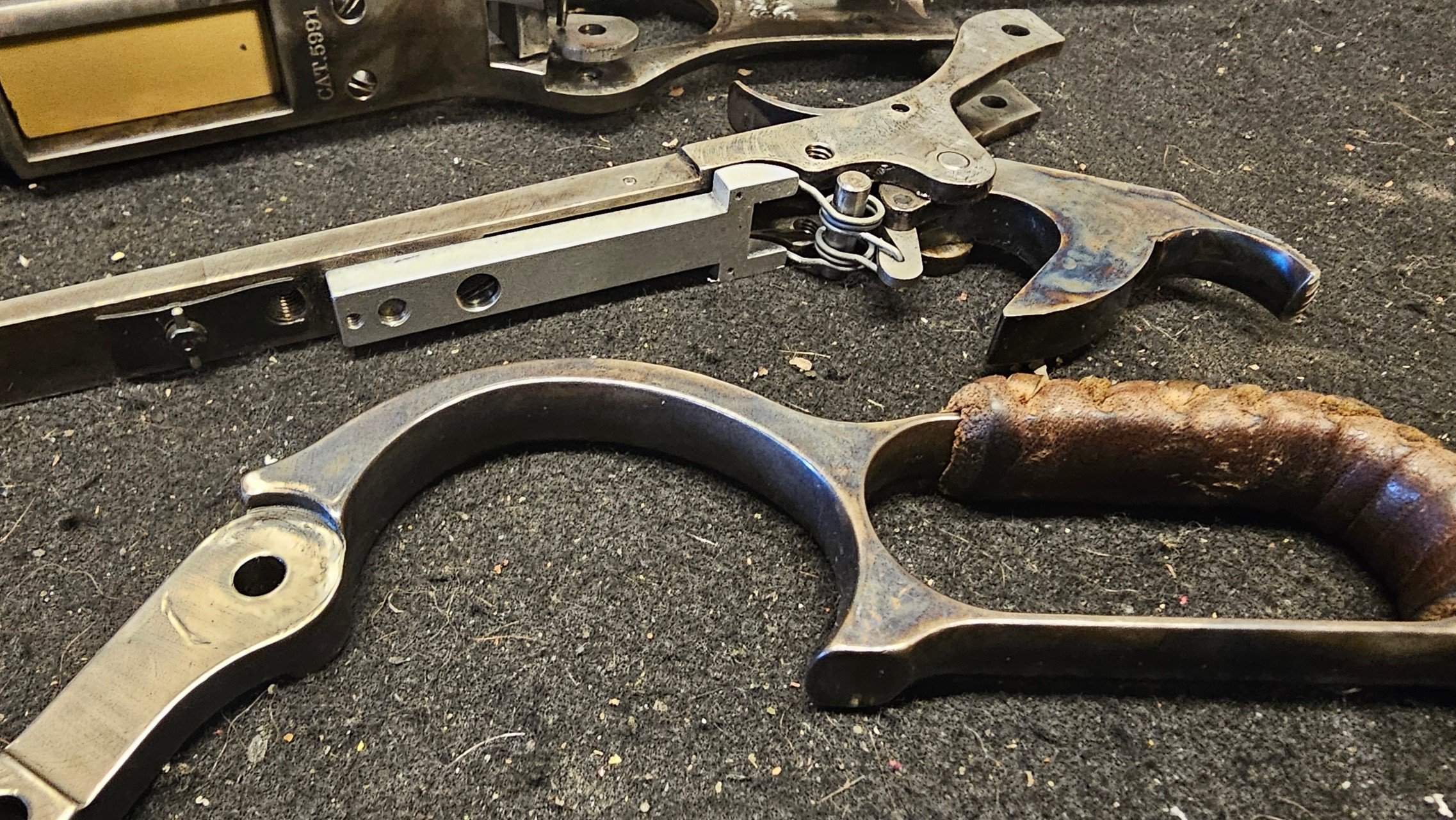

Dred Bob Posted May 8, 2024 Author Posted May 8, 2024 3 hours ago, Larsen E. Pettifogger, SASS #32933 said: A chimp working for peanuts can do the job. That's what I was hoping for! I *might* be qualified but not guaranteed. I'm willing to try 3 hours ago, Larsen E. Pettifogger, SASS #32933 said: You will have to remove it as the safety goes underneath it. I would not buy a flat leaf style safety spring. remove it just to install the safety lever and spring? or remove it and replace it with a different system?

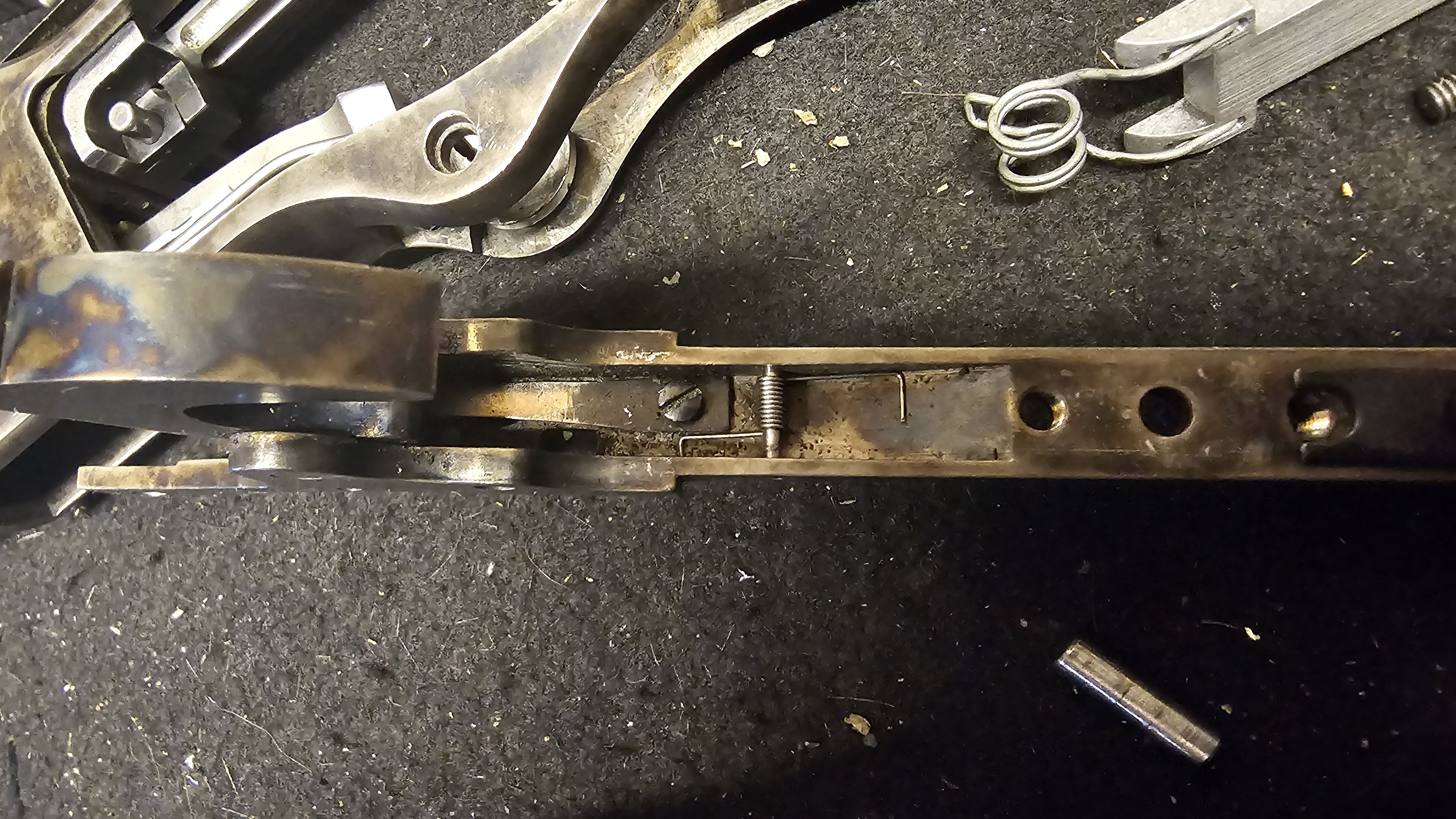

Dred Bob Posted May 8, 2024 Author Posted May 8, 2024 3 hours ago, Larsen E. Pettifogger, SASS #32933 said: Part #111 is the pin the green arrow is pointing to I removed the Slix hammer spring assy. This is what is underneath. The pin you you identified has a small spring on it doing nothing. So it looks like I just need the safety bar from Boogie and install it on that pin with the spring tensioned on top.
Larsen E. Pettifogger, SASS #32933 Posted May 8, 2024 Posted May 8, 2024 Yep, all you need is the safety bar itslf. The short leg that is facing forward sits on top of the safety bar.
