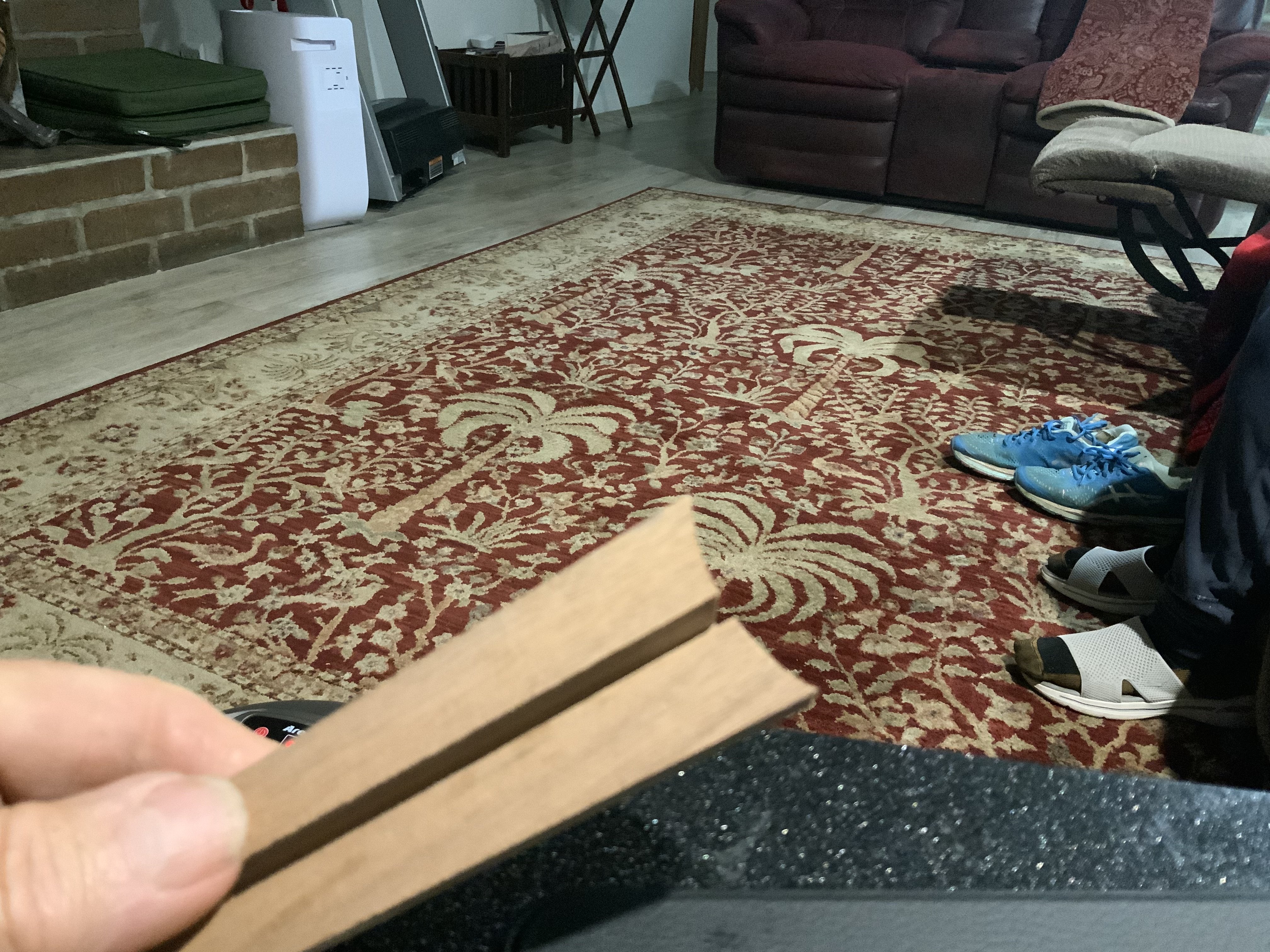

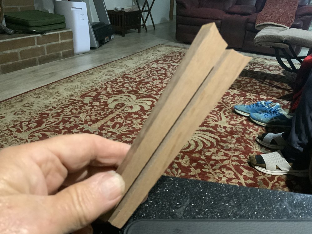

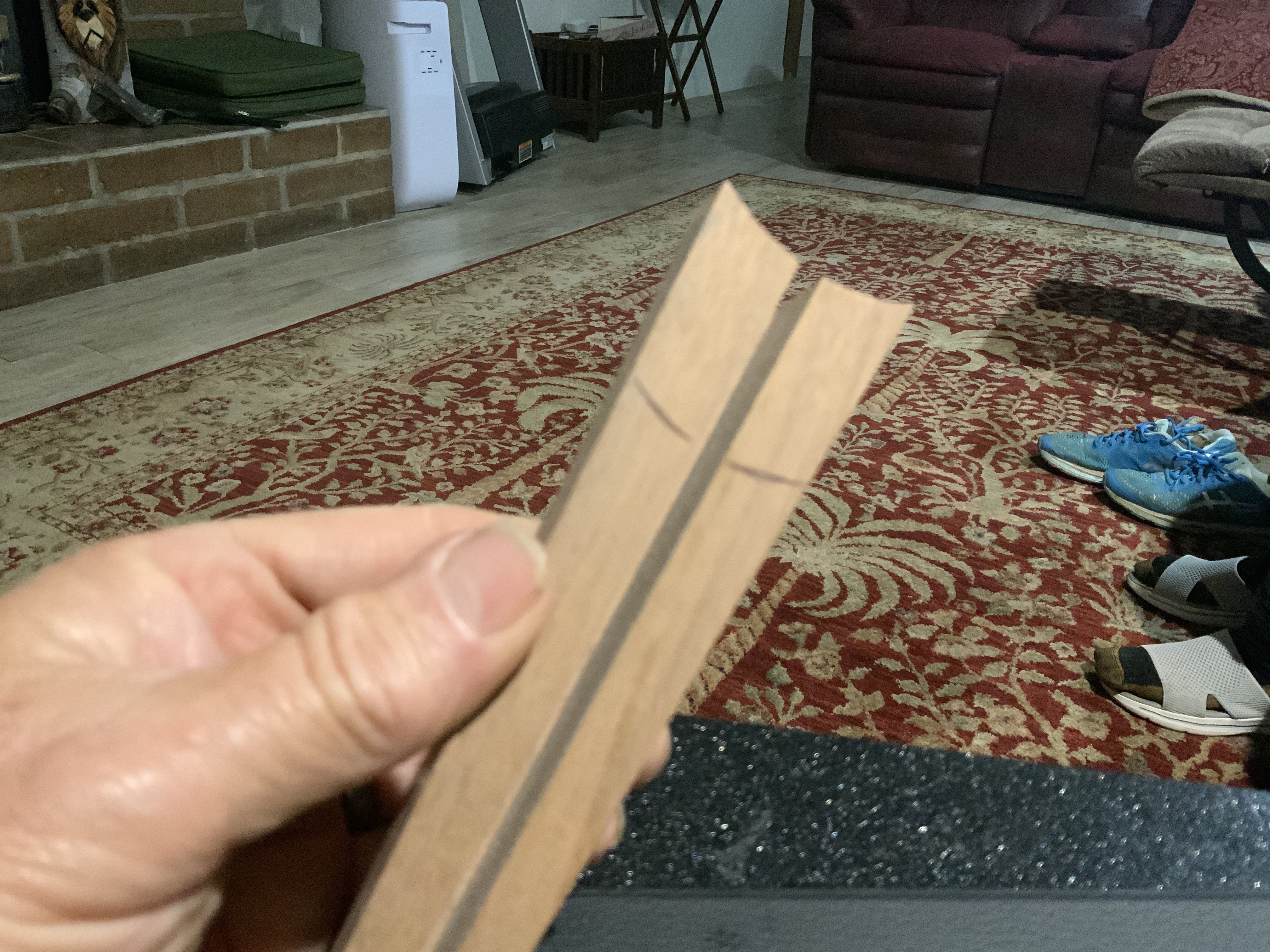

Thank you. What size wheels and tires are on that cart? I might have spokes already made up for it, they look like the older style of wheel that I used. Let me know.

Rats, those are 16” wheels. The spokes that I have made up are for 20” wheels. I might have a 16” wheel like that around and I’ll see what it would take to make those spokes fit.
Well I remembered as I was looking for the 16” wheels that I gave them to a new shooter who was building a cart, but I do remember that the hub was the same size as the 20” wheel. All you’d have to do to the spokes that I have built is shorten them on the hub end by a couple of inches. The easiest way would be to buy a Forstner bit that diameter and then build a fixture for your drill press that will hold the spoke correctly and safely while you cut out the hub cove. The rest of the spoke should fit the 16” wheel, I remember doing this a few years ago for a cart that I built.
