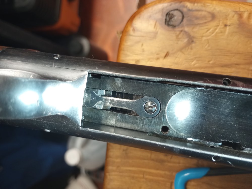

Hells Comin Posted January 22, 2023 Posted January 22, 2023 On 1/20/2023 at 2:18 PM, Texas Jack Black said: I have seen the main spring screw located in the front of the carrier removed .Why is this done I call that screw the poor man's action job. Back it out until it doesn't set off your primers then screw it in a half turn. You will be amazed how much smoother the action will be. Some guns don't need it, but I leave them in just because. I had one back a couple of years back at the California state match and would not allow the bolt to open.
Rough 'N Ready Rob Posted January 24, 2023 Posted January 24, 2023 On 1/22/2023 at 10:49 AM, Hells Comin said: I call that screw the poor man's action job. Back it out until it doesn't set off your primers then screw it in a half turn. You will be amazed how much smoother the action will be. Some guns don't need it, but I leave them in just because. I had one back a couple of years back at the California state match and would not allow the bolt to open. What this man said. The picture showing the sear spring hour glassed is a bad thing to do, you may get a little lighter trigger pull, but less engagement in the hammer notches, unsafe to me. The picture shows the shell stop screws are missing, right one for sure, doesn't help the way that gun runs. One other note, there is a pin in the front of the carrier that retains the main spring, drive it out, not all the way, just enough to disengage the main spring, it will come a lot easier. My 2 cent. Rob
Hells Comin Posted January 24, 2023 Posted January 24, 2023 This gun has won many World speed events and as many World Championships. The gun runs a little smoother with the shell stops removed, because the lifter doesn't have to compress the 2 springs when closing the action and doesn't serve any purpose unless you are stoking the 97. Hells Comin
Marauder SASS #13056 Posted January 24, 2023 Posted January 24, 2023 1 hour ago, Rough 'N Ready Rob said: What this man said. The picture showing the sear spring hour glassed is a bad thing to do, you may get a little lighter trigger pull, but less engagement in the hammer notches, unsafe to me. The picture shows the shell stop screws are missing, right one for sure, doesn't help the way that gun runs. One other note, there is a pin in the front of the carrier that retains the main spring, drive it out, not all the way, just enough to disengage the main spring, it will come a lot easier. My 2 cent. Rob The spring in the picture is thinned more than most and requires a very slick action. Yes it is a bad thing to do. It will make the gun last longer and be much easier to handle. We all know those are very bad things. It is a VERY commonly used method to tune shotguns for modern ammunition and action shooting while extending the use of the gun by reducing wear to the hammer, the frame and the carrier.
