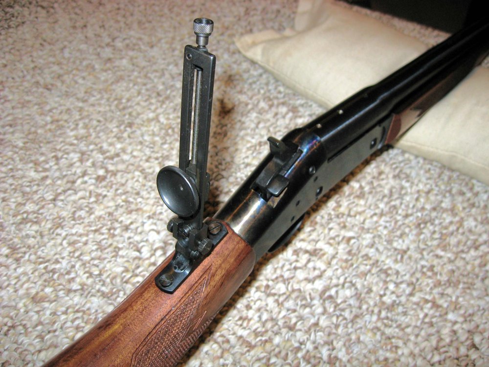

Chancy Shot, SASS #67163 Posted August 31, 2022 Posted August 31, 2022 I had one once. Mounted the site on the stock (see picture). Could not hit a barn if i was in it. Sold it to a buddy who could really use it. It was me, not the rifle. Chancy
Phantom, SASS #54973 Posted August 31, 2022 Posted August 31, 2022 Mounting a sight to wood is...not ideal. Phantom
Eyesa Horg Posted August 31, 2022 Posted August 31, 2022 And where do you put your thumb? Mine wants to be right where that sight is.
Chancy Shot, SASS #67163 Posted September 1, 2022 Posted September 1, 2022 On 8/31/2022 at 10:50 AM, Phantom, SASS #54973 said: Mounting a sight to wood is...not ideal. Phantom Very true. Limited options. Had the skill to put in inserts for a “relatively” firm mount. Worried about wood movement with changes in humidity and temperature. Unless there was a sudden change in environment, a couple of sighting shots should be enough. As I said, a buddy could shoot it. Chancy
