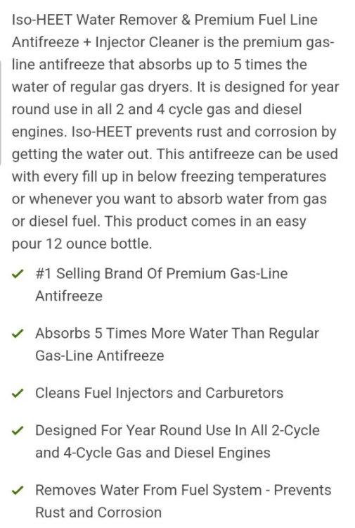

Father Kit Cool Gun Garth Posted June 21, 2022 Posted June 21, 2022 Anyone have any experience with restoring gas in a fuel tank that has been setting for years...ie. water accumulated, etc.?
Eyesa Horg Posted June 21, 2022 Posted June 21, 2022 The HEET may absorb the water, but it's still there in the alcohol and will get pumped thru. Add a double dose of Star-Tron or Sea Foam stabilizer and you may get away with it. Best would be to drain it and refill with fresh fuel with the HEET added to get remaining moisture. JMHO
