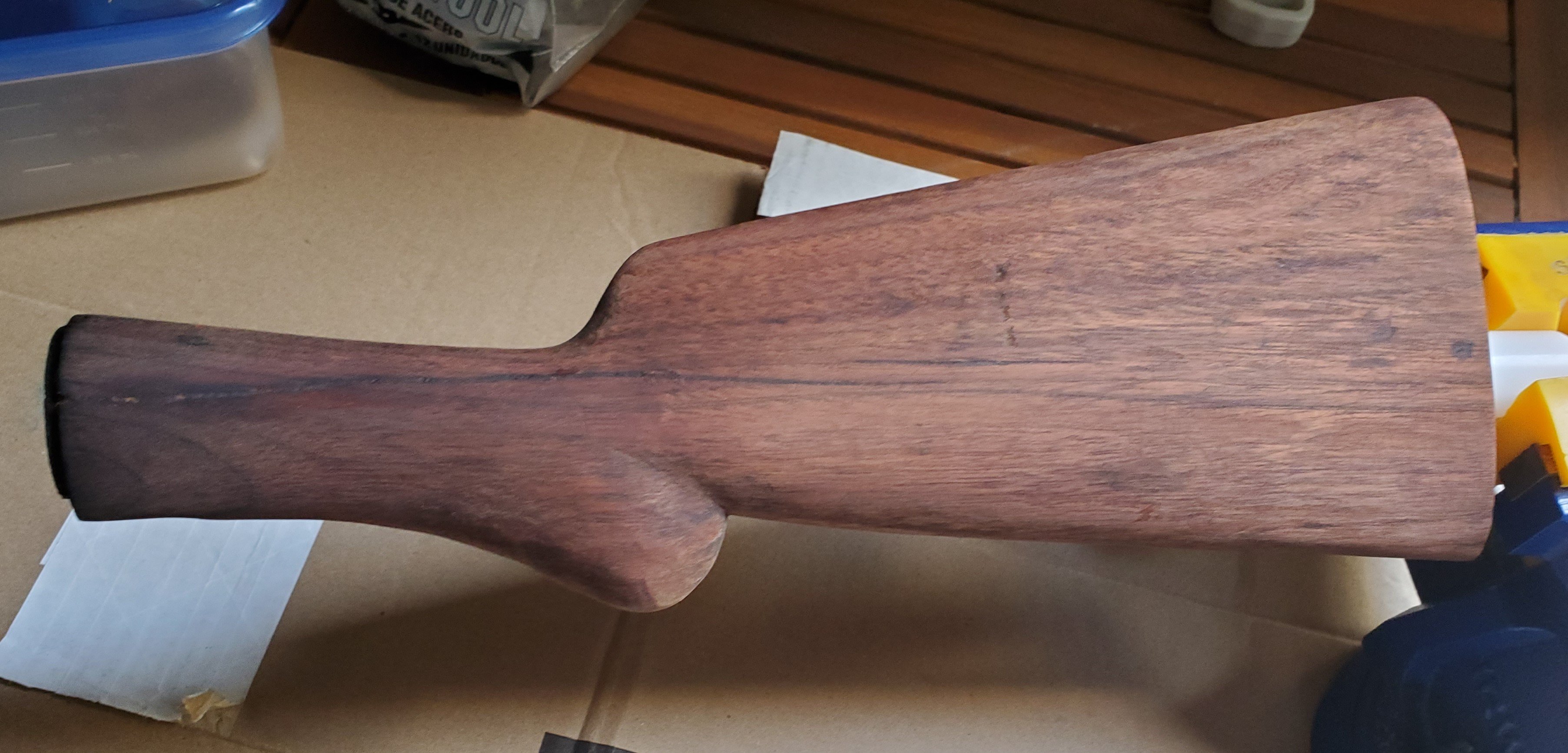

Nostrum Damus SASS #110702 Posted November 21, 2021 Author Posted November 21, 2021 OK, here are "before" and "in progress" photos (I've got several applications of Tru-Oil to go):
Nostrum Damus SASS #110702 Posted November 22, 2021 Author Posted November 22, 2021 Close to finished:
Nostrum Damus SASS #110702 Posted November 22, 2021 Author Posted November 22, 2021 All done, after buffing of the high gloss.
