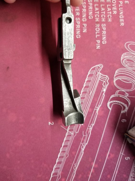

Hello all,
I'm new to Marlins/levers and have an issue with my 1894 in 44mag. I had the marlin Jam and seem to have a worn out carrier. I have been attempting to purchase a new one but everyone is out of stock. I have read on here about people having theirs rewelded etc and was wondering if anyone here provided that service or anything.  I have shot this thing in 6 months+ and I miss it =(
Contact Gunner Gatlin on this forum.     He embeds a piece of carbide steel in the carrier ramp at the correct angle
and you should NEVER experience wear on the carrier ramp again.

4 minutes ago, The Original Lumpy Gritz said:
That's the old style carrier.
OLG
Yes. The plan was to buy a new one but no one has them now, so my only timely choice is to fix this one
Fix what you have. That one is better made than the newer version.
OLG
Yep that is the old style carrier and the photo does not clearly make for the eye to see.  Like Lumpy said usually there is a notch on the carrier. I would have to see this closer. I would build up that under side. Need better photo of underside.

OP, if the rifle locked up when you fired the round.
It's not the carrier.
Were you able to open the bolt? Did it double feed?
Could you get the case to come out of the chamber at all?
OLG

Wait!!  Stop!  There's nothing wrong with this excellent carrier.  According to what you said, the gun works fine with "Winchester Silver box deer/bear loads with no issues and some reloads that I don't recall off hand what they were with no issues."   This would indicate that you don't have a gun issue, you have an ammo issue.
Before doing anything else, try running the rounds through a Lee Factory Crimp die.
Only after you have eliminated other causes, then consider the rifle.  If you are going to get the rifle carrier retimed to just shoot this Leverevolution ammo, that's one thing... but then it may not shoot the other ammo.   Just settle on the length and ammo you want to shoot through this gun and go with it.  Not everything will feed.

Were you able to open the bolt at all?
Can you post a picture of the fired case?
