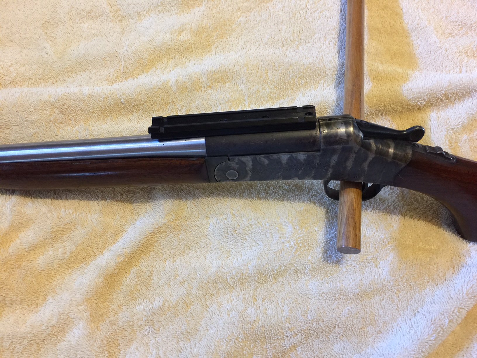

Flint N. Steele Posted June 30, 2020 Posted June 30, 2020 My .25-20 is a single shot my brothers had made for me, on a donor H&R hammerless 12 gauge. Buffalo arms has resized .32-20 brass. It's a tad short, but it works.
