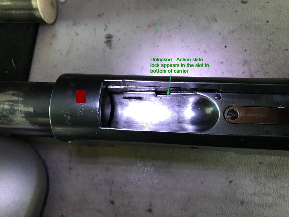

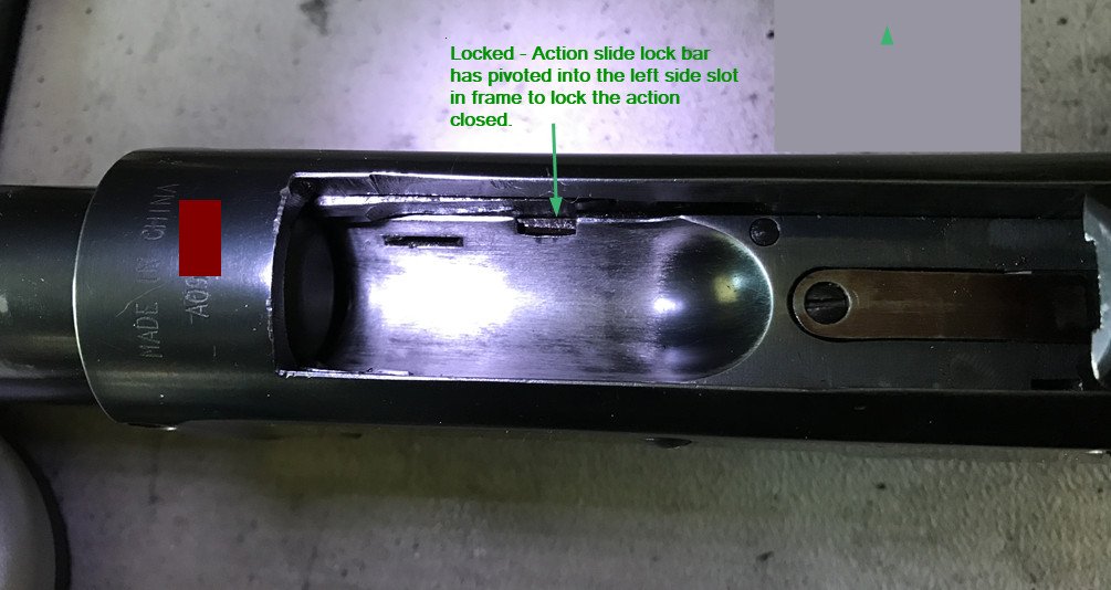

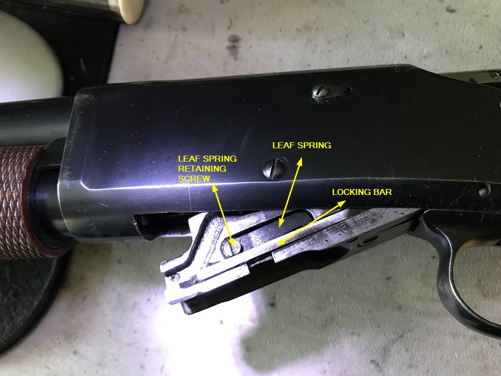

"Pull the thread" meaning you should dig deeper into the problem that even the lock release button does not release the action lock. Not "look for some other wire post that covered this problem." Although a search of the SASS wire forum might a way to learn more about possible causes of the problem. Be aware that the search engine that the forum software provides (at the top of the forum page) is not a very easy way to find old posts. Here's a more powerful way to search - use Google. In the address bar of your web page, type something like this for an "address" "sassnet: 97 action slide locked" You will get a whole bunch of results that apply to some of the problems with the action slide lock not unlocking at the right time. It could be really useful to you to scan through some of these posts from about 2012 to the present. You have a condition where neither of the normal ways of getting the action lock to unlock and let the action cycle are working - the forward push on the forearm, and the push on the release button. Here's some pictures of what should be happening. This shows one Chinese 97 that works well. You will have to look carefully with good light to see how your gun compares. First, when the action is open, you should see on the left side of the carrier three (of the six) parts that make up the lock system: the slide lock bar, the leaf spring that causes the bar to normally be tipped out away from the carrier surface, and the screw which holds the spring in place. Push gently on the left end of the lock bar and you should see it move into flush with the side of the carrier block. The action slide bar works like this..... When the action needs to be locked, the action slide lock (bar) pivots out into a slot inside the left side of the receiver. In an emergency unintended lockup, it SHOULD be possible to slip a small flat-bladed screw driver in this slot, catch the edge of the locking bar and pivot the bar to the unlocked position (bar pulled into the carrier.) Be very careful not to cause a round to fire if you do this! When the action should unlock and let you run the action normally (such as after firing), the bar is forced into a position flush with the left side of the carrier. There is a small slot milled in the left side of the carrier which lets you see the position of the bar. This unlocks the action so that the slide can be pumped open. When should action lock be locked - with action closed and hammer cocked or hammer in the half-cock notch. This means the gun will not "blow open" when the round fires. This locking on the half-cock hammer position is a problem unwary shooters have when they lower the hammer during loading, but fail to lower it fully to rest on the firing pin. This locks the gun when shooter first attempts to fire the 97 on the line. When should action be unlocked - after firing a round (due to recoil), after pushing forward on the forearm of a closed action with hammer down, or while pushing the slide lock release button with the action closed and hammer down. Also, whenever the gun action is open (the auto-pivoting of the lock bar away from the carrier surface when the carrier is exposed below the frame takes care of this). Maybe you need to tell us the context of how this problem started to occur. Is this a new gun to you, and it has shown this problem from the beginning? Is this a problem that has occurred recently, after working well for a while? Did this problem begin AFTER you did a major disassembly and reassembly of the gun? It's pretty easy to assemble the gun so it mostly works but the slide lock does not. good luck, GJ
