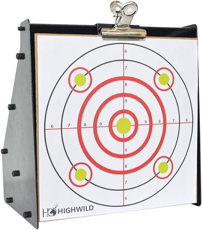

Nostrum Damus SASS #110702 Posted June 11, 2024 Posted June 11, 2024 Bad idea. When I was a wee laddie, Dad brought home a bullet trap for in-basement use with our Crossman CO2 pellet guns. Something like seen below. We put a couple of sheets of 3/4" plywood behind it, "just in case." The trap was also rated for .22LR but with a minimum distance of about 25 yards, which we didn't have in our basement because we lived in a normal-sized house. Even the .177 pellets, even centered in the opening, created a fair amount of lead mess right in front, and I have no doubt that we were breathing lead dust too (which explains a lot, I've been told). If shooting .177 pellets made a lead mess when shot into a purpose-designed trap, that tells you all you need to know about the safety and wisdom of shooting every other sort of lead projectile at any other sort of steel indoors, in my opinion. (I'm not talking about indoor shooting ranges with all appropriate backstop, walls, floor, ceiling, and ventilation -- in which case it might be at least not a completely bad idea. But I still wouldn't do it.)
