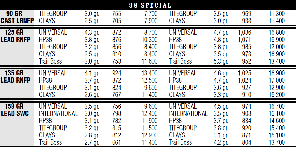

G W Wade Posted May 15, 2023 Posted May 15, 2023 4.3 (872 fps) to 4.7 (1.036 fps) for 38 spec according Hodgdon Cowboy Manuel. GW Sorry wrong info. Had Universal in head , not International GW

Marauder SASS #13056 Posted May 16, 2023 Posted May 16, 2023 The only load I can find for 38 Special with International is for 158 grain lead: 158 LEAD SWC INTERNATIONAL Min 3.0 gr. 798 f/s 12,400 psi Max 3.5 gr. 903 f/s 16,100 psi You can use that as a start and compare it with other bullet weights. It will give faster loads than regular Clays.
Marauder SASS #13056 Posted May 16, 2023 Posted May 16, 2023 For comparison in 38 Special Cowboy loads:
