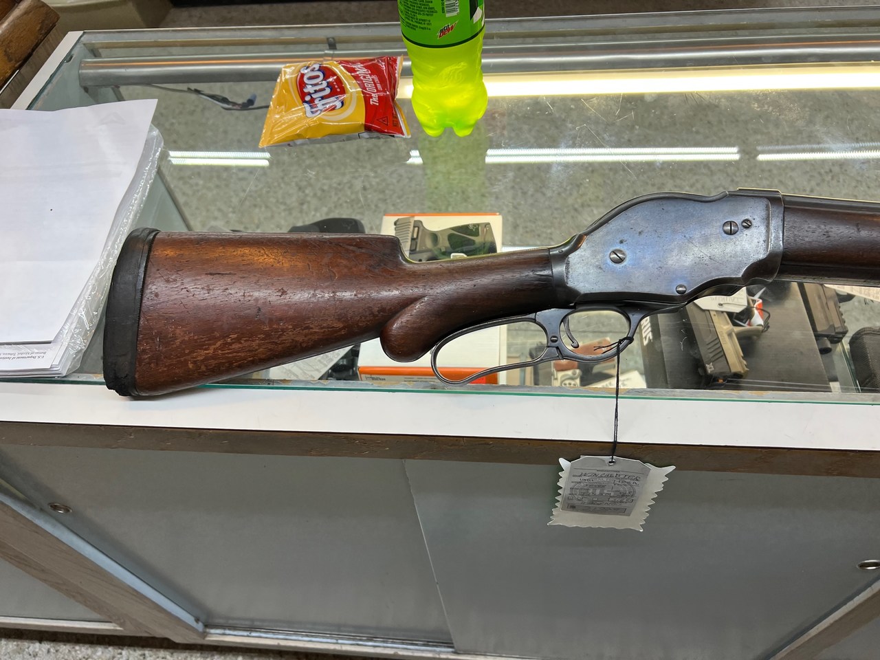

Picked up the gun today. Dates to 1917 and is pretty nice. Just need to find a stock buttplate. This one has a rubber one that’s seen better days.

Maybe here - I got a nice one for a '97 https://vintagegungrips.com/?s=winchester&post_type=product
Well, I found the correct one there but I was worried about fitment. I pulled the one of my original 1887 and now realize that my 1901 stock was cut to put the recoil pad on it. The metal buttplate wont fit properly.
So now, I guess I will try to figure out how to go back with some type of recoil pad that looks vintage and will help the gun rather than hurt it anymore.

Just some thoughts...
Compare length to see how much was cut.
Measure what length works best for you.
The "stock" length may not have been optimum for you.
Look to see who makes a really good recoil pad.
I think they sell stock spacers to put under the recoil pad to add length.
Make or buy a nice leather butt cover.
Klickitat Bob makes some real nice ones & does excellent custom work.
If the stock length is good, it is very easy to trim the hard plastic repros from vintage.  Simply score and use a drum or belt sander.  Brownells has various spacers as well. which trim the same way.  I never much cared for recoil pads or butt covers but I'm probably in a minority.
I don’t particularly care for either of them either. I prefer the metal or plastic buttplates. But, since the stock was cut I don’t have much of a choice. I’ll keep searching in hopes to find an unmolsted stock but for now I want it shootable.

Thanks. I’m still looking at and weighing my options. The recoil pad is about one inch thick and that makes the length of pull about where I need it.
10 hours ago, Sedalia Dave said:
These come in different thicknesses and look period correct.
Link is for a 1" thick pad but they come as thin as 1/2".
Pachmayr D752B Decelerator Old English Recoil Pad Grind to Fit Leather Texture
Thanks. That might be the best option at this point.
