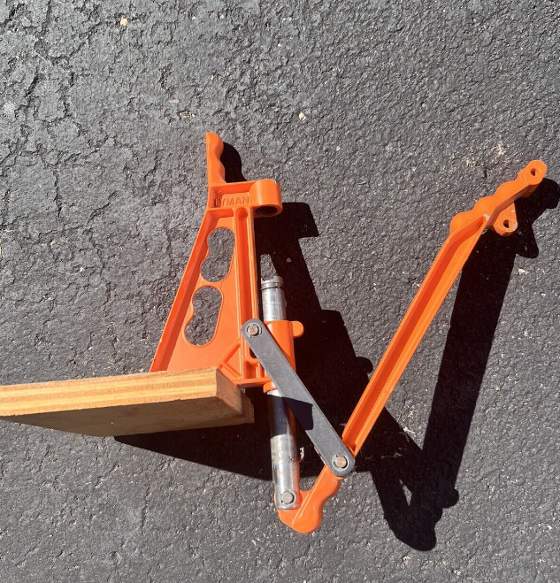

I would add that if you get into bigger cartridges or want to form one cartridge into another, a single stage O-press like the Rockchucker or a Lyman Orange Crusher can do the job while other presses may not be up to it. I couldn't find .40-82 brass for a Winchester 1886 so I had to form .45-90 into .40-82. My Orange Crusher was up to the task but it took some elbow grease. I also re-sized some used 30-06 brass that I suspect had been shot in a machine gun and it was all I could do to get it resized. I don't think a C-press or turret press would have been up to the task. And, not all presses are large enough for some of the larger hunting cartridges.
When I refer to an O-press, I am talking about the frame. An O-press has a closed frame and is very strong.
image.png.e4021cb0fb3954c90b2e934664250e26.pngimage.png.8a095d83ea777aa317ffc2f2f74fe080.png
A C-press has an open side. Most are very strong but some reloaders have experienced flexing when doing heavy work.
Some turret presses are a C-press with a rotating head. Some reloaders have experienced flexing when working with heavy brass.
Dillon makes a progressive O-press. They are quite strong. I own two 550s. But I still use my Orange Crusher when doing 7mm RemMag, 30-06, 40-82, 45-70, 270 Winchester, etc.
Photos from eBay.
