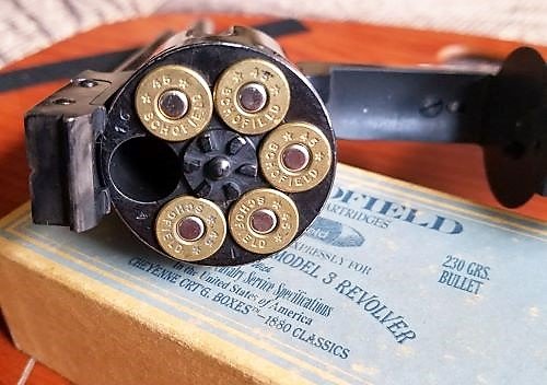

Driftwood Johnson, SASS #38283 Posted May 18, 2022 Posted May 18, 2022 6 hours ago, Rafe Conager SASS #56958 said: Driftwood, are thos original s&w pistols,? I can't get my Uberti Schofield to shoot black, I only get a cylinder full before I have to break it down and wipe it. Rafe I am talking about the Schofield revolvers Smith and Wesson manufactured from 2000 to 2002. Often known as the Schofield Model of 2000. Yes, they were only chambered for 45 Schofield, not 45 Colt. The problem you are experiencing with your Uberti Schofields is well known. This is an actual 1st S&W 1st Model Schofield that shipped in 1875. This is the cylinder. Notice the prominent bushing pressed into the front of the cylinder. The extractor rod of the cylinder fits inside the hollow cylinder arbor. When assembled, the bushing rides outside the cylinder arbor. When completely assembled, the bushing rides against the frame, horizontally separated from the barrel/cylinder gap. You can see in this photo, the upper arrow is pointing to the barrel cylinder gap, the lower arrow is pointing to the front of the cylinder bushing. This means the cylinder arbor is shielded from black powder fouling blasted out of the barrel/cylinder gap. The cylinders on all early S&W #3 Top Break revolvers (the American Model, the Russian Model, and the Schofield) were 1 7/16" long. This was an ideal length for relatively short cartridges such as 44 Russian or 45 Schofield. When Uberti started making their replicas of the S&W #3 Top Breaks they made the cylinder longer for more common cartridges such as 45 Colt and 44-40. But rather than lengthen the frame for the longer cylinder, they shortened the bushing on the front of the cylinder so the cylinder would fit in a frame the same size as the originals. Look at the bushing on your Uberti Scofield and you will see it is not as prominent as the bushing in these photos. The shorter bushing cannot shield the cylinder arbor from fouling blasted out of the barrel/cylinder gap as well as the original design, so the Uberti Schofield replicas tend to bind up quickly when fired with Black Powder. The originals can shoot Black Powder all day long without binding, because S&W understood how to design a revolver for Black Powder. There are of course work arounds, but that is why your Uberti replica Schofield tends to bind up quickly. For what ever reason, when S&W built the Model of 2000 Schofields, they varied from the original design and put a very short bushing on the front of the cylinder. That is why the Model of 2000 Schofields also tend to bind up quickly when fired with cartridges loaded with Black Powder. When I examined the Model of 2000 Schofields in a local store, I saw right away that the short bushings would mean they would not shoot BP very well. So I thanked the dealer for letting me take a close look and put them down. Besides, I have a couple of originals so I do not need a modern variation that will not shoot Black Powder very well.

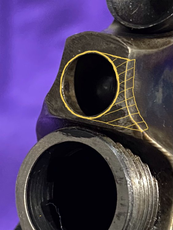

Mountain Man Gramps Posted May 23, 2022 Posted May 23, 2022 I purchased a pair of Uberti 1858’s before I came across Driftwood’s posts about the missing collar. I have experienced the cylinders locking up partway through a match. Here is an idea as crazy as it might seem. The lockup problem is due to the missing collar. So what if you were to expand the cylinder pin hole on the front of the cylinder and at the front of the cylinder opening in the frame as shown by the yellow circles in the two photos. Make the expansion about 3/8” deep. Then press a 3/4” length of steel tube into the cylinder pin hole with an Inner diameter that allows the cylinder to spin properly. Now when the cylinder is inserted into the frame the cylinder now has a collar to help keep the pin clean. You would also need to mill the side of the frame by 3/8" to allow the modified cylinder to be inserted. What do you think?
