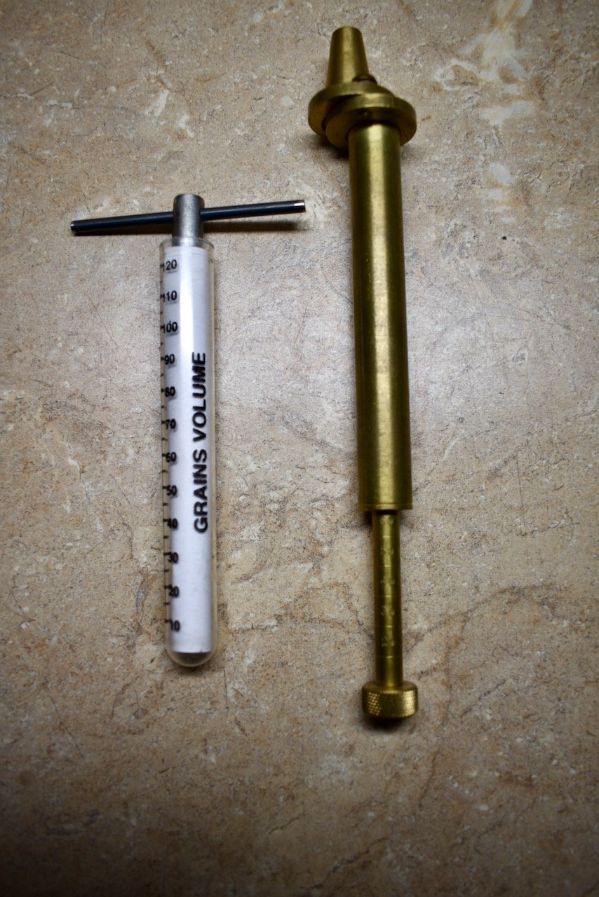

Larsen E. Pettifogger, SASS #32933 Posted March 12, 2022 Posted March 12, 2022 You DID NOT say Black Powder. Most people when they talk about powder measures are thinking about measures on reloading presses for smokeless. No "powder measure" for smokeless is in grains. BP measures measure by volume but for convenience many have a grains equivalent printed on them and that is only an approximation as ffg and fffg and different brands will weight a different amount for a given volume. Virtually everyone wants to know how many grains of BP they are using so the measures are marked in grains. Most people don't care what the volume is and what volume would you want? CC's, cubic inches?
Larsen E. Pettifogger, SASS #32933 Posted March 12, 2022 Posted March 12, 2022 I just went in the loading room and grabbed a couple of BP measures. They are marked in grains equivalent because that is what people want to know - how many grains are they shooting. The only measures I know of that are marked in cc's are the Lee Dippers. Out of curiosity why do you want a measure that reads volume?

Garrison Joe, SASS #60708 Posted March 13, 2022 Posted March 13, 2022 Well, back to my chemistry background, I would get a graduated cylinder (usually glass) that holds up to 10 CC (cubic centimeters). You could then drop in the powder charge which you find fills a particular case to the desired level in the neck for best accuracy. Instantly read the graduations on the glass at the top of powder level, and VOILA you have the volume. This one on Amazon is a 10 CC capacity (which is 10 milliliters, too) cylinder that ought to read any reasonable BP powder charge. Even if the picture shows a 25 CC capacity cylinder. https://www.amazon.com/SEOH-10ml-Glass-Graduated-Cylinder/dp/B0018QCFLM Yes, it's not adjustable. That is why you keep a brass adjustable measure around for actual loading use. Or a Lyman 55 powder dispenser (brass rotor). This breakable glass graduated cylinder is just to check the volume that your measure is currently set for. If you need to adjust measure again, you quickly check the volume again. good luck, GJ
