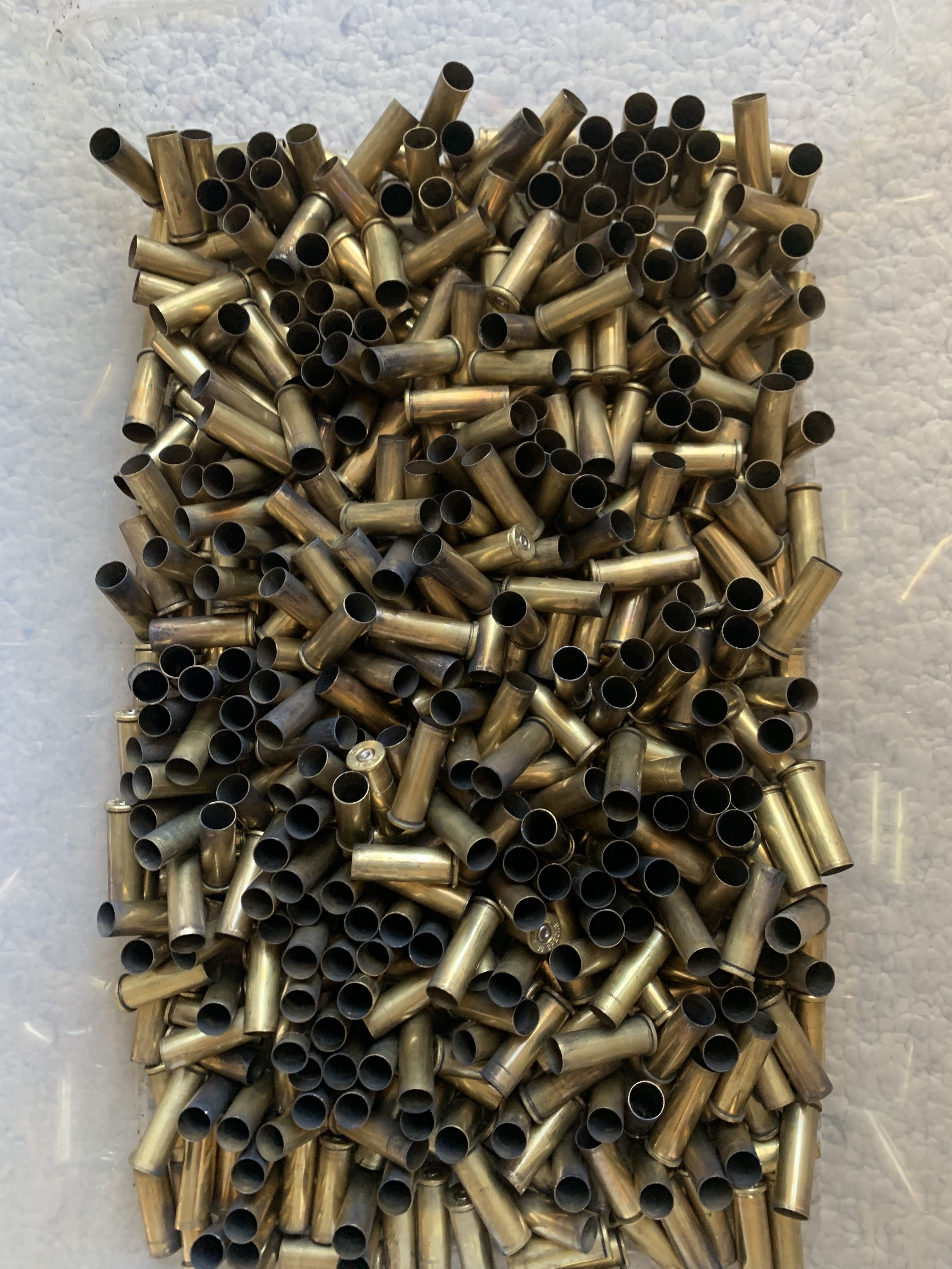

Springfield Slim SASS #24733 Posted February 25, 2022 Posted February 25, 2022 I like my wet tumbler because it cleans the inside ,making it that much easier to see if I have a proper powder charge or not. This is going to be even more important when I run out of Trailboss and have to use a less bulky powder, making me look further inside to check the charge. Plus, I don't understand how a vibratory tumbler doesn't get the brass shiny clean on the outside. I used a vibratory for 15 years before I used a wet tumbler, and they were always shiny on the outside. I put a bit of auto paint swirl remover and it worked great, sometimes still do that after wet tumbling if I am not going to use that brass for a while.
Buckshot Bear Posted February 25, 2022 Author Posted February 25, 2022 4 minutes ago, Springfield Slim SASS #24733 said: I like my wet tumbler because it cleans the inside ,making it that much easier to see if I have a proper powder charge or not. This is going to be even more important when I run out of Trailboss and have to use a less bulky powder, making me look further inside to check the charge. Plus, I don't understand how a vibratory tumbler doesn't get the brass shiny clean on the outside. I used a vibratory for 15 years before I used a wet tumbler, and they were always shiny on the outside. I put a bit of auto paint swirl remover and it worked great, sometimes still do that after wet tumbling if I am not going to use that brass for a while. That's what I have found as a great added bonus

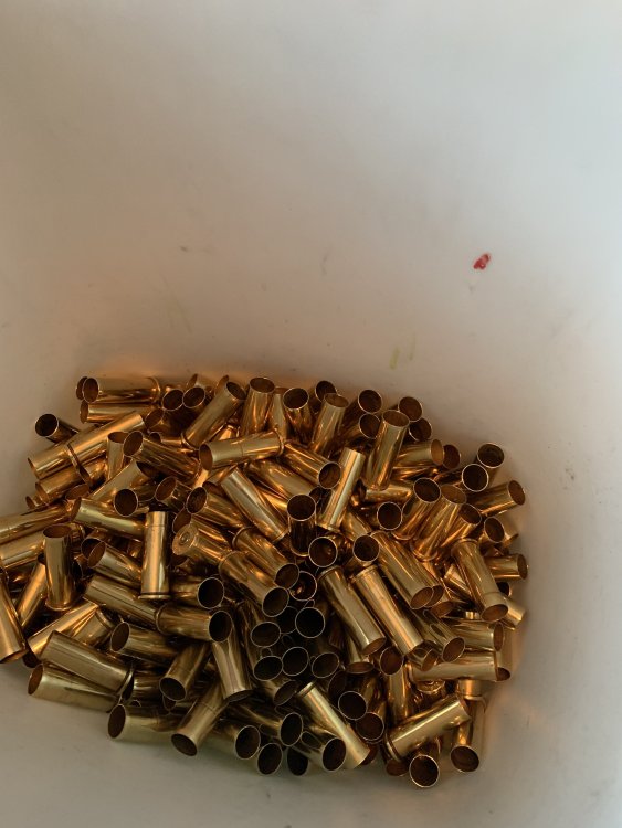

Captain Bill Burt Posted March 20, 2022 Posted March 20, 2022 So, 2.5 hours with a heaping teaspoon of Lemi Shine and a heaping teaspoon of Armorall Wash and Wax.
