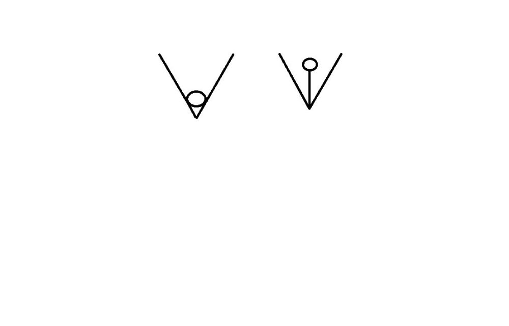

Quiet Burp Posted October 19, 2021 Posted October 19, 2021 Buckhorn sights are new to me, they are BIG and will take some getting used to. I know the drawing below is pretty crappy, but what sight picture do you use for buckhorn sites?
G W Wade Posted October 19, 2021 Posted October 19, 2021 Try it on a target yourself. Shoot 1 with bead at bottom and 1 at top. Then fire 1 far left and 1 far right. Probaly find out they are all close enough for cowboy ranges and also which is easier to pick up the sight picture that is best for you. IMHO I like to float the bead, not bury it GW
Ripsaw Posted October 19, 2021 Posted October 19, 2021 My bead is centered in the open area between the "horns." The diagram on the right.
Painted Mohawk SASS 77785 Posted October 19, 2021 Posted October 19, 2021 I took the top of the 2 horns, added a suresight & basically just have the 3 level.
Garrison Joe, SASS #60708 Posted October 19, 2021 Posted October 19, 2021 I don't like how buckhorn sights snag things, and how the horns block my vision when acquiring the next target in a horizontal row. OFF the horns come, making a flat sight. The only precise way to shoot the buckhorn is to put bead down in the bottom of V. Anything else is SO dependent upon getting a consistent picture. For a 10 yard cowboy match shot, it really doesn't matter, though. good luck, GJ
Trailrider #896 Posted October 19, 2021 Posted October 19, 2021 I personally use "a", treating the rear sight like a open-top peep (aperture). The main thing is consistency! Whatever sight picture you choose, once you get the elevator adjusted the way you want it, use the same picture always, except if you need to adjust for range (not usual in CAS).
