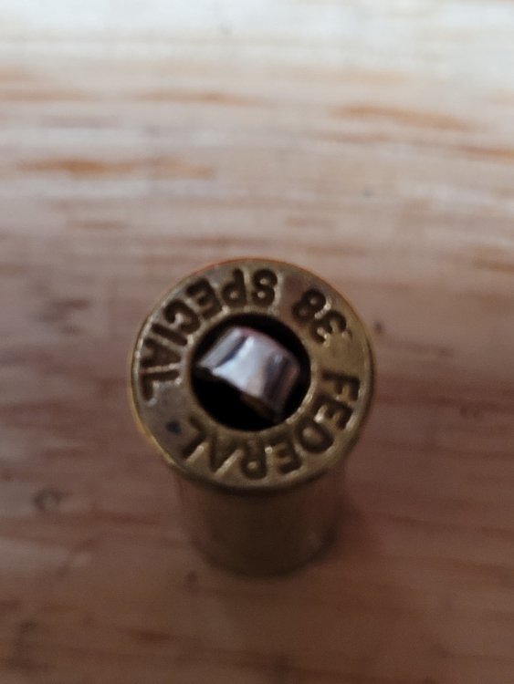

Snakebite Posted October 2, 2021 Posted October 2, 2021 I think everyone with a 650 has experienced this on occasion, but for some reason I'm getting it more often lately... I don't know why. I'd appreciate feedback if you have a idea as to why it is happening. I usually feel it when it happens and stop the seating process and then pull out the case before smashing it all the way in, but when I'm on a roll and really cranking them out I don't always catch it. Snakebite

Doc Shapiro Posted October 2, 2021 Posted October 2, 2021 I ran into that when the primer seating ram got peened and misshapen due to lots of use. It stopped retracting all the way, causing the primers to go on edge and sometimes flip. Dillon sent me a new part and all squared away.
Legendary Lawman, SASS 73160 Posted October 2, 2021 Posted October 2, 2021 When I had that problem, after talking to Dillon, I could see that the primer punch was not dead center on the opening of the shellplate. Therefore, every so often as the primer punch came up, the primer edge would catch under the edge of the shellplate, tipping it sideways as it went in the primer pocket. I realigned it so that the punch came up exactly in the center of the shellplate opening. Problem solved (for me at least)
Snakebite Posted October 2, 2021 Author Posted October 2, 2021 Thanks guys... I took it apart and cleaned the devil out of it. I expected to see something like Doc mentioned, but the ram looked OK to my eye. Anyhow... I ran a quick 200 rounds through it and it didn't happen. I've been slack on keeping things as clean as I should. Snakebite
Larsen E. Pettifogger, SASS #32933 Posted October 2, 2021 Posted October 2, 2021 Looks like you might have already fixed the problem. But since I just went and took a couple of photos I thought I'd post anyway. I started having all kinds of primer problems. Cleaned, used my handy dandy Dillon alignment tool and no improvement. I had the machine completely taken apart and by accident found the problem. The shell plate advancement cam was broken. It had broken right where there is a notch and then the cam begins. Red arrow. What was happening was the cam would stretch at the break when cycled and then close close back up when you were inspecting all the parts. It was basically invisible. By happenstance I was fiddling with the cam and when I gave it a slight twist the gap opened up. The Dillon spare parts kit has an extra cam in it. I have had this machine well over 20 years but finally got to use the spare cam. What was confounding was only about one in ten primers got tipped or squashed. Sometimes the broken cam rotated the shell plate enough sometimes it did not.

Roger Rapid Posted October 5, 2021 Posted October 5, 2021 Snakebite... Looks like your problem is solved. I had it, too, and found that the primer wheel and the shell plate were not exactly aligning with each other, such that when the primer plunger pushed the primer up, the primer would catch on the edge of the shell plate which tilted the primer allowing it to go up sideway. Cleaning out the recesses in the shell plate and primer wheel and slightly lengthening the springs for the shell plate and primer wheel ensured that they aligned perfectly again and solved the problem. RR
Snakebite Posted October 5, 2021 Author Posted October 5, 2021 Roger, I did check the alignment and it looked good at that point in time .. HOWEVER... it is my opinion that it was indeed the alignment becoming OFF that was causing the problem. I think it was becoming OFF because things were dirty and not freely moving into the proper alignment. A complete disassembly and hose down with Break Cleaner, then a very careful and strategic application of lubricant appears to have cured the issue. I have now loaded another 500 rounds without even one issue. Snakebite
Dusty Devil Dale Posted October 9, 2021 Posted October 9, 2021 You've already cleaned up the primer delivery system, so this may be irrelevant. But whenever I've had the crossfeed problem, it has been cured by cleaning up the primer wheel detent ball and it's travel boring, brushing out the primer wheel holes, and replacing the detent spring. If the little ball (or the primer plate holes) get dirty or caked with spilled powder residue, or the spring becomes less than crisp in snapping the ball up into position, it can cause the intermittent misalignment that several here have described.
