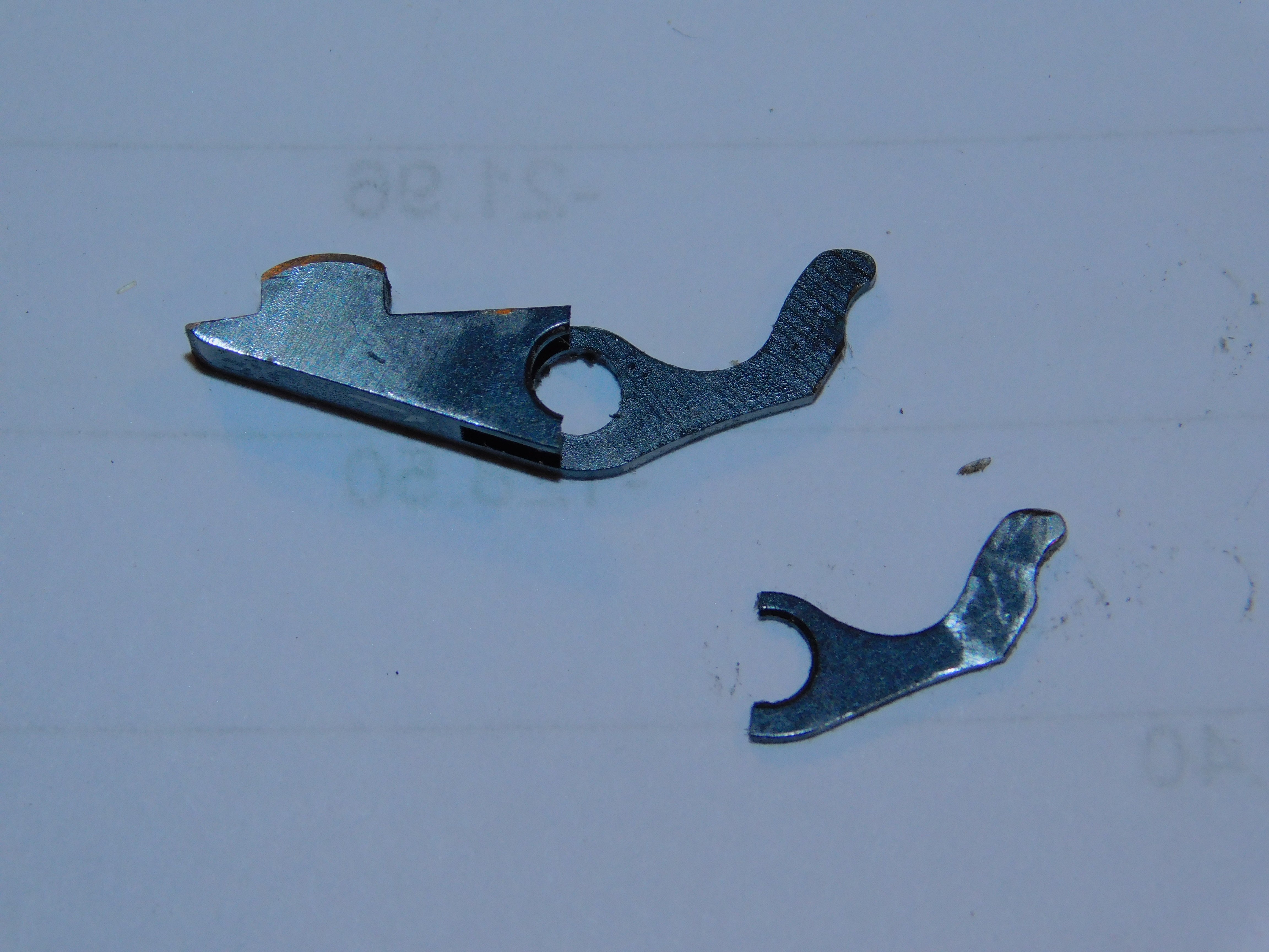

Sarge Posted September 20, 2020 Posted September 20, 2020 Broke two trigger bolts on my Uberti Running Irons in the past week, Both broke through the hole that pins them in place. First question, any way to strengthen this area? Second, anyone have a spare trigger bolt they'd be willing to part with? Sounds like everyone is out of them due to issues in Italy. Thanks.
The Original Lumpy Gritz Posted September 20, 2020 Posted September 20, 2020 Sounds like a heat treat issue, as in brittle. Buy at least 3-4. Call the maker in the morning. Have you ck'd Brownells? Have you tried contacting SASS gunsmiths? Can you post a picture of the broken bolt? OLG

Patagonia Pete Posted September 21, 2020 Posted September 21, 2020 Yeah ... I know what an SAA bolt is ... It has an arm that rides on the cam on the side of the hammer ... Would like to see a picture of one of the "broken" ones.

Sarge Posted September 21, 2020 Author Posted September 21, 2020 13 minutes ago, Patagonia Pete said: Yeah ... I know what an SAA bolt is ... It has an arm that rides on the cam on the side of the hammer ... Would like to see a picture of one of the "broken" ones. Don't have the other one here, but both of them broke in exactly the same place, locking up the cylinder. First one broke while dry firing. This one broke today during a match.

Patagonia Pete Posted September 21, 2020 Posted September 21, 2020 10 minutes ago, Sarge said: Don't have the other one here, but both of them broke in exactly the same place, locking up the cylinder. First one broke while dry firing. This one broke today during a match. Cool ... thanks for the photo.
45 Dragoon Posted September 21, 2020 Posted September 21, 2020 The cam is too tall and the arm is too short (and probably too thick). Mike

Colorado Coffinmaker Posted September 21, 2020 Posted September 21, 2020 The inside of the leg as shown on your sample example shows lots of machine marks that create "stress risers." You might want to inspect your new Bolts and with a narrow flat and some 320 Wet/Dry, polish out those machine marks. The broken leg also appears to be missing the bevel that starts the leg over the cam. Look for that also on the new bolts. As has been mentioned by The Dragoon, the cam may well be too tall.
Warden Callaway Posted September 21, 2020 Posted September 21, 2020 26 minutes ago, Colorado Coffinmaker said: The inside of the leg as shown on your sample example shows lots of machine marks that create "stress risers." You might want to inspect your new Bolts and with a narrow flat and some 320 Wet/Dry, polish out those machine marks. The broken leg also appears to be missing the bevel that starts the leg over the cam. Look for that also on the new bolts. As has been mentioned by The Dragoon, the cam may well be too tall. I've never considered a bolt as a drop in replacement part. I have polished the bolt as CC recommend on about every new single action I've bought - including Colt. I've also added the bevel to a few that had none. I carefully polish the cam area on the bolt. I usual don't change the height. But Uberti Cattleman tend to have a step at the low end of the cam. I tend to reduce this step and blend the cam ramp to one slope. Picture of a cam I find typical of a Cattleman. I blend the "bright" face down to remove the steap lower ramp.

Sarge Posted September 21, 2020 Author Posted September 21, 2020 28 minutes ago, Warden Callaway said: I've never considered a bolt as a drop in replacement part. I have polished the bolt as CC recommend on about every new single action I've bought - including Colt. I've also added the bevel to a few that had none. I carefully polish the cam area on the bolt. I usual don't change the height. But Uberti Cattleman tend to have a step at the low end of the cam. I tend to reduce this step and blend the cam ramp to one slope. Picture of a cam I find typical of a Cattleman. I blend the "bright" face down to remove the steap lower ramp. 1 hour ago, Colorado Coffinmaker said: The inside of the leg as shown on your sample example shows lots of machine marks that create "stress risers." You might want to inspect your new Bolts and with a narrow flat and some 320 Wet/Dry, polish out those machine marks. The broken leg also appears to be missing the bevel that starts the leg over the cam. Look for that also on the new bolts. As has been mentioned by The Dragoon, the cam may well be too tall. Great information here. Thank you. As these guns were both short stroked guns, does this have any impact on the relationship between the cam and the leg?
doc roy l. pain Posted September 21, 2020 Posted September 21, 2020 8 minutes ago, Sarge said: Great information here. Thank you. As these guns were both short stroked guns, does this have any impact on the relationship between the cam and the leg? Absolutely
45 Dragoon Posted September 21, 2020 Posted September 21, 2020 The amount of "tension" applied by spreading the bolt arm should only be enough to keep the arm against the hammer. Reducing the tension to allow the arm to fall off the side of the cam is a problem that will only get worse. The bolt arm should fall off the forward surface of the cam because it is being pull to the rear as the hammer is cycled back. I dress both parts differently so they "lock" together so the arm can't fall off prematurely. W.C., you can blend the "break line" in the pic as well to smooth the transition (like a baby moon hubcap). The "reset cut" (on top of the bolt arm) is a must and should be polished. It should stop before or at the top outside rearmost corner to maintain the full width "contact patch" that rides the cam (which prevents early "slide off" as opposed to "drop off"). Mike
