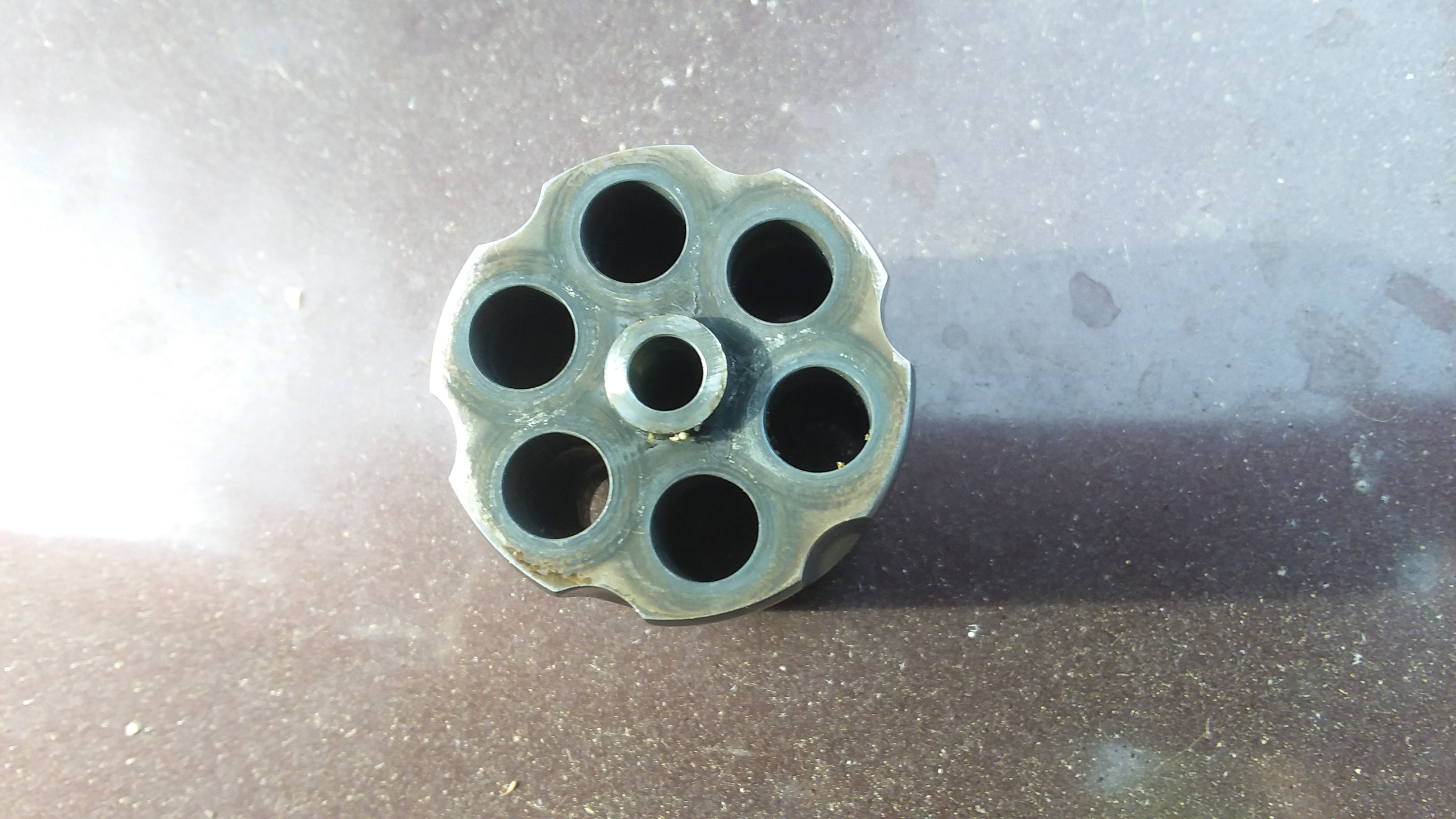

Dusty Devil Dale Posted May 31, 2020 Posted May 31, 2020 8 minutes ago, The Original Lumpy Gritz said: That cyl is fitted to that revolver. OLG Ruger cylinders often have the last three digits of the gun SN very lightly engraved in the front of the cylinder, near the hub. You have to clean the cylinder really well and look closely to see it.
Marshal Chance Morgun Posted May 31, 2020 Posted May 31, 2020 8 minutes ago, Dusty Devil Dale said: Ruger cylinders often have the last three digits of the gun SN very lightly engraved in the front of the cylinder, near the hub. You have to clean the cylinder really well and look closely to see it. Oh, That's why I've never noticed it.
Dusty Devil Dale Posted May 31, 2020 Posted May 31, 2020 43 minutes ago, Marshal Chance Morgun said: Oh, That's why I've never noticed it. It is indistinctly scratch engraved with what looks like a vibratory engraver. I have to scrub the end with solvent and a nylon brush (if blued) or a brass brush (if SS) to be able to read them. I have no idea why they don't stamp the numbers. The upper photo shows it with one side of the cylinder brush-cleaned. The lower photo is same cylinder before brushing.

Caboose Posted June 1, 2020 Posted June 1, 2020 10 hours ago, Dusty Devil Dale said: It is indistinctly scratch engraved with what looks like a vibratory engraver. I have to scrub the end with solvent and a nylon brush (if blued) or a brass brush (if SS) to be able to read them. I have no idea why they don't stamp the numbers. The upper photo shows it with one side of the cylinder brush-cleaned. The lower photo is same cylinder before brushing. Did you purchased the Vaquero’s new with last 3 numbers on each cylinder or used when purchased? Looks to me like someone used a vibrator engraver and did them. I do that my Vaquero’s with a vibrator engraver and they look about like this one. I would think Ruger would use a stamp if and they be nice and neat in appearance like the serial numbers.

Dusty Devil Dale Posted June 1, 2020 Posted June 1, 2020 1 hour ago, Caboose said: Did you purchased the Vaquero’s new with last 3 numbers on each cylinder or used when purchased? Looks to me like someone used a vibrator engraver and did them. I do that my Vaquero’s with a vibrator engraver and they look about like this one. I would think Ruger would use a stamp if and they be nice and neat in appearance like the serial numbers. They came new from Ruger with the marks. My wife shoots a pair of Single Sixes (.32 cal) and they also came new from Ruger with the numbers engraved. I agree they look home spun, but I've seen many other New Vaqueros and Blackhawks that have them. I don't know about older guns. I'd be curious. Pls look and report.
Dakota Rambler Posted June 2, 2020 Posted June 2, 2020 I just check my nm vaqueros, both have the last three scribbled on the cyl. Looks like a kid did them. But on the plus side, my cylinders were in the right pistols after all these years!!!
G W Wade Posted June 2, 2020 Posted June 2, 2020 As far as I know all Ruger cylinders are engraved with the last 3 numbers of the gun they were originally fitted to. GW
