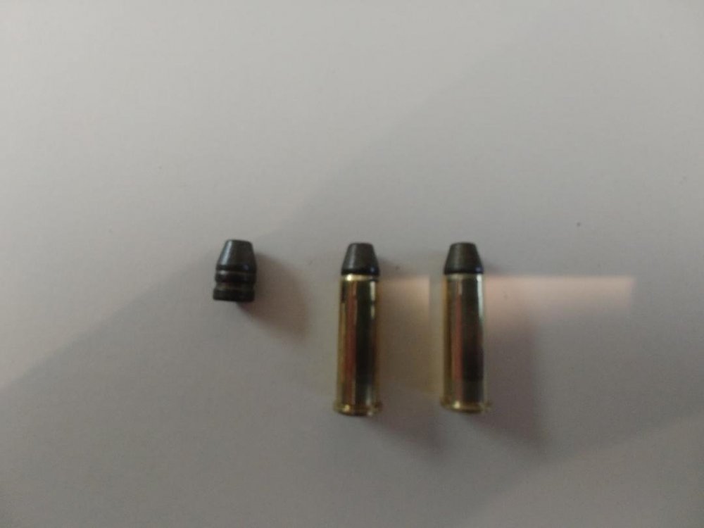

Russ The Red Posted May 20, 2020 Posted May 20, 2020 I have found a small roll-crimp best. It is barely noticeable, but it does the trick for me. Others I talk with have about the same roll-crimp. I make it fit in the bullet's crimp ring. Here is a picture of mine. I have an OAL of 1.46 which fits the range set by Pioneer Gun Works (1.44 to 1.56). I use Chey-Cast bullets and Dillon 550 with CCI, Federal, or Winchester small pistol primers. Chey-cast bullet on left, next is roll-crimp, and on the right is no crimp. Hope this helps. This works very well in my Uberti and my Miroku (Winchester) 1873s. I've only run a few thousand rounds through both guns, so others here may have other information to offer.
Garrison Joe, SASS #60708 Posted May 21, 2020 Posted May 21, 2020 Overcrimp is not usually a functional worry. May be detrimental to accuracy, may overwork the brass case mouth, or may be bulging the case below the crimp so that the round does not chamber. Too little crimp will, as mentioned above, lead to the bullet being pushed into the case with the recoil and spring pressure that the cartridges in the magazine are under. No crimp at all can leave a sharp edge that will catch on the rear face of the barrel, preventing smooth chambering. Here's how you check that the crimp is firm enough. First, try to twist the bullet of a test round. Should be difficult to twist by hand. Second, hold the round in your hand, press the bullet firmly into a solid object with fifty or more pounds of force. An easy way - stand by a (garage, or little used) doorframe, press the bullet straight into the jamb a little above the door knob level. When you lean into that press, bullet should stay exactly where you crimped it. If it collapses into the case, crimp more firmly. Bullet crimp should look like pictures above, or a lead bullet factory load if you have one. Good luck, GJ
Stormy_LaSalle Posted May 21, 2020 Author Posted May 21, 2020 2 hours ago, Russ The Red said: I have found a small roll-crimp best. It is barely noticeable, but it does the trick for me. Others I talk with have about the same roll-crimp. I make it fit in the bullet's crimp ring. Here is a picture of mine. I have an OAL of 1.46 which fits the range set by Pioneer Gun Works (1.44 to 1.56). I use Chey-Cast bullets and Dillon 550 with CCI, Federal, or Winchester small pistol primers. Chey-cast bullet on left, next is roll-crimp, and on the right is no crimp. Hope this helps. This works very well in my Uberti and my Miroku (Winchester) 1873s I literally run the same bullets and primers. So I will give that a try also. Makes sense. I appreciate the response
