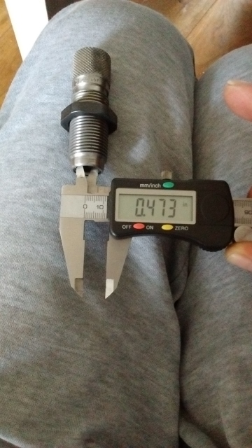

Four Eyes Henry Posted July 10, 2017 Posted July 10, 2017 My cartridge outside diameter is 0,475 and they are 1,506 long. I shoot Black Powder 99% of the time with CBC brass. Uptill now I have had no problems with stovepiping and ejecting of live rounds. I found that CBC brass gives a better seal. My sizing die has been reamed out to 0.473

The Original Lumpy Gritz Posted July 10, 2017 Posted July 10, 2017 PR-Do you have any factory .45 Colt ammo to get some specs off of like dia? I ask, because you said this "The .45 Colt outside cartridge diameter is .480". Well-My .45 Colt ammo, loaded with 20+ year old RCBS carbide size die, has an OD of .472-.473 measured at the bullet level of the case. This is with a .453 dia bullet. Might want to get a new size die before any more mess'n with the gunz insides.......... OLG
Pat Riot Posted July 11, 2017 Author Posted July 11, 2017 OLG, I could kiss ya!...well, not really. I just got done measuring a few rounds of my reloads and here is what I found: At top near bullet = .474 - .475. Midway down = .469 - .470. Near the base = .475 - .476 Bullet diameter is .452" This is also consistent with loads that I just did using brand new Starline cases and no sizing die was used. I just expanded them, primed them, seated the bullet and used the Factory Crimp die. My dummy loads that I made up all measured the same as the reload measurements above. .480" diameter is the SAAMI Maximum dimension. It's the same in 6 of my reloading manuals. I learn something new everyday. Thank you. I just started reloading .45 Colt a few months ago. I never considered the case dimension in this but I should have. I recall a similar issue I had with .357 years ago regarding dimensions but it was because of case thickness just being narrow enough to be a problem in my Win. 94 and my Marlin. I threw the brass away and that was that, This is a little different. You see, I always used .357 and .38 when shooting CAS before. I decided to go with .45 last Fall. I use RCBS dies so I don't doubt them at all. I will just keep cartridge dimensions the same and rework the gun a little. So, it looks like some shimming may be in order on the right cartridge guide. It's pretty simple to do. I am thinking .004 or .005" shim stock. This will give me about .005" clearance. This and a good cleaning just might do the trick. If not, I can check these things off the list and move forward. The next steps would be rethinking OAL and maybe moving up in bullet weight. Thank you very much! Thanks to everyone that responded. I do appreciate all the help.
Pat Riot Posted July 11, 2017 Author Posted July 11, 2017 I forgot to add that I measured some Hornady Leverevolution rounds and some Winchester Super X factory loads and from the top to the bottom just as I had measured in the prior post they were .475" at all 3 points on both manufacturer's rounds.
The Original Lumpy Gritz Posted July 11, 2017 Posted July 11, 2017 Get a Lee Factory Crimp Die. Earth, will be round again......... Always size new brass just 'cause'. OLG
