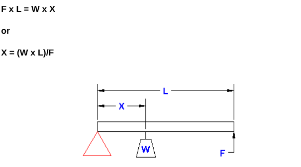

WTB /borrow? Trailer tongue weight scale
Sedalia Dave replied to Hoss's topic in SASS Wire Classifieds
This^^^^ Except that the supports for each end of the 4X4 should be round. A piece of pipe or wood dowel on top of the wood block held in place by a couple nails will give more accurate reading. Here is diagram of how to set everything up. W = Tongue weight F = Weight displayed on the scale L needs to equal at least 7 feet. X should equal 1 foot Transforming the formula [ F x L = W x X ] to calculate for an unknown weight. F x L = W X An 8' 4X4 set up so that distance L is 7' will give a margin of error on each end to ensure that nothing shifts and falls and will safely weight up to 1400 pounds of tongue weight without damaging a bathroom scale. Works and can easily be done in your driveway. -
