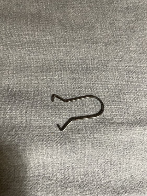

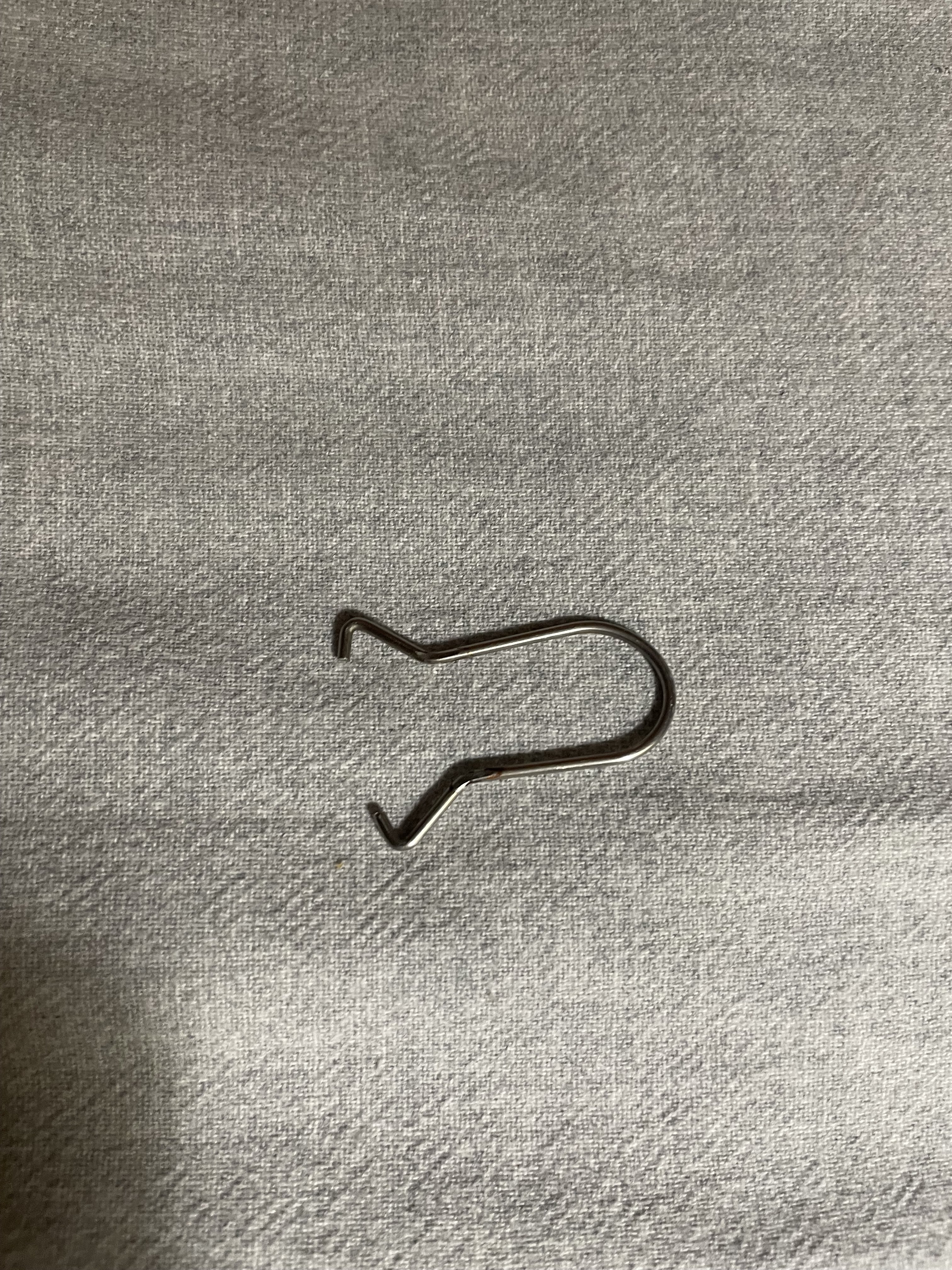

Irish Pat Posted July 20, 2024 Posted July 20, 2024 i have a probably 8 year old Rugged Gear gun cart. the right rear wheel came off while i was loading it in my truck. I got wheel back on the axle but the pin that goes on the end of the axle bent while I was trying to get it back on. I sure somebody else has probably been through this I need some suggestions. Irish ☘️ Pat
Irish Pat Posted July 20, 2024 Author Posted July 20, 2024 I think all I need to get my wheel back on is one of these pins if any one has an extra I could sure use it

John Kloehr Posted July 21, 2024 Posted July 21, 2024 22 hours ago, Irish Pat said: Google failed me, have never seen a clip like that. So Im thinking: 21 hours ago, Rance - SASS # 54090 said: Ya got room to just drill a small hole and use a washer and cotter key?? Just sayin.. or a snap ring if there’s a groove all the way around the axle.. So @Irish Pat got pictures of the problem to solve? Contacting RG is certainly another option. But if it is something otherwise solved from any hardware store and a bit of playing, that might be easier than getting factory service.
The Original Lumpy Gritz Posted July 21, 2024 Posted July 21, 2024 23 hours ago, Irish Pat said: picture Not familiar with that one. How does it look installed on the other wheel?

Scarlett Posted July 23, 2024 Posted July 23, 2024 On 7/21/2024 at 7:37 PM, The Original Lumpy Gritz said: Not familiar with that one. How does it look installed on the other wheel? This style of pin is NOT meant to come out. This pin is meant to push in/down to remove wheel. Once it is out it’s virtually impossible to reinstall and you need to go the drill cotter pin route. Hugs! Scarlett
The Original Lumpy Gritz Posted July 23, 2024 Posted July 23, 2024 7 hours ago, Scarlett said: This style of pin is NOT meant to come out. This pin is meant to push in/down to remove wheel. Once it is out it’s virtually impossible to reinstall and you need to go the drill cotter pin route. Hugs! Scarlett Could you post a picture please? Sounds much different than my 1st generation cart.
