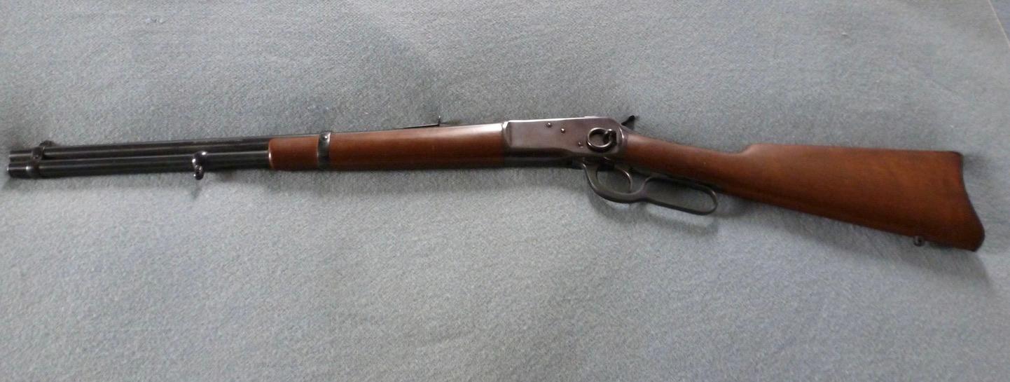

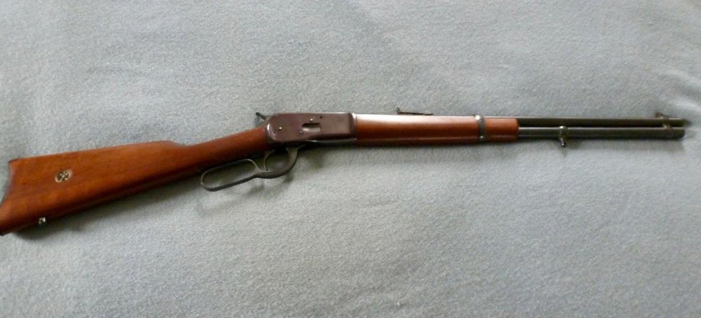

Eyesa Horg Posted January 8, 2023 Posted January 8, 2023 Not sure if this post is allowed but here goes. A gentleman got my number from SASS and is looking to sell this rifle. It has a 20" barrel and he was told it is a Rossi. I told him I'd post to see if there was any interest and approx. value. I explained if he joined the wire and posted it to expect to provide current requested photos with a newspaper to prove he has it. He's looking for about $650-- $750. He has had it about 20 years. It has sling attachments and a hokey compass inset in the butt stock. Says it shoots fine and he has a couple boxes of cartridges to go with it. He doesn't seem to be familiar with firearms as he didn't know what the receiver was when I asked him to measure the barrel. He lives in Montgomery, VT. He sent me a couple of old photos for this post. I've had a couple phone conversations with him and he feel legit. JMO As President of the Vermont CAS club, I offered to help him out. Eyesa

H. K. Uriah, SASS #74619 Posted January 8, 2023 Posted January 8, 2023 Looks like a pre-safety Rossi to me. In my personal estimation, the fact that it doesn't have the safety enhances its value. As to the asking price, it feels high to me. I would have expected to pay $400 to $500, but it's been a long time since I have seen one of these, and I have no idea what they are going for anymore.

H. K. Uriah, SASS #74619 Posted January 8, 2023 Posted January 8, 2023 For what it's worth, the Rossi 92 is a decent rifle. I have one, pre safety model, in .44 Magnum, and I really like it. While not "perfect" the pre safety version is to my observation, much less clunky than the new ones with the safety. At least, that's true when I compare mine to my brother's new one in .357 Magnum. I was very satisfied with my Rossi in its unmodified configuration, until I got a real Winchester. Then I noticed that it wasn't as smooth as an original, but still pretty good. I eventually did have it smoothed out by Happy Trails, but minimally so. If I wanted a 92 in .44-40, I would very seriously consider this gun

Sedalia Dave Posted January 9, 2023 Posted January 9, 2023 Right now, new Rossi 92's in 38/357 sell for $700.00 Searched GunBroker and two 44-40 92's recently sold. An Interarms for $720 and a SS Rossi for $736

Three Foot Johnson Posted January 9, 2023 Posted January 9, 2023 It would probably bring $650 in today's market easy enough, but I think $750 is really pushing it. I had four of those .44-40 Rossi's in my collection, and have parted with three of them. One I traded away, then sold the trade for ~$620 in 2021. The others went for $550 in 2022, and $500 in 2019. The .357's, .44 mags, and .45's tend to sell for notably less on the used market.
