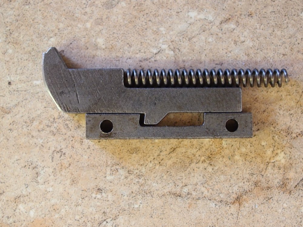

Tom Bullweed Posted November 23, 2022 Posted November 23, 2022 I have a chance to a Win model 24 sxs that is in nice condition. That model comes with ejectors. Any of you cowboys have a non-gunsmith adjustment to make these act like extractors? Remove springs? Remove extractors?
Larsen E. Pettifogger, SASS #32933 Posted November 24, 2022 Posted November 24, 2022 Model 24s do not have ejectors. They are extractor only.
Tom Bullweed Posted November 25, 2022 Author Posted November 25, 2022 22 hours ago, Larsen E. Pettifogger, SASS #32933 said: Model 24s do not have ejectors. They are extractor only. I gonna have to give this gun a closer look. They were sprung like ejectors. Thanks.
Earl Brasse, SASS #3562 Posted November 25, 2022 Posted November 25, 2022 I wouldn't recommend it for any BP. Maybe if you shoot smokeless, I never tried that. I tried one once many years ago & the extractors wouldn't do much & had to claw the empty hulls out every stage. Good hunting gun though.
Larsen E. Pettifogger, SASS #32933 Posted November 25, 2022 Posted November 25, 2022 13 hours ago, Tom Bullweed said: I gonna have to give this gun a closer look. They were sprung like ejectors. Thanks. That is because they are "sprung like ejectors" but they are not ejectors. On most extractor only guns, for example the Stoeger or SKB 100, the ejector has a rod that is pushed by a cam in the fore end to mechanically push the extractor back. The Model 24 does not have a mechanically activated extractor. It relies on two heavy springs to push the extractors back.

Frontier Lone Rider Posted November 27, 2022 Posted November 27, 2022 On 11/23/2022 at 10:24 PM, Larsen E. Pettifogger, SASS #32933 said: Model 24s do not have ejectors. They are extractor only. I have two and both are extractors.

Mustang Gregg Posted November 29, 2022 Posted November 29, 2022 My old Win M24 only pulled them out about 3/8". I never pondered that they were actually an ejector. LOL
Sedalia Dave Posted November 29, 2022 Posted November 29, 2022 2 hours ago, Tom Bullweed said: ? Legal or not? Legal, as they are extractors not ejectors. Functionally no different than a Handi-rifle extractor.
PaleWolf Brunelle, #2495L Posted November 29, 2022 Posted November 29, 2022 As long as the empty hulls are not EJECTED clear of the chambers, adding a spring to assist in EXTRACTING empties should not be an issue.(A demo video of exactly what is being discussed would be helpful in getting a firm clarification)** IMO.
