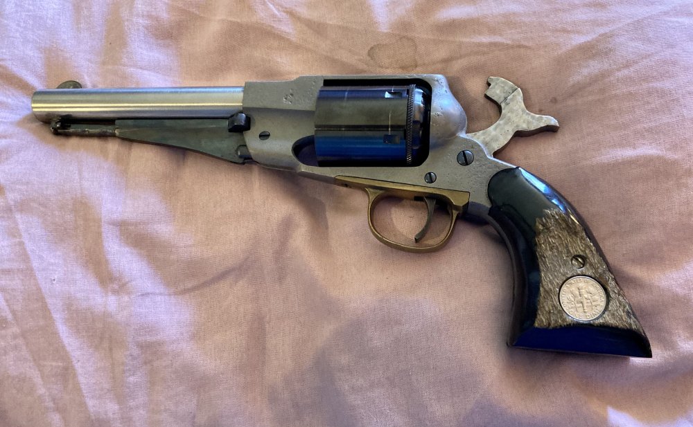

Blackwater 53393 Posted March 10 Share Posted March 10 (edited) I converted an old raggedy ‘58 to .38 years ago with the R&D cylinder. I received the gun after purchase on a blind auction site. It was NOT what was advertised and the seller refused to even respond when I called him out on it. I threw it in a drawer and forgot it for a while. A year or so later, I got the bug to fix it up and see what I could come up with. I disassembled it and put the frame into my caustic carburetor cleaner tank. This guy has used polyester body filler and painted the gun!! When I pulled it out of the dip tank, it was badly pitted but no rust was present. The internals were in pretty good shape, but the cylinder was ruined and the barrel was really rough and pitted inside and out. I ordered a conversion cylinder and found a stainless Ruger .357 barrel on Gunbroker. We, (my gunsmith and I) removed the old barrel and had the Ruger barrel rethreaded to match the ‘58 frame. While the barrel was out, we cleaned up the worst of the pitting and bead blasted the frame. The hammer was jeweled and all new screws were fire blued. We left the trigger guard petina brass and blued the trigger. When the barrel came back, my gunsmith filled the screw hole for the ejector rod housing, installed a half dime for a front sight, dovetailed the bottom of the barrel for the latch on the loading lever, and dressed the end of it with the “target recess”. A knife maker friend made a set of water buffalo grips for it and inlaid a pair of antique dimes into them. When we assembled it, the cylinder had to be timed. It turned out that it wasn’t the right one, so I sent the gun to Taylor’s and they fitted the correct one to it and sent it back, free of charge. It turned out to be a great shooter and it’s a pretty good looking little gun! Edited March 10 by Blackwater 53393 6 Quote Link to comment Share on other sites More sharing options...
