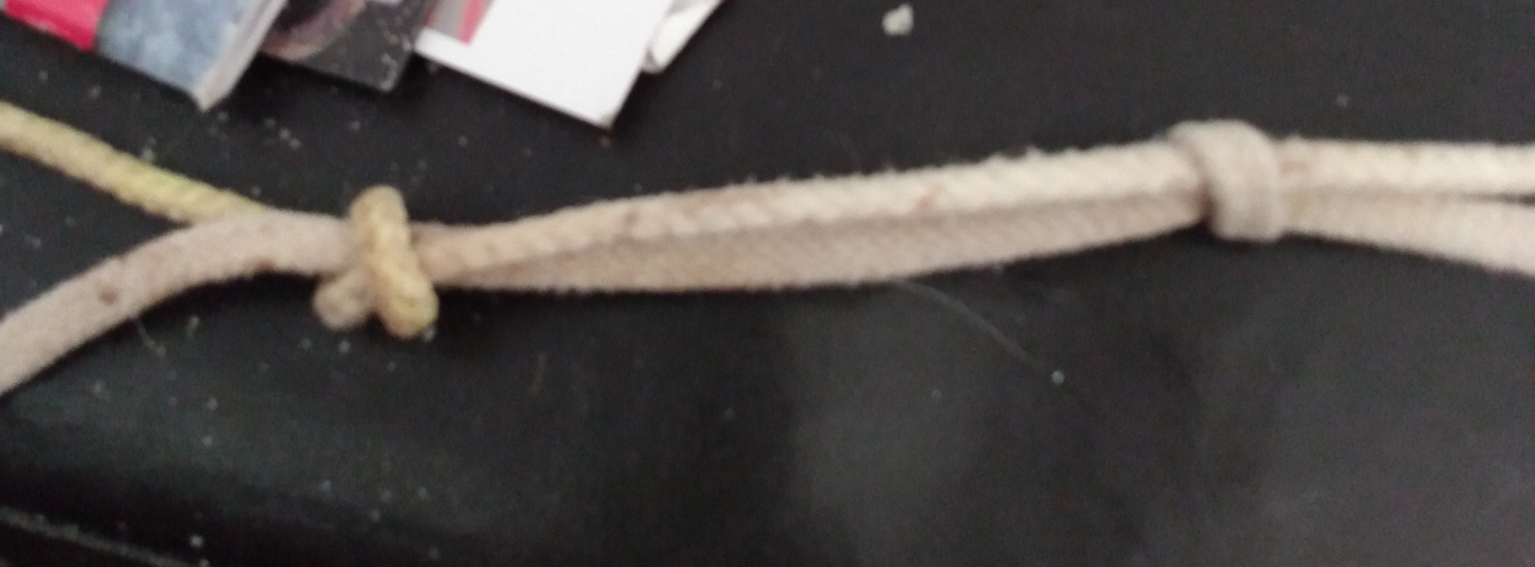

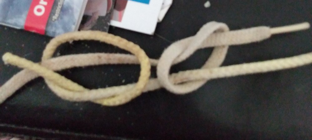

Alpo Posted November 25, 2021 Posted November 25, 2021 I agree with Pat that the square knot will come undone. Back in Boy Scouts I learned something that was called a fisherman's knot. You simply tie an overhand knot in one end, run the other end through the loop of the overhand knot, then using the second end tie an overhand knot around the standing part of the first end. You then pull the knots closed And then draw the two knots toward each other by pulling the two lines. The two knots act as jam nuts against each other, and it will not untie by itself.
sassnetguy50 Posted November 25, 2021 Posted November 25, 2021 X2 for Pat's blood knot. It is a reinforced version of Alpo's fisherman knot.
