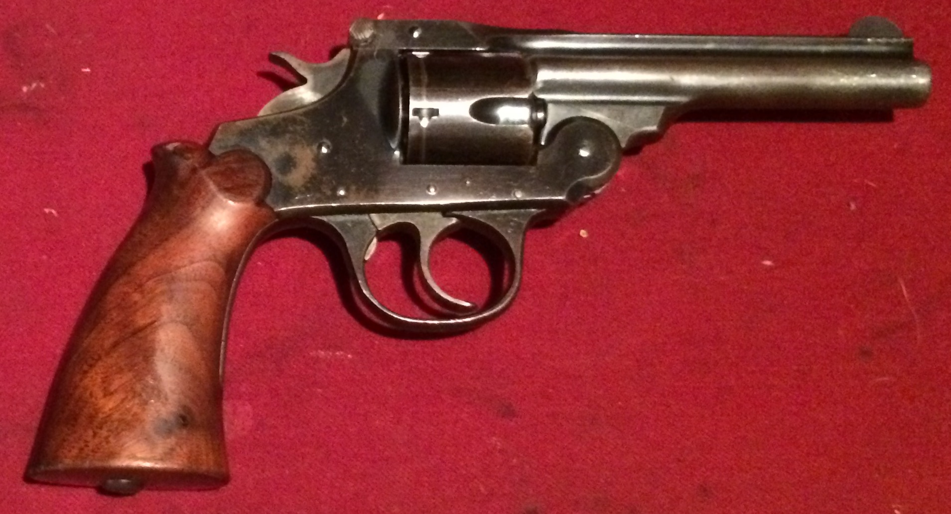

H. K. Uriah, SASS #74619 Posted April 20, 2021 Posted April 20, 2021 These are my pocket pistols. I have used them all at one point or another... The upper right is an Iver Johnson. Here's a closeup of it. When I was getting ready to go out to EoT a few year ago, I wanted to use this gun because it's "newer" than the others and safe for smokeless. (.38 S&W) I was worried about the big target grips, so I posted this pic here on the wire and and asked if it was still okay for use as a pocket pistol. I believe it was Palewolf, who said that this pistol was okay as is. Something like this can usually be found for a fairly reasonable price. (Everything else in the collection pic is a BP pistol.) If you don't like the big target grips. They can be replaced by standard ones, or just find an example of this gun itself with regular grips. I have found it to be rugged, reliable, and a fairly fast shooter when it needs to be. For precision work, if such an event exists, it has a good crisp SA trigger as well. (So does the Merwin & Hulbert) If I wanted another pocket, I'd get another one of these.

Hoss Posted April 20, 2021 Posted April 20, 2021 7 hours ago, H. K. Uriah, SASS #74619 said: These are my pocket pistols. I have used them all at one point or another... The upper right is an Iver Johnson. Here's a closeup of it. When I was getting ready to go out to EoT a few year ago, I wanted to use this gun because it's "newer" than the others and safe for smokeless. (.38 S&W) I was worried about the big target grips, so I posted this pic here on the wire and and asked if it was still okay for use as a pocket pistol. I believe it was Palewolf, who said that this pistol was okay as is. Something like this can usually be found for a fairly reasonable price. (Everything else in the collection pic is a BP pistol.) If you don't like the big target grips. They can be replaced by standard ones, or just find an example of this gun itself with regular grips. I have found it to be rugged, reliable, and a fairly fast shooter when it needs to be. For precision work, if such an event exists, it has a good crisp SA trigger as well. (So does the Merwin & Hulbert) If I wanted another pocket, I'd get another one of these. The Lightening likely has a 4 1/4” barrel, which makes it too long for PP side matches. When I bought mine I figured it was 4” but it 4 1/4. They did make some shorter, some longer but the majority are 4 1/4

Garrison Joe, SASS #60708 Posted April 21, 2021 Posted April 21, 2021 The Iver Johnson top Breaks that were made for BP only have a cylinder latching lead-in cut that is long, like the picture of the blued IJ above. Their smokeless era top breaks have the shorter cut, like the nickeled S&W in the picture from HH. Perhaps the easiest way to tell for the IJ guns. Since their model labeling scheme is rather complicated. If original gutta percha grips are on the gun (never swapped out with replacements), the owl on the top of grip is also an indicator. Owl looks at cylinder for BP era guns (1st and 2nd Models). Away from cylinder for 3rd Model. But, grips are VERY often not original on lots of the guns you will run into, since they break easily. Here's some pics from Goforth's book. Good luck, GJ
Garrison Joe, SASS #60708 Posted April 21, 2021 Posted April 21, 2021 Also note that 1st and 2nd models don't "bolt lock" the cylinder. The hand presses the cylinder so that the lock bolt sits against the flat end of the latch cut. That means the trigger has to be pulled without backing off pressure during the stroke. The 3rd Models drop the latch bolt into the transverse slot and locks the cylinder when it's aligned with the barrel. For pocket pistol side match, you may never notice this. When the early models get included in main matches and shot by pards not familiar with the gun, they may be less than enthusiastic with their trigger pull, and fail to keep cylinder rotated fully. The cylinder is "free-spinning" when the trigger is not applying pressure to the hand, too. So, pulling a 1st or 2nd model over a table top can roll the cylinder off of the position where you expect it to be. good luck, GJ
