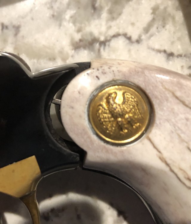

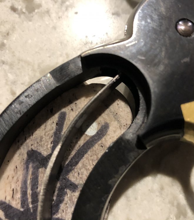

I recently got a set of stag grips for a pair of Remington NMA’s.  There is a gap at the top where the grip meets the frame (semi-circle area).  I spoke to the maker and he suggested using neutral colored epoxy to fill the gap.  I’m hoping someone has some experience with doing this and can give me a recommendation on the epoxy.

I just sent the maker an email.  I tried them on again and as you can see in the pictures the gap is bigger than I remembered.

Sorry, but that gap is way too big, send 'em back.

I’ve heard back from the grip maker, turns out those grips were made for Uberti’s and my guns are Pietta’s.  He said that I could just ship them back and he would make a new set, no hassles, no argument.  I’m happy with the outcome.
