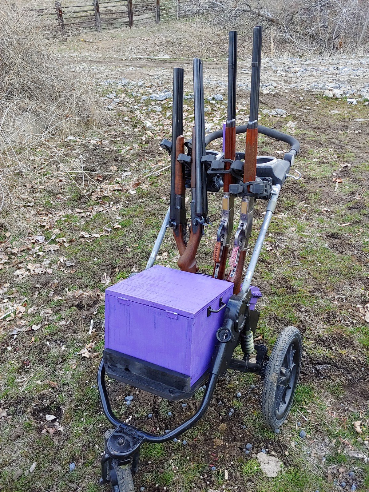

Charlie MacNeil, SASS #48580 Posted February 9, 2020 Posted February 9, 2020 My oldest granddaughter outgrew it and the youngest is too independent to ride in it so my daughter-in-law was going to throw it away. I took it home and stripped the baby stuff off of it and here it is. It's still a work in progress...

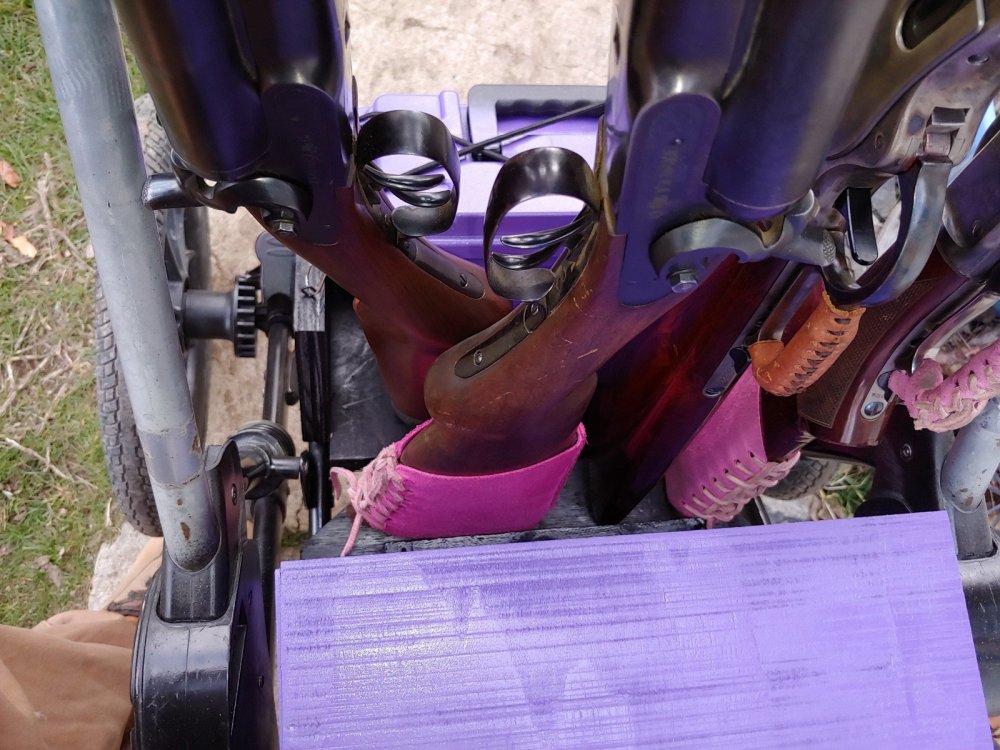

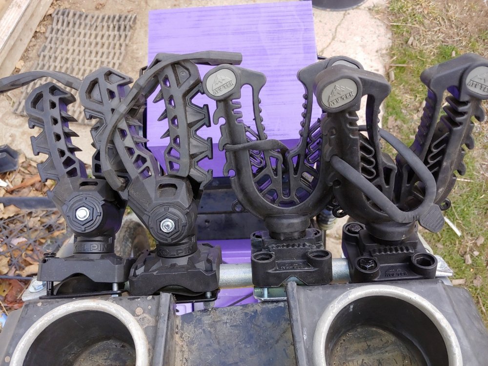

Charlie MacNeil, SASS #48580 Posted February 14, 2020 Author Posted February 14, 2020 7 hours ago, Hardpan Curmudgeon SASS #8967 said: Charlie, that looks plumb cool. Do you have more pictures of the cart that you can share? Where do the long guns butts rest? And what did you use for the "upper" clamps...? I'm too poor/cheap to pop for a Rugged Gear cart myownself, but I'm wanting one that I can strap to the Miata luggage rack! That's the only picture that I have. The guns sit between the two boxes. There's a slat behind the bigger box that keeps the box from sliding back and the guns from moving forward. I used two different types of clamps to hold the guns: two Rhino Grip XLR and two that are slightly smaller from another company. Right now it's set up for four guns because I'm headed to Winter Range next week and I want to be able to carry my backups on the cart. It's too dang far to hike back to the pickup if I need to change guns. After Winter Range I'm probably going to take two of them off because the rest of the matches that I go to are a lot closer to where the guns will be stored. Somewhere down the road I think I'm going to go to a different sort of clamp that doesn't take up as much room so I can get four guns on the cart easier. Maybe if I think about it tomorrow I'll get a few more pictures and post them up here. Maybe one with guns on the cart...

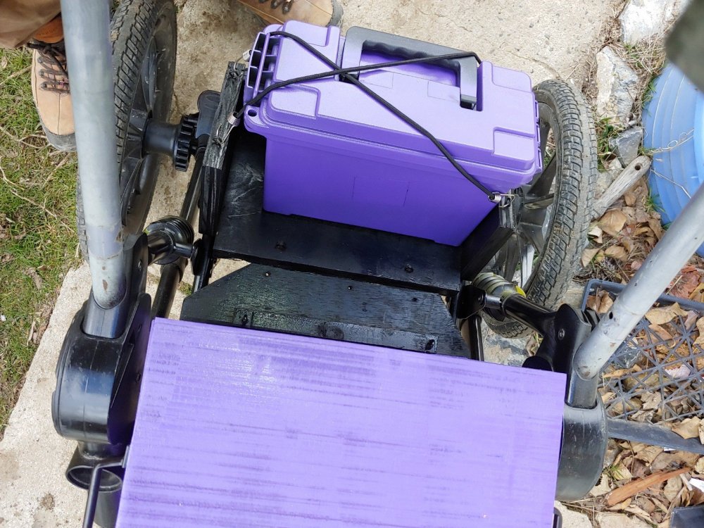

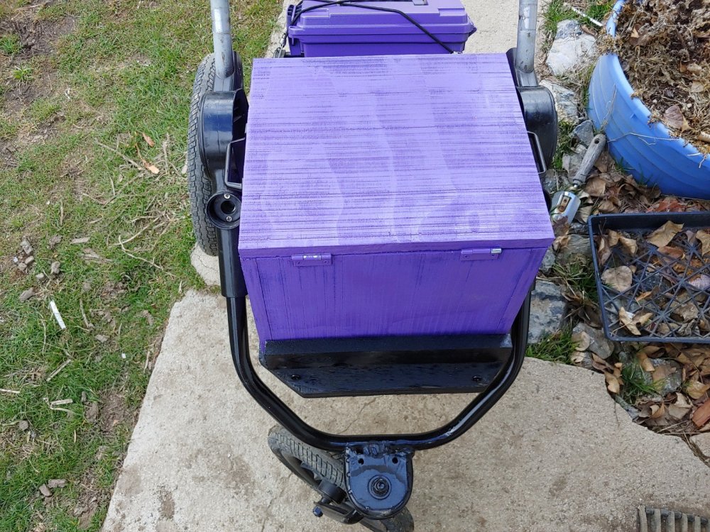

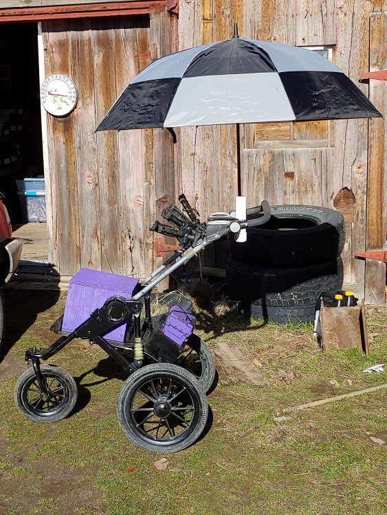

Charlie MacNeil, SASS #48580 Posted February 14, 2020 Author Posted February 14, 2020 Clamp system. I'm going to modify this some time this summer so that they take up less space. Not sure that I'm gonna do just yet. They are clamped to a piece of aluminum conduit bolted between the bars of the frame. The smaller box has my screwdriver set, extra ear plugs, snacks, spare shooting glasses, etc. in it. You can't tell it here but it's sitting in a half box that slants down toward the axle and is screwed to the frame. and to the front deck piece. My umbrella holder. PVC pipe Kind of hard to tell, but the rifles are tucked in between the front of the small box and the slat at the back of the bigger box. Shotguns are set cross-wise in opposite directions.

Cat Brules Posted February 16, 2020 Posted February 16, 2020 That stroller rig looks very nice. Do you find it is a bit too light in the front?....or does it is solid all around? I got an out-grown stroller, too, and was thinking about trying this. Yours is very nice! Cat Brules
Charlie MacNeil, SASS #48580 Posted February 16, 2020 Author Posted February 16, 2020 3 hours ago, Cat Brules said: That stroller rig looks very nice. Do you find it is a bit too light in the front?....or does it is solid all around? I got an out-grown stroller, too, and was thinking about trying this. Yours is very nice! Cat Brules Thanks! So far there's been no issues with weight distribution. I thought that there might be, especially with four guns on board. I put all four guns in it on our front walk and there was no sign of tipping. I think that might be because the forward deck and main box sit pretty close to the front wheel, the guns sit pretty much mainly over the rear axle and the rear box slants down between the rear wheels. Regarding the front wheel: originally the front wheel was set quite a bit further forward, I cut the front wheel frame rails loose and cut them off at the back of the wheel mount then welded the wheel mount directly to the main frame. This shortened the frame length by about 4 inches and made the whole thing more compact. All three tires were flat when I got it, so I Slimed them all and pumped them up. That was a month ago and they're still holding air so I guess that I got them sealed up. Something to remember if your base stroller has inflated/inflatable tires.
