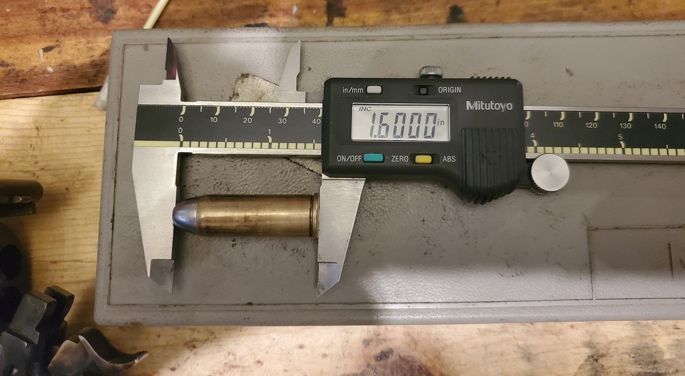

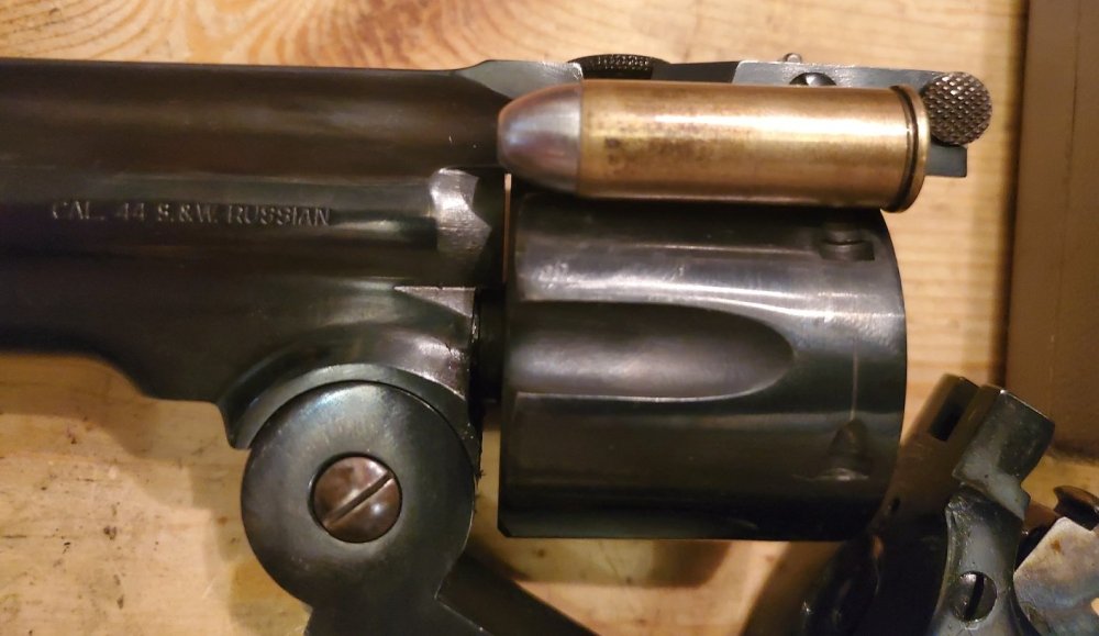

Three Foot Johnson Posted October 3, 2021 Posted October 3, 2021 Apparently, they stretched the frame slightly, and made a longer cylinder for the .45 Colt version, because the .45 Colt is too long for my .44 Russians.
Abilene, SASS # 27489 Posted October 4, 2021 Posted October 4, 2021 1 hour ago, Three Foot Johnson said: Apparently, they stretched the frame slightly, and made a longer cylinder for the .45 Colt version, because the .45 Colt is too long for my .44 Russians. Those are Ubertis? How old? Very interesting.
Three Foot Johnson Posted October 4, 2021 Posted October 4, 2021 17 minutes ago, Abilene, SASS # 27489 said: Those are Ubertis? How old? Very interesting. Uberti's, yes. The s/n range is 65xx, 68xx, and 76xx - 76xx was made in 2001. The other two are in a different building, and I'm not walking over there just now.

Colorado Coffinmaker Posted October 4, 2021 Posted October 4, 2021 OK. First answer, A replicant (Uberti) Schofield has enough cylinder to ream to 44 Special. No Problem. Three Foot, No. Uberti didn't stretch the Frame for 45 Colt. They simply eliminated the forcing cone area of the Barrel Breach, eliminated all but a nub of the Gas Ring/Bushing and lengthened the cylinder to "just" accept 45 Colt. Thereby ruining the gun for Black Powder. Replicant Schofield guns DO NOT play well with BP. The short cylinder is what generated the shorter "45 Schofield" cartridge, which begat the "45 Government" cartridge to give the Army the ability to shoot same/same ammunition in Schofield and Colt revolvers.
