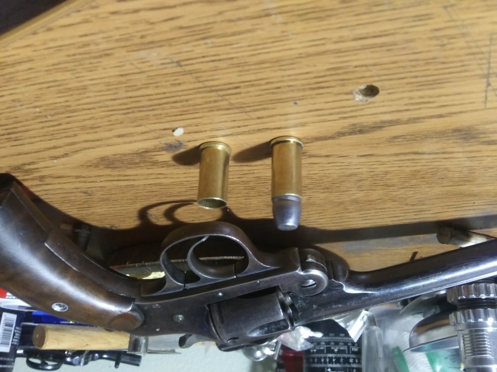

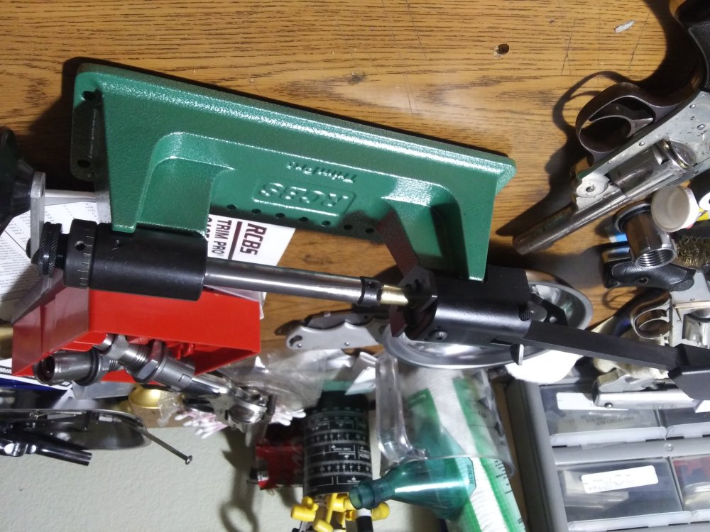

Fallon Kid Posted September 26, 2021 Posted September 26, 2021 Just some info in these hard times. I picked up (5) S&W 38 cal pocket guns recently. As we all know anything ammo related is scarce, expensive or not to be found. I need 38 S&W brass and found .357 brass will fit most of the 38 S&W brass criteria if cut down. I don’t shoot .357 but have several hundred rounds I have picked up as result of Cowboy shooting (I use 38 special) and gets easily mixed in with my pick-ups. First thing needed is to cut .357 brass near SAMI specs (.775) I found cutting at 1/32sec or a tad more leaves room for good trimming. Don’t try to cut exact. The brass will never cut straight without some high end equipment. I bought a Harbor 6” cut off saw. Make sure to use metal cut off blades and NO type of steel blade. The attached PIC (1) displays a proto type jig to hold brass at proper length. Insert brass in back hole ensure fully seated. I’m sure anyone can improve on this idea. The rest is basic case preparation. Trim to size. And may vary from SAMI. I measured commercial loaded ammo and case was .677 so use your best reloading knowledge. I am starting with .780 as my guns don’t really care and I got a fudge factor. I am not recommending you do this but just letting you know what I’m doing in a crunch. I am planning to use black powder and will fire form brass in a 38 police special (38 S&W of course) It has a strong action. My top breaks are older than me and that’s old. Also no liberals were harmed during any case preparation sequence Please excuse pic aspects. For some reason I correct and they still post askew.

Fallon Kid Posted September 28, 2021 Author Posted September 28, 2021 The saga continues. Sun I cut down the .357 cases(50) and first off a Harbor cut off is not precision. So leave room to trim to spec. Also I final trimmed cases to .773 or very near. (trimmer does job but not to thousands perfect) I noticed on thing that the .357 cases I have are thinner at mouth case than at new mouth when cut down. The sample cases varied a few .001 but were all thicker at the new cut down mouth. I took note. Mon I had emergency so did not work on this project. Went to mail box and had package. "Please God don't let it be the packages of springs I ordered" It was! So spent day working on one of the 4 top break pocket guns I bought a week ago. Got it up and running. So back to 38S&W. I had cast some .360 RN and made a dummy load. Tried it in a Hopkins and Allen police and case not fit due to expansion of thicker case and the stated diameter for a S&W38. So I slugged the Hopkins and Allen and it was .355, And the rifling overall is best described as not overly pronounced. I resized bullets to .357 and made a dummy round. It measures out to a S&W38 cartridge except for rim thickness. This could be issue in other guns but all my prospective shooters work fine. Plan to load and test at range today. I am debating about using Black MZ 2ff or Schuetzen 3fff. Bullet is lead 10bhn and 125gn. Lube is my homebrew. (again sorry for pic. I'm trying to fix but them pocket guns keep calling me out) LOL
