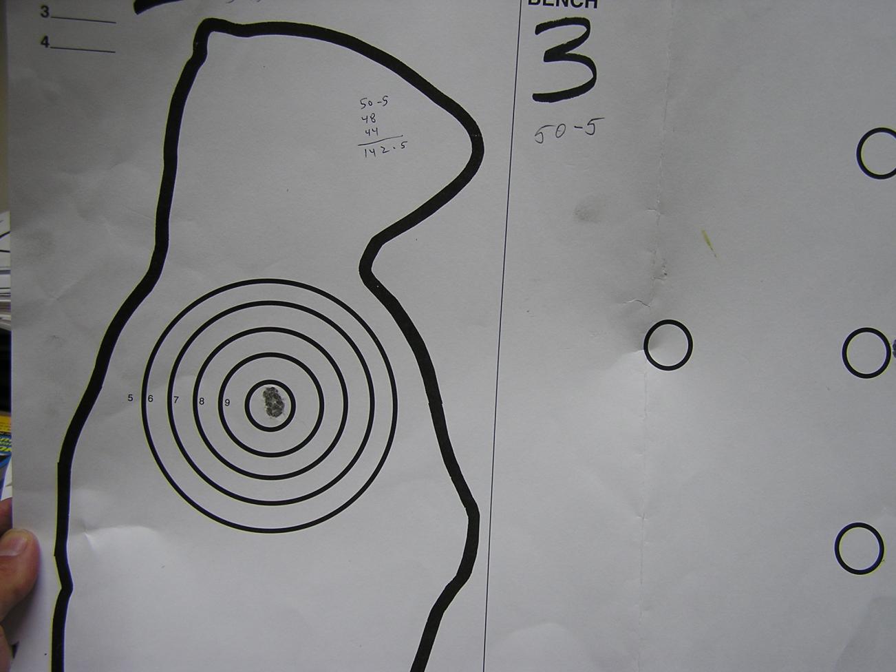

Red Cent Posted July 22, 2017 Author Posted July 22, 2017 Jim, I have seen your targets punched with the 6BR. See below: If I get the sweet spot with a load, what can I expect from the "85?
Geronimo Jim SASS # 21775 Posted July 22, 2017 Posted July 22, 2017 I can't believe you found that target! Both guns would shoot about 1 1/2 inch at 100. The weak link was the shooter and bought bullets. Really need to cast your own to do good. Also, shooting smokeless powder.
