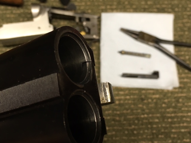

Levi Astorbilt Posted May 21, 2017 Posted May 21, 2017 I purchased a new Stoeger Coach Gun Supreme exclusively for the single trigger. When the gun arrived, I cut the locking lever rod to disable the auto safety engagement. I elected to leave everything else alone to let the gun break in with use. FWIW, I had ZERO issues with my previous Stoeger which had been modified with both lighter hammer and locking lever springs.I believed I would get the same enjoyment out of another Stoeger. After a few matches with the new Stoeger, I began experiencing misfires with the second shot (left barrel). Investigation led to the conclusion that the gun was breaking open slightly and the primer strike on the second barrel was off center. To remedy the "opening when fired" problem I dismantled and inspected. I was hoping to find a broken locking lever spring but the factory spring is unmolested and strong. I noticed the reciprocating locking lug in the receiver that engages the lugs on the barrel had a burr preventing full engagement. Knowing that this beveled lug is designed to wear in and is not supposed to FULLY engage I only removed the burr and polished the face for a little smoother mating and lessen the odds of a new burr being created. Well, seems I made the issue worse. Instead of opening once or twice during a match, it opens every single shot now. Should I buy some spring stock from Brownells and increase lever spring tension or rough up the lugs to make some drag? What could be the cause of this issue? Those "in the know", please chime in. Advice is much appreciated, Thanks!

Larsen E. Pettifogger, SASS #32933 Posted May 21, 2017 Posted May 21, 2017 Before you remove any material from the area shown in your bottom two photos do a little check. Put in the barrels and then look at the latch surface in your photos. In most unmodified Stoegers that area is not in contact with the top lever. Very easy to tell just look at the latch and start pushing the top lever to the right. Chances are the lever is not contacting the latch until the lever has been moved to the right a bit. If that is the case removing more material from the latch will not increase travel since it is already in as far as it can go. Before grinding anything else put some blacking on with a Sharpie or Prussian Blue on the barrel lug and the locking latch surfaces and move the latch back and forth a few times so you can see what is contacting where.
Levi Astorbilt Posted May 21, 2017 Author Posted May 21, 2017 Larson, You are correct I used ink to cover the wear surfaces and re assembled.So it seems there is a gap between the latch and lever when the latch rests on the lug. I need to first taper the latch so it can travel further forward along the lug.....The front lug has never made contact with the latch.
Larsen E. Pettifogger, SASS #32933 Posted May 21, 2017 Posted May 21, 2017 The front lug never makes contact on a stock Stoeger. Here is a photo of the stock setup. The plate is a machined plate that is the thickness of the water table on the Stoeger receiver. You can see that the front lug makes no contact.
Larsen E. Pettifogger, SASS #32933 Posted May 21, 2017 Posted May 21, 2017 I'm sure you have already checked but is the locking latch warped? If you remove the barrels and top lever does it move freely in and out of the frame? A lot of these have a significant upward or downward bow. The 51KB limit sure plays heck with trying to post detailed photos but see if this one shows some detail. On this latch it is not bowed but the bottom was nowhere near flat and it would bind in the receiver slots. Put your latch on a known FLAT surface and check it for bows. Then turn it over and check the top. This one is from a brand new out-of-the-box gun.
Levi Astorbilt Posted May 21, 2017 Author Posted May 21, 2017 Found not much contact. Slowly fitted the latch to the lug until the latch contacted the face of the lever.
Levi Astorbilt Posted May 21, 2017 Author Posted May 21, 2017 SUCCESS!!! Test fired and all is good. I previously had some play in the opening lever. Not anymore, Thanks Larson for the advice!
