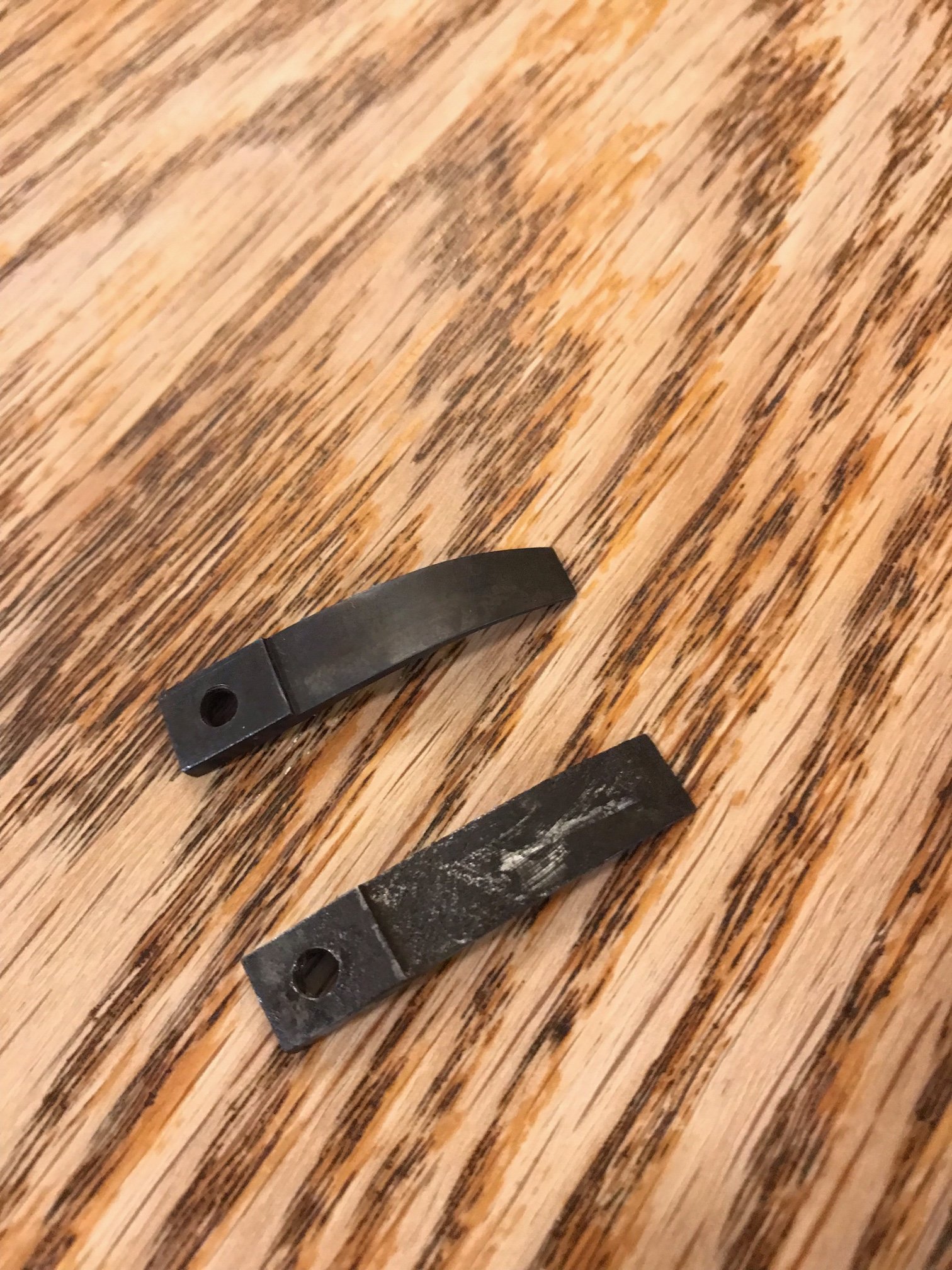

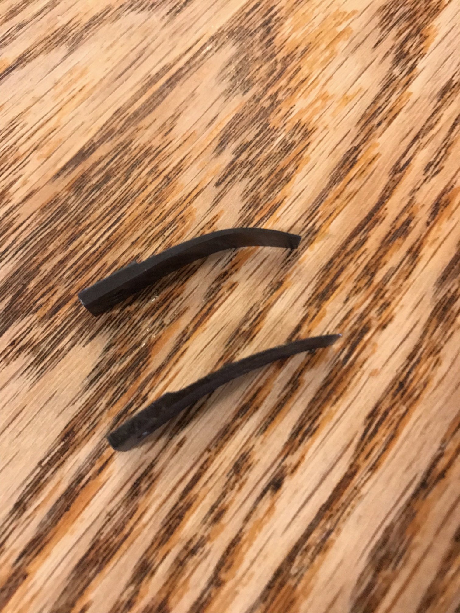

Larsen Pettifogger once again was spot on with this issue.  After replacing the old trigger spring with a new(ish) one from ebay the gun works without any issue now.  On top is the new one.
Yep, that new one is quite a bit thicker and shorter, and it has more bend built in to "pre-load" the trigger before any spring flex even occurs, so it provides a LOT more pressure on the trigger to hold it into engagement with the sear/hammer notch.
