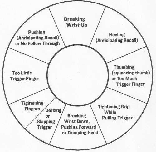

watab kid Posted March 22, 2023 Posted March 22, 2023 there is a chart that shows you what your finger is doing when you pull the trigger - im not the guy to teach or advise [i shoot badly] but it might help with your question , i dont have it to post but most ranges have it available , i think your putting too muvch finger into your trigger pull but again i dont have it available , that is assumine your sights are right
PaleWolf Brunelle, #2495L Posted March 22, 2023 Posted March 22, 2023 31 minutes ago, watab kid said: there is a chart that shows you what your finger is doing when you pull the trigger - im not the guy to teach or advise [i shoot badly] but it might help with your question , i dont have it to post but most ranges have it available , i think your putting too muvch finger into your trigger pull but again i dont have it available , that is assumine your sights are right Found these in my "Gun Pix" files:
Mysterious Stranger Posted March 22, 2023 Author Posted March 22, 2023 6 hours ago, PaleWolf Brunelle, #2495L said: Found these in my "Gun Pix" files: I actually got a laser boresighter and used it to check the sights on both revolvers. The laser confirmed that one of the revolvers shoots 2" left of POA and the other revolver shoots to 4" left of POA. The fact that the 2 have DIFFERENT windage errors is particularly a problem for fast paced CAS shooting. I will address this though after I have determined that I have a handload good enough to keep. Jim G

watab kid Posted March 23, 2023 Posted March 23, 2023 15 hours ago, PaleWolf Brunelle, #2495L said: Found these in my "Gun Pix" files: that first one is what i was referring to
Mysterious Stranger Posted March 23, 2023 Author Posted March 23, 2023 45 minutes ago, watab kid said: that first one is what i was referring to I get that, but i liked the 2nd one too! After I used the laser boresighter that proved the 2" and 4" leftward windage errors existed in the sights of the 2 revolvers, I went back to the targets before I threw them out, and measured the horizontal distance of each shot, in each 5--shot group, from the vertical centerline of the aimpoint. Then I added up all those distance within each group and divided by 5, to get the average distance left from the target centerline, for each 5-shot group. That analysis confirmed that the leftward offset of the groups was indeed over 2" for one revolver and about 4" for the other revolver! so, my consistent leftward windage IS due to the sights and not a shooter trigger or grip error. Now to reduce the average group SIZE, I need to either figure out a way to get a an easier and betetr sight picture with those sights, OR put a SureHit front sight brass "sleeve" over the sight to make it taller, wider, and more visible. I'm going to try the SureHit brass sleeve, which apparently simply slips on and glues in place. Before I GLUE it, I'll first try shooting with it just slipped on if I can do that without recoil throwing it off the handgun to disappear somewhere on the ground. Recoil on our CAS loads is mild, so maybe that would work. If not, maybe I can somehow tape it in place temporarily. Jim G
Cpt Dan Blodgett, SASS #75655 Posted March 23, 2023 Posted March 23, 2023 On 3/22/2023 at 1:18 AM, PaleWolf Brunelle, #2495L said: Found these in my "Gun Pix" files: The lower chart accurately analyses my shooting. Thanks Pale Wolf!

Mysterious Stranger Posted March 25, 2023 Author Posted March 25, 2023 5 hours ago, Cholla Hill Tirador said: My first CAS revolvers were/are a pair of Uberti Hombre's. They also shot to the left as did most of my SA revolvers. Then I figured out it was ME and not my revolvers. Yours is a very common problem with right-handed shooters and Colt SA's and their reproductions whose trigger are positioned in the left side of the trigger guard. There is one caveat and that is if when the revolvers are assembled the barrels aren't tightened quite enough. I ran into this with a Ruger Police Service Six. The front sight was visibly canted to the right, which caused POI to be left. I removed the barrel and found a nasty metal burr on the face of the frame. I removed the burr taking care to keep the frame square and reinstalled the barrel correctly. Problem solved. Sometime when you're bored go to an auction site such as GunBroker and peruse used revolvers with adjustable sights. It's eye-opening just how many have their sights adjusted right of center. I know what you say about shooting left is true for many shooters, BUT I actually bought and used a laser boresighter to check both revolvers, and the laser boresignter confirmed not only that they would both shoot left, but it actually confirmed how MUCH each actually shoots left.
