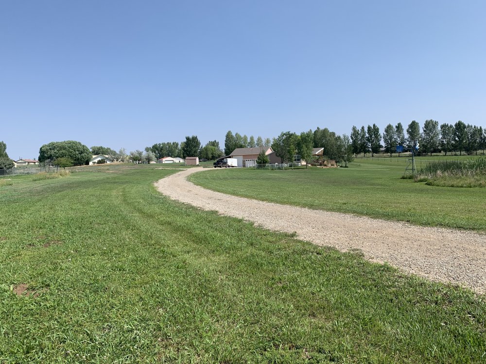

Rip Snorter Posted May 4, 2022 Posted May 4, 2022 I have a third of a mile pit run gravel driveway. I have had gravel added and the road smoothed once in 15 years. I do fill ruts gently using the snow plow on the UTV, and constantly vary the track I take with the various vehicles, particularly on wet days. Of course, here is dry high plains. I was thinking the other day that I should get some more gravel in the next year or so. Worst case for you, there is a product used to stabilize oilfield roads you could use if you have wet spots. Have used to for a patio and a walk, the name will come to me.
