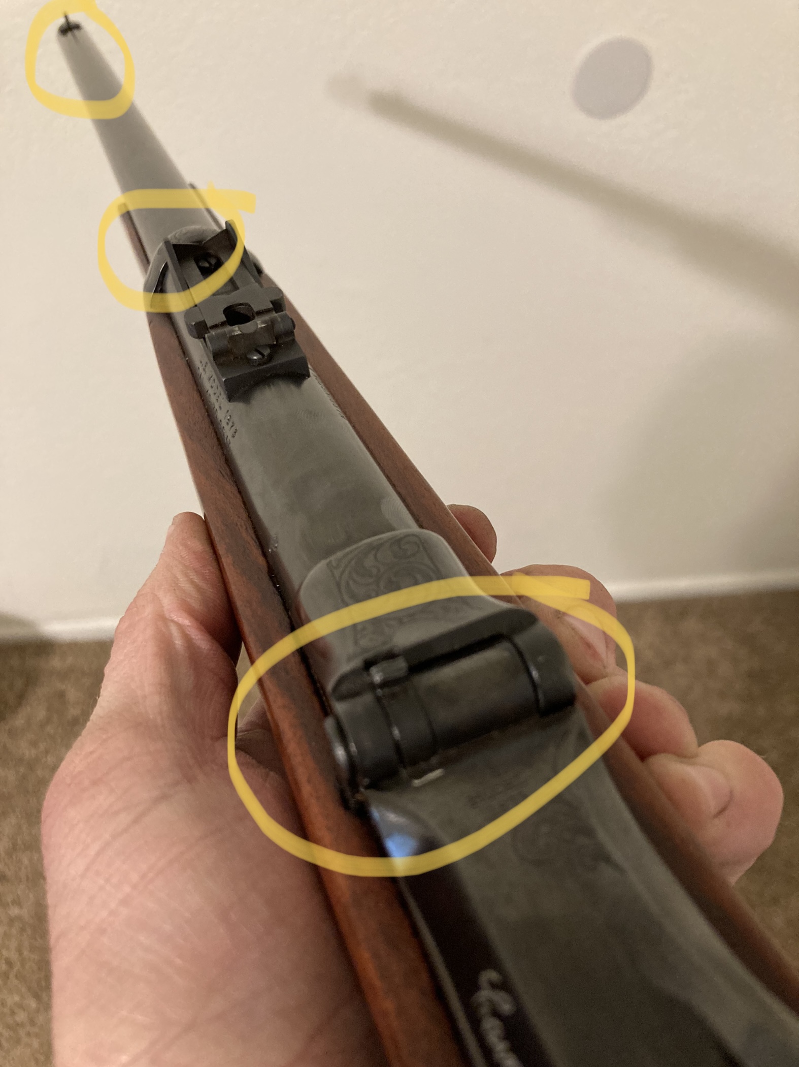

Fill Yer Hand Posted July 22, 2021 Posted July 22, 2021 I just purchased a new to me springfield trapdoor cavalry model and my question is doing research I’ve discovered the military had them sighted and set up for zero at 300 yards. That being said there still has to be some way to shoot the thing at a closer target right? In shooting it this weekend the trapdoor hinge blocks the front sight from where it probably should be at 100 yards or closer. The closest marker on the ladder sight it 400. Any thought how to shoot this at a closer distance
Fill Yer Hand Posted July 22, 2021 Author Posted July 22, 2021 I feel like either the front sight should be taller or shim the back sight up some

Kid Rich Posted July 22, 2021 Posted July 22, 2021 That ridge directly in front of the hinge on the trap can be grooved which will help your problem. On the originals it has a groove in it. kR

Trailrider #896 Posted July 22, 2021 Posted July 22, 2021 Original U.S. Army rifles and carbines generally shoot about 12-18" high at 100 yds. If the front sight blade is held in with a pin, change out the blade for a higher one made of brass. If not, you might consider silver-soldering an extension to the top of the existing blade. If you are shooting at paper targets, just place a second target under the main one, and aim at the lower edge of the bottom target.
irish ike, SASS #43615 Posted July 22, 2021 Posted July 22, 2021 You can buy a tall blade front sight. Then file it down to reach your target goal. Do not go grinding on the gun. I have a 50-45 rolling block carbine with the same problem. Sight was set for 200 plus yards. I bought a replacement tall blade and filed to fit 50 yards for plainsman.

Kid Rich Posted July 23, 2021 Posted July 23, 2021 A striker plate for a door latch is the right thickness and easy to install. Make it whatever height you want. My original front site is in my gun safe. If you have a Buffington rear sight the adjustment for the reading is about 75 yds difference. kR
Fill Yer Hand Posted July 23, 2021 Author Posted July 23, 2021 I got it kind of figured out. When the front sight disappears behind the hinge is right on at 100 yards. Now how to get to 200 is the next step
