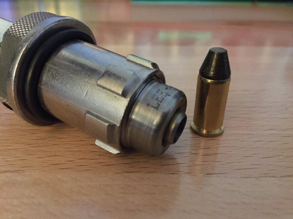

Long Fingers, SASS#56813 Posted February 4, 2021 Author Posted February 4, 2021 This is the die that came in the set, 38s&w-D6. Picture shows the expander outside of the die. Either the inside shoulder of the die is cut to deep or the nose of the expander is to long. Guess I’ll call it a bad die, I will try to contact lee and see what they have to say. Had an extra 9mm die, gives me just enough bell on the case and still operates the powder drop. Thanks for everyone’s help, LF

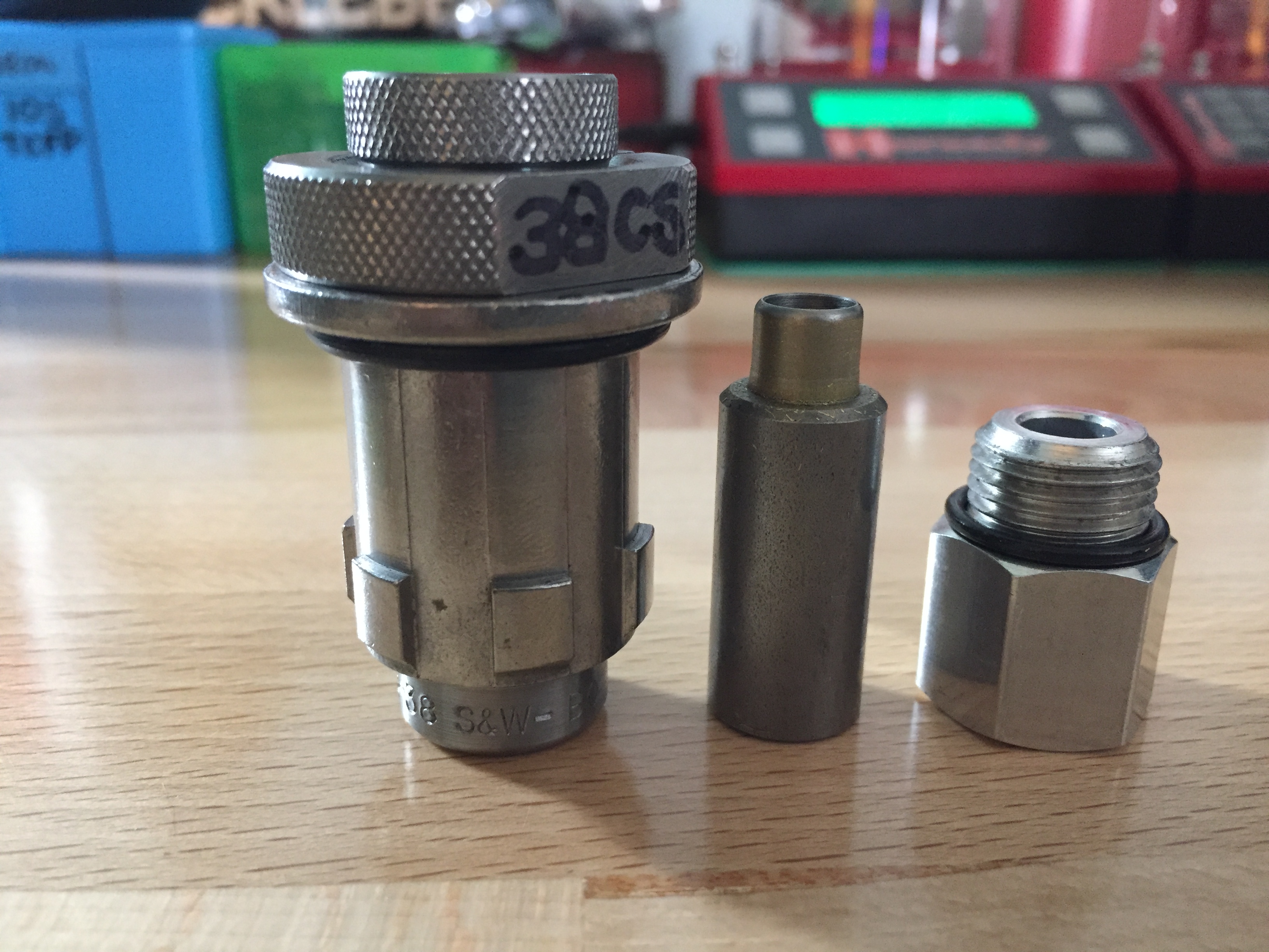

Bingo Montana Posted February 4, 2021 Posted February 4, 2021 8 minutes ago, Long Fingers, SASS#56813 said: Mine moves freely also until you attach the powder drop. That’s the problem, the expander is now under tension sticking out the bottom. The case engages the expander before it enters the die. If not lined up perfectly it will crush the edge of the case. Here is a picture of the die components. Is it possible one is not correct for the die set? Also, with the die body being aluminum is there some defect in the die body not allowing the powder through expander plug to move freely up into the die body? With the die set up, powder adaptor, the expander plug move up into the die body about a 1/4" before it hits the powder adapter. If the die and clean and the expander plug is under tension, as others have suggested the die is most likely defective. Lee should replace it without any trouble.
Long Fingers, SASS#56813 Posted February 4, 2021 Author Posted February 4, 2021 Just spoke with a tech at lee, that design is correct. The expander will stick out the bottom. He also said they are aware of the issue I’m having with crushed cases. He said because of the short case it had to be designed that way and just take my time lining up the case. So I asked why my 380 dies, 9mm had a different design. 9mm is almost identical in length. Didn’t have an answer for the question. 9mm die is working for me, so that solves my problem for now. LF. yes my die has the same pieces you have in the above picture. It will float with the aluminum plug, but under tension with the powder drop. All Lee components.
