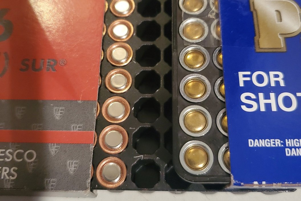

Three Foot Johnson Posted May 29, 2020 Posted May 29, 2020 I have one CAS shotgun (out of 33) that is primer specific - a single trigger Tedna coach gun. The firing pins seem to be a tiny bit slow retracting, and if I use a "domed" primer, it often hangs up when opening. I switched to Fiocchi 616's, which is flatter, and no more problem.
Eyesa Horg Posted May 29, 2020 Posted May 29, 2020 I've used the Fed. 209a's without issue. Being a tad hotter I've saved them for BP loads-needed or not! I now use Cheddite due to the low cost, however they do measure a hair larger so I don't know if there will be an issue if I go back to Win. or Federal. I'm thinking it shouldn't be as some of my old hulls seem a bit loose when seating the primer and they have never caused an issue. I'm currently using STS hulls after my new style AA's got bulges in them. I was able to get about 1K of the old style AA's and will try them after my STS's are gone.
Sedalia Dave Posted May 29, 2020 Posted May 29, 2020 Cheddite primes are ever so slightly larger than Federal, Remington, or Winchester primers and will stretch out primer pockets so that they no longer properly hold Federal, Remington, or Winchester primers.
