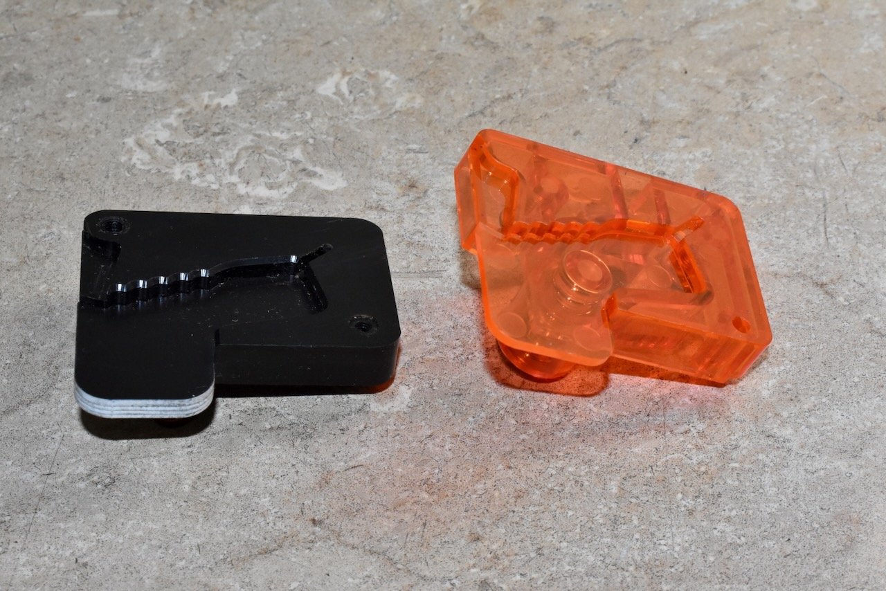

Larsen E. Pettifogger, SASS #32933 Posted June 10, 2024 Posted June 10, 2024 Here are the two bullet nose guides that are available. The one on the left is the original style that came with my machines. They use shims to set the bullet length adjustment. I had to buy additional shims as the stock guide did not have enough shims for short bullets. On the right is the new style guide. It was an accessory when I bought them, maybe they come with the newer machines. The height adjustment is screw adjustable. This makes making fine adjustments easier. I just bought a Frankfort Arsenal X-10 and their bullet feeder. Same issues. At least their manual tells you the feeder will not work with all bullets. I have some bullets that feed well. Other styles won't feed at all and jam the feeder. The Frankfort manual also lists minimum and maximum bullet lengths that will work with their feeder. Double Alpha does not tell you these things. You have to find them out for youself through trial and error. You may have to try a few different bullet nose profiles.

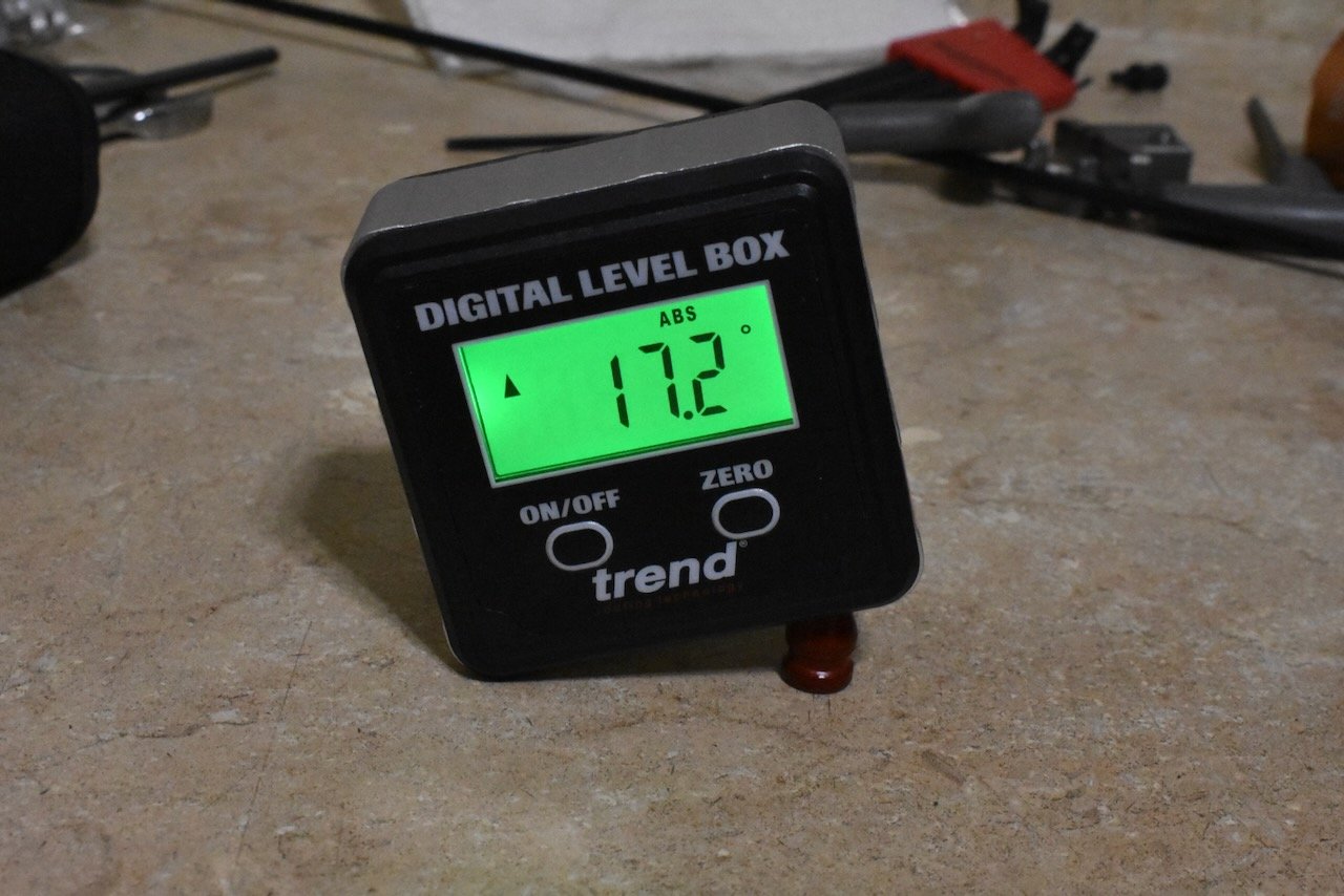

Larsen E. Pettifogger, SASS #32933 Posted June 10, 2024 Posted June 10, 2024 9 minutes ago, Slick McClade said: They are VERY aggravating to set up but once you do, they work pretty good These are not plug and play. Another thing that is very useful is a digital level. You can get these pretty cheap off the Internet and they are very useful when setting the angle of the feeder. A swag may not be good enough.
